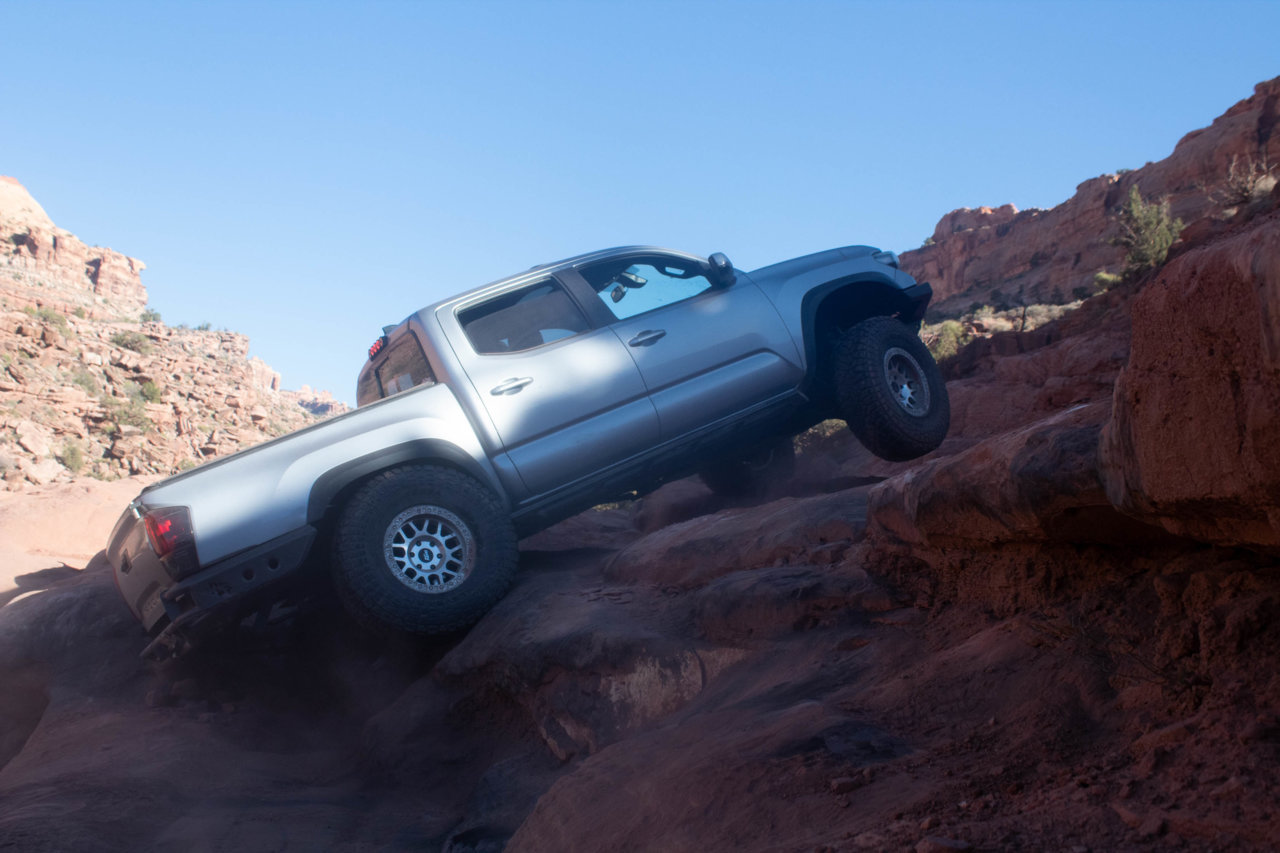

    Been running a eaton in the front for about a year and a half with 35s/37s, zero issues with it and still havent been able to break anything due to it. I've seen more guys break cvs from wheel hopping/spinning with an open front than a locked front. Nice to not worry about air lines/compressor stuff too.
