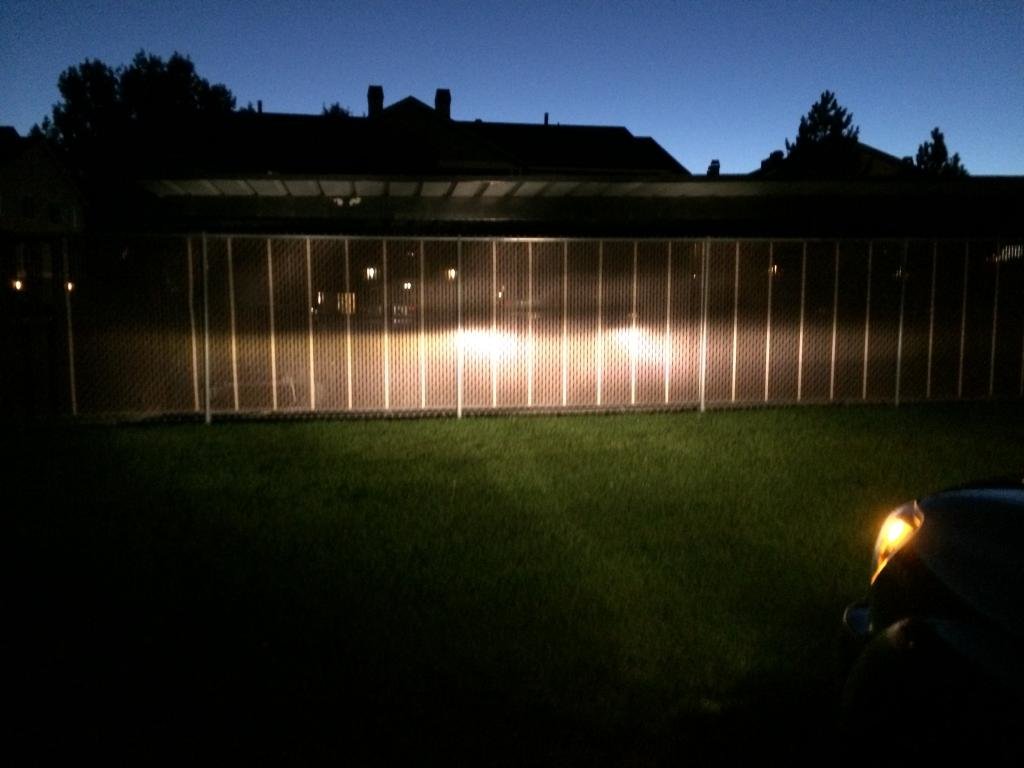

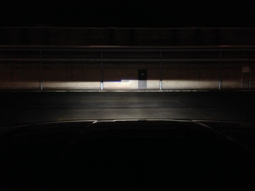

    Well here's the pics! As you can see the pattern is of course worse then stock. There is a little refraction above the "cutoff" line, but its not so bad that it's going to bother other drivers.

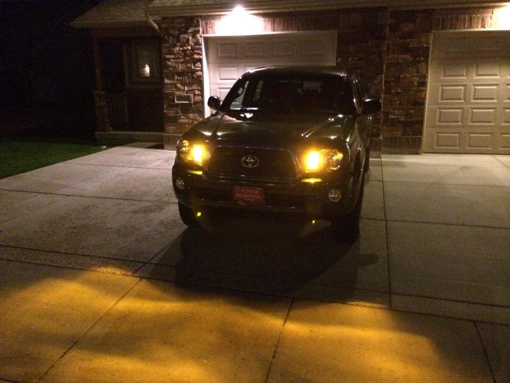

    The other pic is the 6 led V3 Triton's with a completely blacked out reflector bowl. Plenty bright! Should be no problem seeing them during the day either.

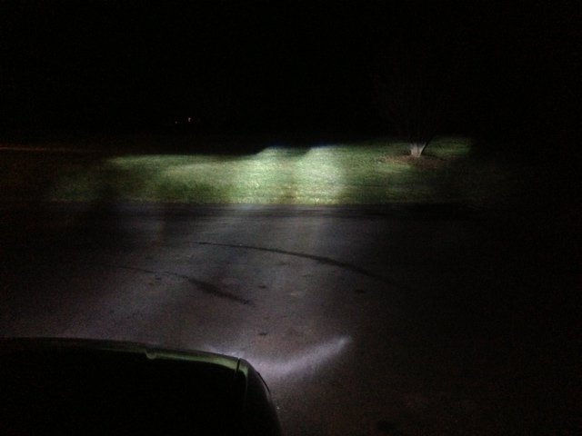

    With the Ebay lights, most of them use the same halogen projector across the different car models. You never know if you're going to get a nicely tuned one or a crap one and you never know if they are going to be at the correct horizontal rotation.
    This is a set I installed in my friends impala. Notice how each individual projection of light is rather narrow (halogen projector) and also notice the passenger one is not at the correct rotation.
    Always go real retrofit if you can, you won't be upset at all
