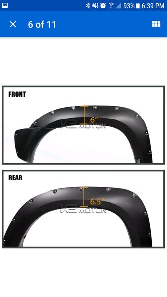

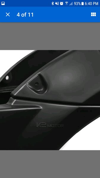

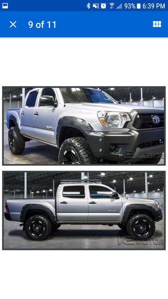

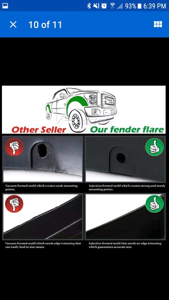

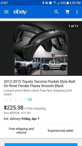

    Ok, I know in life the general rule in vehivle modifications is " you get what you pay for". I know that Bushwacker flares are the pinnacle but cost just south of $500.
    Has anyone had any experience with replica/knockoff flares such as these eBay ones?
    http://www.ebay.com/itm/122418402826
    Screenshot_20170331-183909.jpg Screenshot_20170331-183938.jpg Screenshot_20170331-183952.jpg Screenshot_20170331-184005.jpg Screenshot_20170331-183944.jpg

    Just so you know, if these are anything like the Bushwacker pocket flares, the bolts are just for show. They are only held on by a few of the factory screws on the bottom edge. So if you cut out the bottom for clearance, there is nothing holding these onto the truck. You will then have to try and match up the bolt holes in the flare to the square holes in your fender or drill new ones and get longer bolts. Probably will also need some kind of spacer. Most of the holes in the Bushwacker version did not line up with the square holes for the factory fender flare clips.
