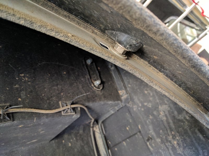

    I think that was the old ones I was using, the ones on McMaster come in a limited length, those are the ones I used. 1" IIRC.
    Before I had the 1" black oxide finish ones I had bolts with some extra length to attach a liner on the inside of the well to protect the intake. McMaster doesn't sell bolts with the desired specs longer than 1" in black oxide SS

    They were long enough for me. Had enough thread for: Bolt - black washer - fender flare - washer - nut (used as a spacer, and keeps the bolt attached to the flare) - nylon washer - OE fender - washer - lock nut.

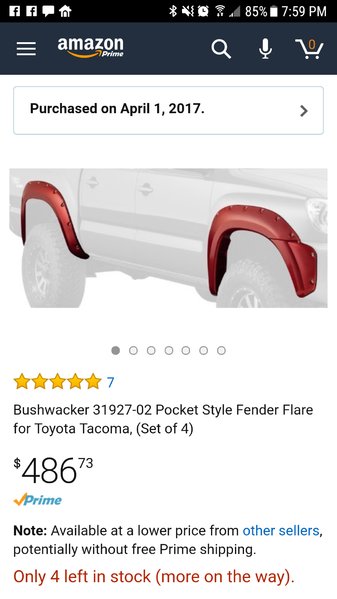

    Hi, no offense taken. My main reason for getting the flares was looks. It's as simple as that. I also hope that they are a but wider than the stock flares to cover up a bit more of my 285/70/17 Duratracs, but if they don't i will not be too disapounted.
    The reason I went with the actual $500 Bushwacker vs eBay fakes is from my experience with aftermarket BMW market. I once paid $249 for a normally $600 bumper and the for was terrible. Body shop had to do lots of work to get it to fit right and I am very particular with attention to detail.
    I want perfection but on a budget. And often times I had to buck up and get the real deal in the end, spending more $ in the long run.
    So for the Taco I want to do things well the 1st time out.

    Yes, there's enough thread to make whatever you want work. I think I used 4 stainless washers, an extra nut for a spacer, and 2 Teflon washers to protect the body paint. And a nylock 1/2 nut to tighten everything up
