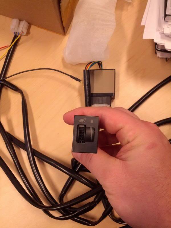

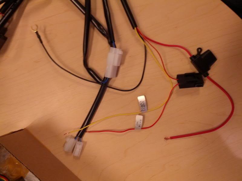

    The wiring consists of 4 leads coming out of the on/off switch:
    1) ground
    2) 'Night Light' - 18 gauge or so
    3) 'On Wire' - 18 gauge or so (5 amp inline fuse)
    4) power - 10 gauge or so (10 amp inline fuse)
    Does anyone know if the dimmer works or is there just one brightness on the switches?
    On my 2012 Tacoma switches will go by the USB connector under the A/C controls. I'm going to try and splice in the 'on wire' and 'night light' to something behind the A/C. Any advice on how to get this done or alternative suggestions? If you were wiring this up what would you tie each of the 4 leads to?
    Does the 10-ish gauge power wire need to go to the battery or should I splice in elsewhere? I have a fusebox under the hood I can use for power. Do I need to do separate wiring for each seat heater?
    Other comments/suggestions from people who have these heaters?

    I have those exact seat heaters. I used 2 mini add-a-fuse, 1 for each side. They were both auxiliary based fuses, so no burning the battery without the key inserted. Then used wires behind the hazard area for illumination. I believe it was the same wires that flyzeye uses for their dash light kit.
    Sorry I don't have more details, but I don't remember exactly as I was doing cup holder, console, and glove box led's at the same time. I didn't want to take the dash apart too many times.
