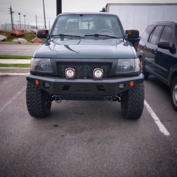

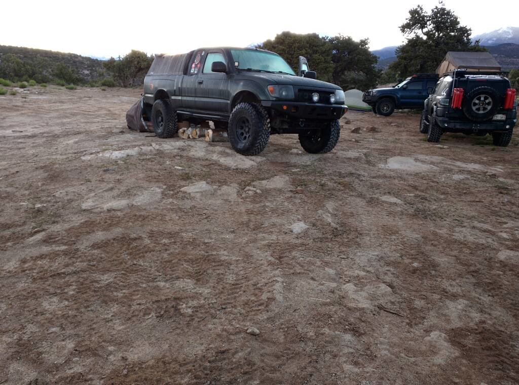

    Little better pic of the bumper... also installed the SAE certified Rigid fog lights.
    Highly recommend installing the lights while the bumper is still off the truck... WHAT A PITA... and still don't have them level... Ugh... seriously thought about unbolting it just to do this... but I couldn't do it by myself at my apartment.

    Much rub on the flex with the OME 3" and almost 33" Tires? Do you have spacers on the wheels? I like the wider look.
    The truck looks great. This is more or less the direction I am headed. 3" OME, All Pro Bumper, Sliders, Lights, etc... Just curious if I should stick with 32" instead of 33" tires while using OME kit. I have the 4 cylinder as well so added weight is a concern.
    Also, is that an OME exhaust relocation bracket on there too?
  14. Mar 24, 2016 at 6:36 PM
    #54
    ebbs15
    ebbs15 [OP] Lord Winchester
    Sep 14, 2013
    #112452
    3,451
    Brandon
    Spokane Washington
    09 Lexus GX470
    Just saw this... sorry,
    Yes, the tires rub a little in front, need to relocate the washer fluid reservoir as it rubs on that. the rear is bad on full stuff... that's why I don't have the fender flairs anymore, the screws holding them in ripped out (and chewed the SHIT out of my tires) I need to do an axle relocation (back 1/4") so it stuffs center rather than forward... and extend my bump stops (also doing the aal for the dakars)
    So I was told that 285 M/T's are slightly taller than 285 A/T's... don't know as the A/T's I took off were about 50% tred... but they didn't rub at all... so... FWIW I'm going back to A/T's the M/T's just suck ass in the ice.
    and the OME exhaust relocation bracket WAS on there, but the spring rubbed on the exhaust. so I chopped it after the axle on the down turn.

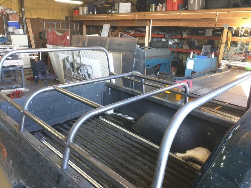

    No how to... but it's really easy... I bought the rails... grabbed some 3" bolts, taped off on my drill 1" so I wouldn't go through to far under the bed. then chose where I wanted to mount them and drilled. just like cutting, measure twice, drill once. the hard part was putting the washer nuts on the bottom of the bolts under the bed... some of the bolts were hard to get to, hence the 3'' bolts easier to find and thread a nut and washer on. (if you look under my bed or through the wheel well you'll see the 3" bolts still hanging down, I could trim them, but eh they're not hurting anything (and I'm lazy lol)
    but I use them all the time! going to be adding another set to the bed rails of the rack.
