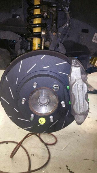

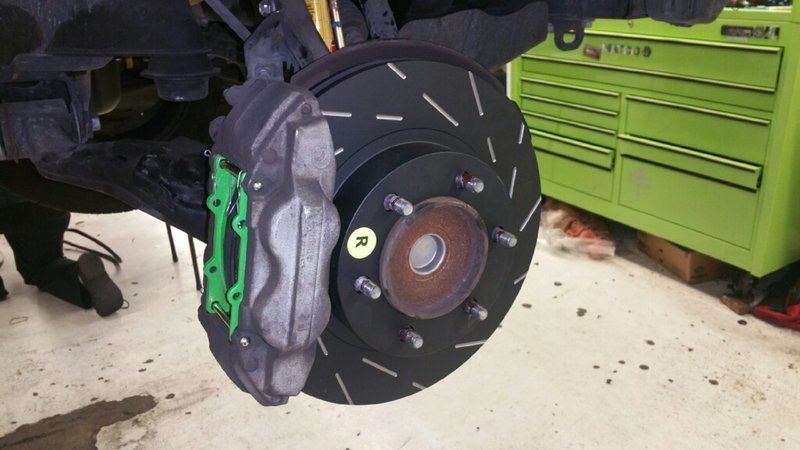

    Just installed about a month ago, after adjusting after the 500 mile break in period they feel great, wish i had gotten yellow stuff but 7000 greens are good for now. I am having a clicking from either the front or the rear, haven't really pinpointed it yet, more than likely the rear, also replaced pads and hardware for rear at the same time. If you are doing brake bleed, and you live in a humid or moist climate I would suggest sticking with dot 3 fluid, dot 4 as i understand is more for dry because it works best with no moisture from outside in the fluid. Dont do dot 5 unless you are fully flushing the system, dot3 and 4 dont mix with 5 and require flush. Now I havent dabbled with dot 5.1 but that's mainly for racing and maybe for big brake kits. Again dont quote me, I may be wrong.

    Those look great!

    Thanks, they really are a nice looking rotor, the colors really dont matter to me, though yellow is a little tighter i hear, that's why i want them, but yellows create as much or more dust as oem, which again isn't a problem for me. For op, I would also suggest going only with slotted rotors or drilled, no both. Ive seen drilled and slotted combined rotors fail on a couple vehicles. And if you want slotted and drilled really dont do much for everyday vehicles like our tacos, maybe they expel a little more water when raining, but they really dont help cool anything. And another thing is, the clicking for me could he the pads brushing past the slots and clicking because something is uneven. It should wear off over time.
