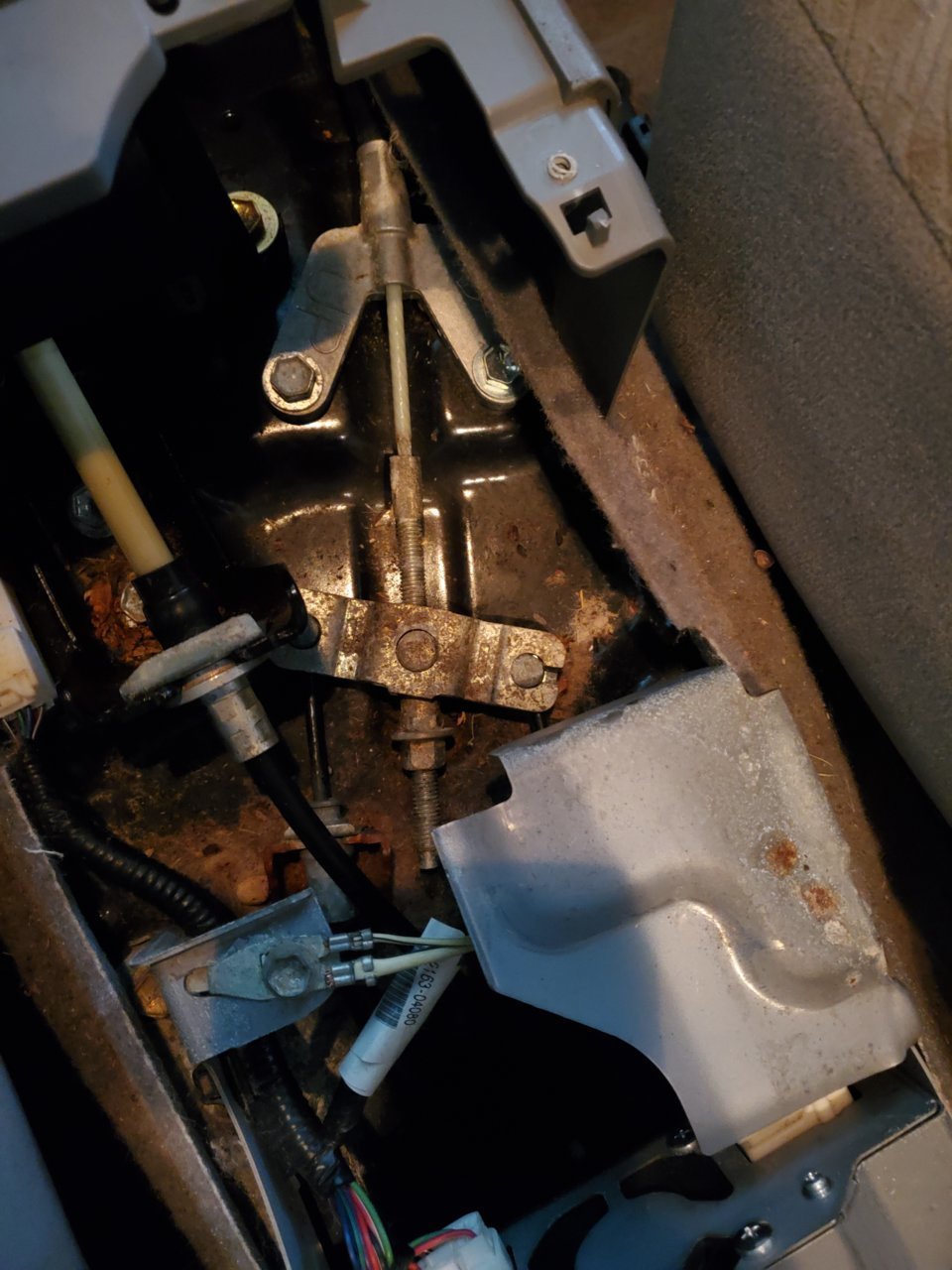

    Anyone have any diagrams or manuals or something?
    I'm still confused... The cable goes from the pedal to underneath the carpet and then i'm not sure where? For some reason it seems like its hooked to the tranny "shift linkage". Any ideas?

    Okay, from the emergency brake pedal the cable runs through the dash to underneath the console. Where there the two cables for the emergency brakes connect. There is an adjustment there.
    Everything I am relating is my experience with an '06 DCLB 4WD auto LB...
    The cables going to the brake drums, enter above the transmission and have a long boot on them where they enter the cab.
    Removing the shift knob and trim cover which pulls up you'll see where everything comes together.
    Remove the armrest, it'll make the job easier. 2 screws under the shift trim and 2 bolts under the carpet in the armrest cubby. The armrest and console snap together.... You'll see what I mean..
    You'll see the cable jackets secured with horseshoe clips.
    I'm gonna bet that the cable jackets are broken at the drum where they enter as mine were.
    If you're not familiar with drum brakes, do one side at a time as they are mirror images. it is a fairly straightforward job although tedious.
    Whereas my truck has the longest configuration, my new cables had orange bands on the drum end of the cable.
    I went the AutoZone and advance Auto parts route and their listings were both incorrect for my vehicle. One had the orange band, the other didn't. I ended up buying rebestos brand from RockAuto and they are very very close to OEM.
    It's not a hard job nor a fun job. Buy once cry once. Don't make my mistake!

    Really appreciate it! So the adjustment is underneath the shifter/center console. Makes sense!

    Found a god damn mouse nest under the shifter. They moved out already though. Bastards.
