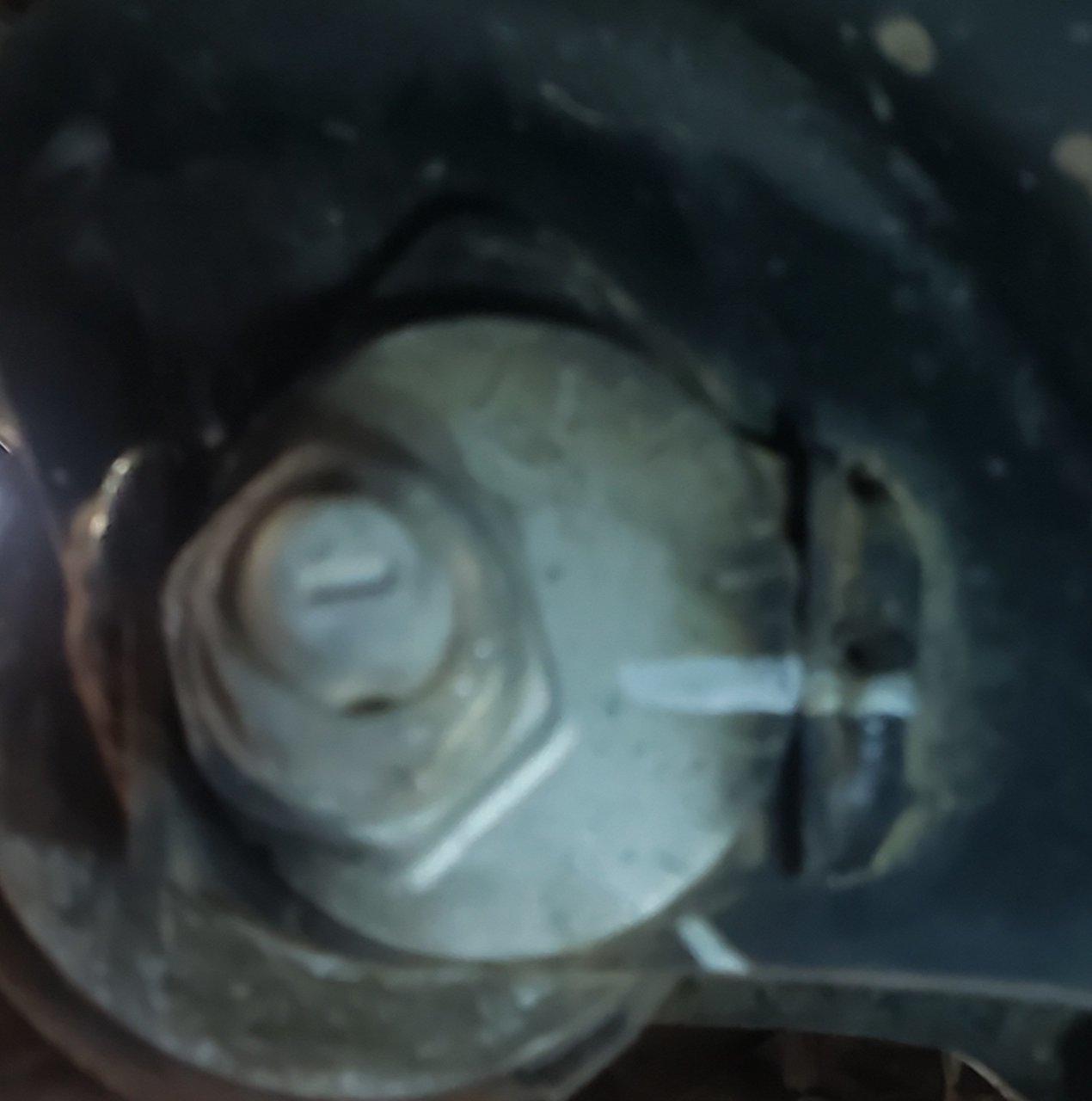

    Do anyone know anything about going about getting this repaired?

    When a shop bent one of mine I had them bend it back and put a bead of weld to hold it. They also put a weld bead on all the tabs.

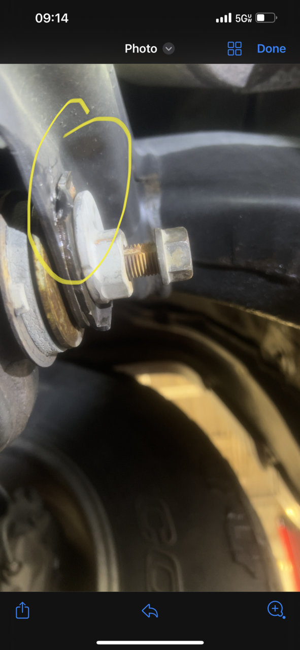

    Will this work in second gen?
    Taco grinder do you have pic

    This is what I did to mine. They are holding up well and from everything I've read on here, people have had good luck with the weld bead behind the stock tabs.
