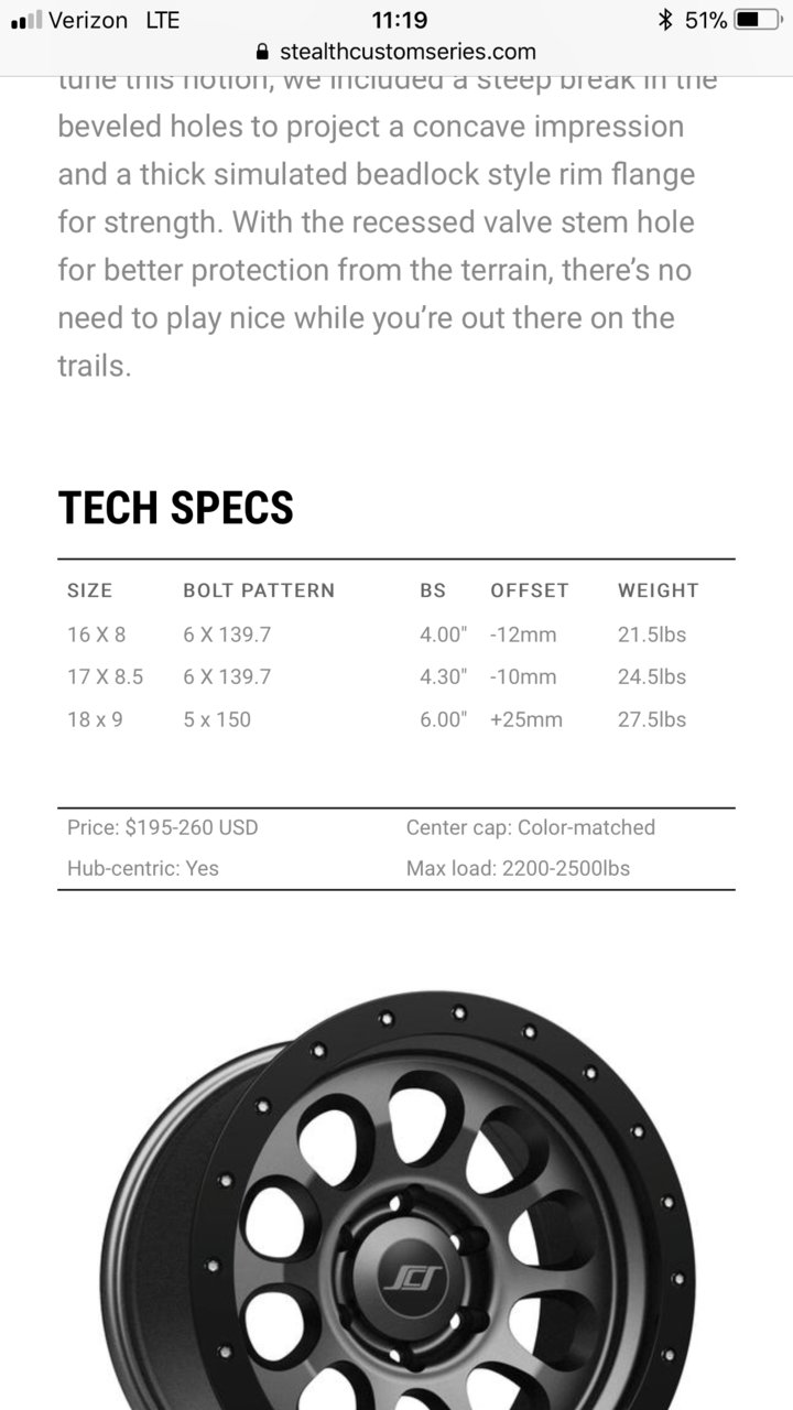

    From what I remember they are pretty light compared to the methods and ultras we run. And they just mount easier, the beadlock version is especially nice. The outer lip where the ring sits is extra thick and the ring itself is thick and billet (if I remember correctly) so they rarely have flexing issues on the ring. (Methods are notorious for ring failure from my experience). Very nice choice mike!

    Also very good to know about the structure to it, I was unaware. I do know they're a 2500# load rating which I like. And that lip is pretty thick.
