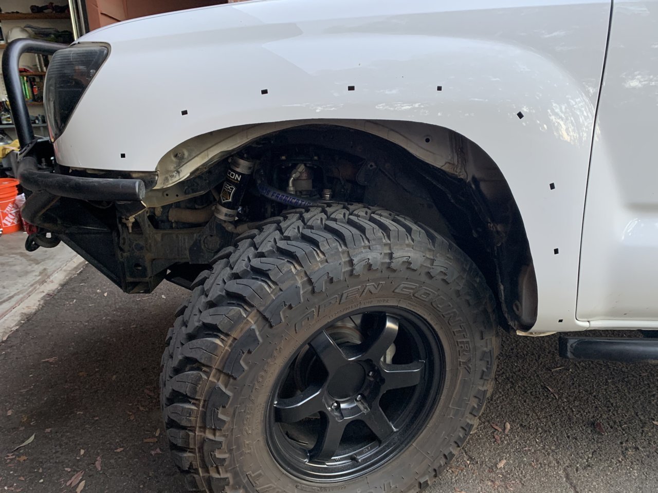

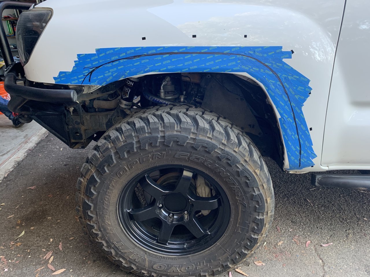

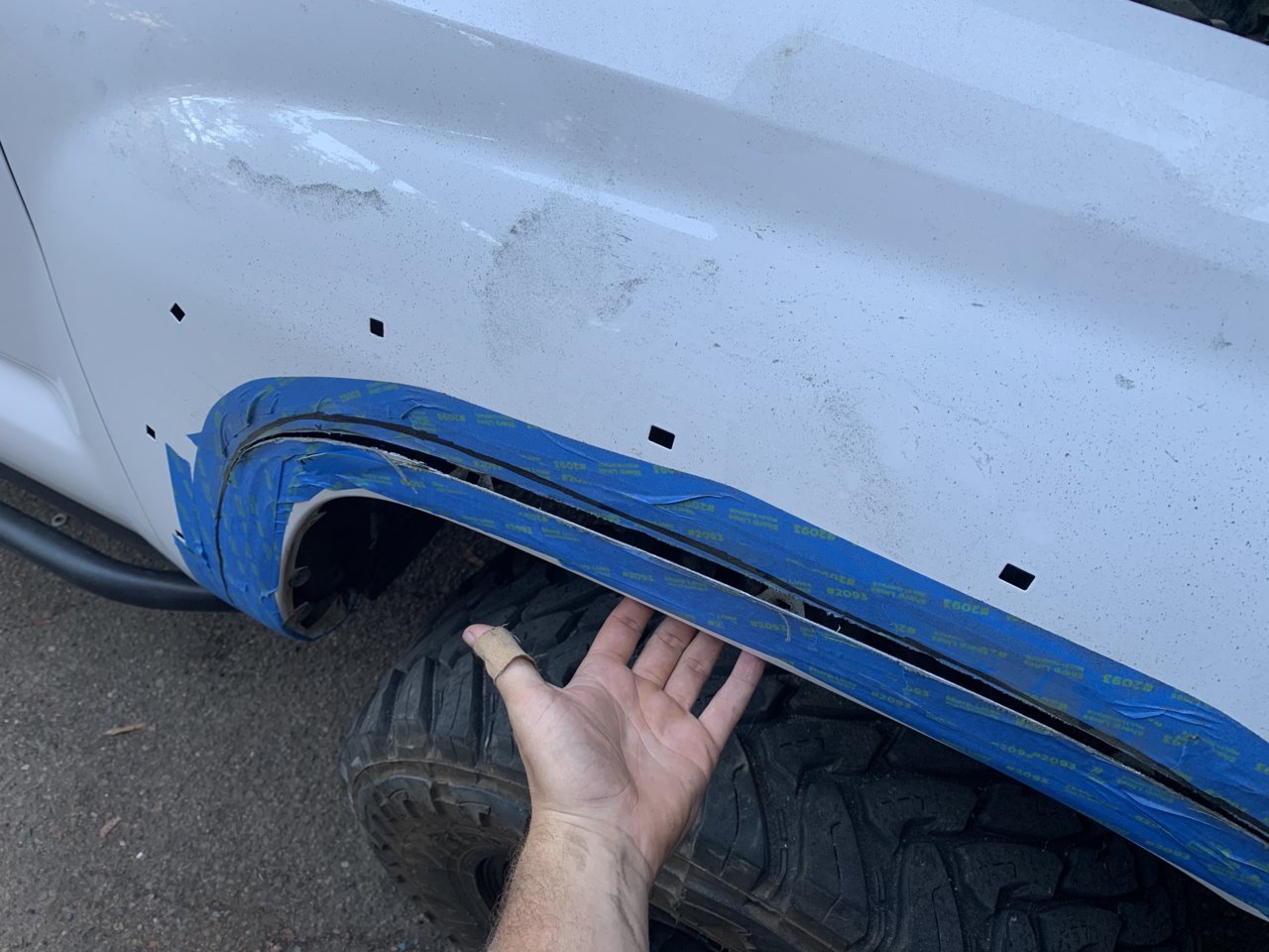

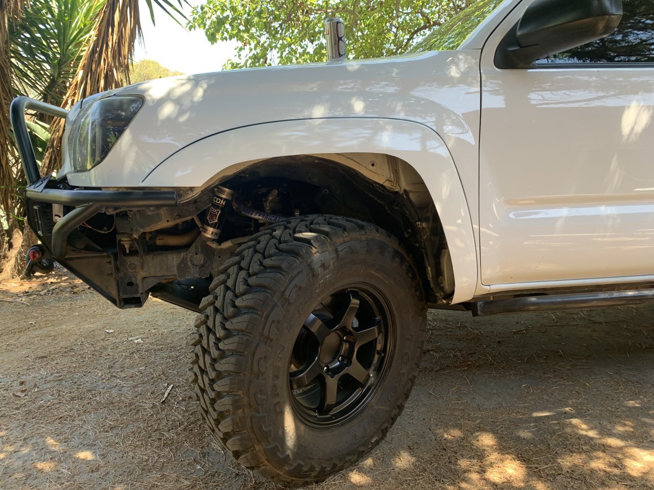

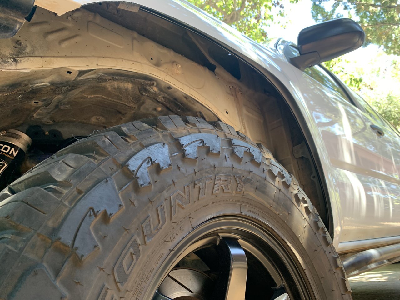

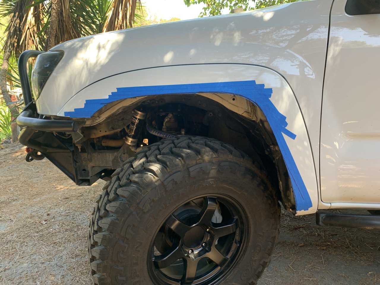

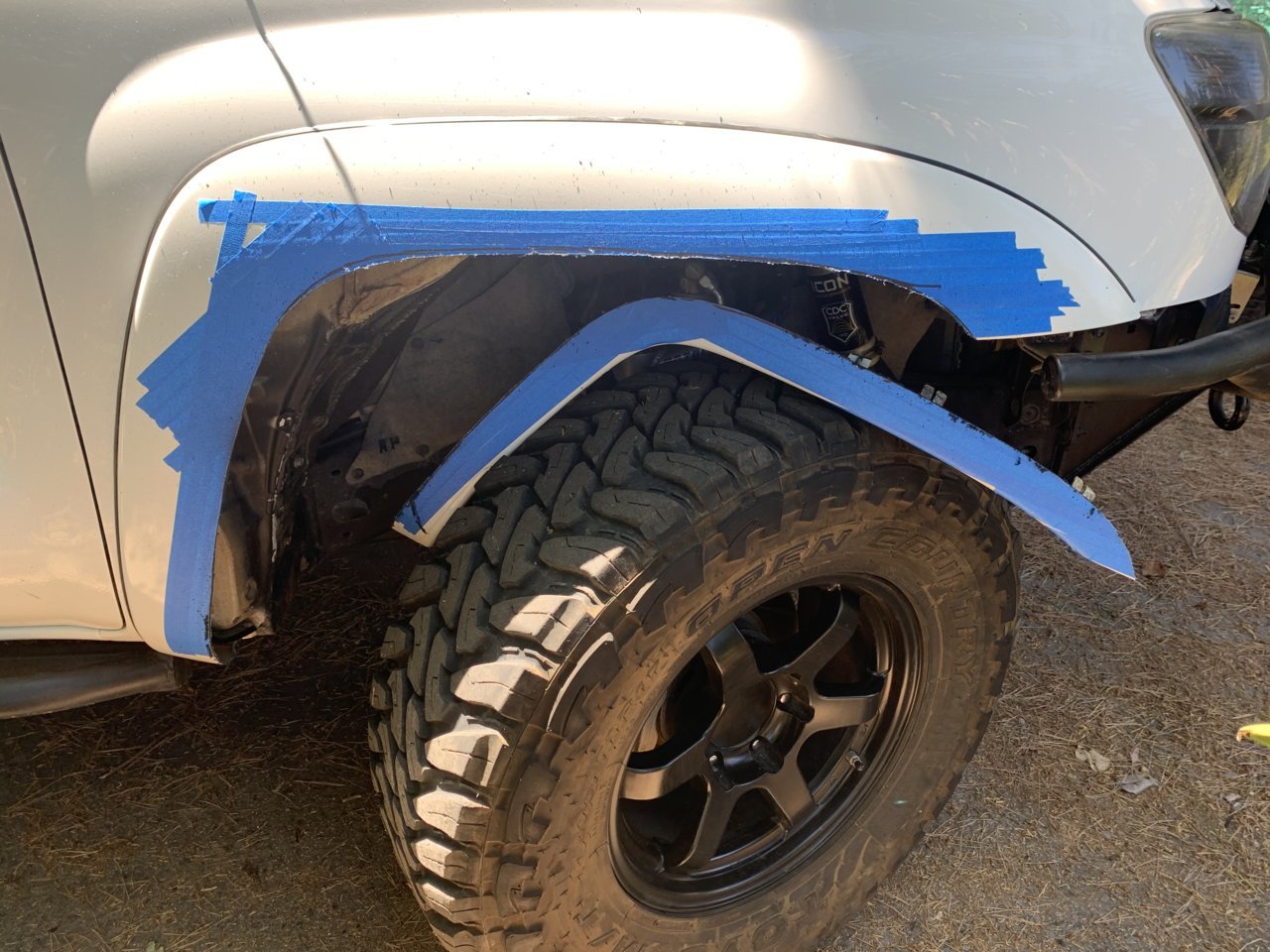

    Fenders cut, edges painted. Tomorrow it’ll get the edge trim, flares cut and put back on.
    2BDD83BF-2893-4208-85D9-33A0C05FD920.jpg 108A054A-B21B-414E-A70A-0151991A868D.jpg 202111A2-5D09-4A5B-9E02-A88D227E1695.jpg 5E4A9E7A-705F-49C8-8A6A-AA0763D710DC.jpg CB334911-0F69-438C-89BB-1904A9953DF4.jpg
    Lines didn’t work perfectly because the inside lip of the fenders were jacked up from the tires, so some of it was eyeballed. Then used my hand following the fender to keep mostly consistent depth. (Word of wisdom, cut your fenders before you up your tire size haha).
    Cut with a dremel, then smoothed it all out with a grinder and flap disk.

    Cuts look good. :thumbsup:
    (Even the cut on that thumb under the bandaid)

    Got a little more than the fender there, did ya?

    You would think that, but my finger was cut before we made your brackets!
    I smacked it with a hammer :smash::annoyed::facepalm:

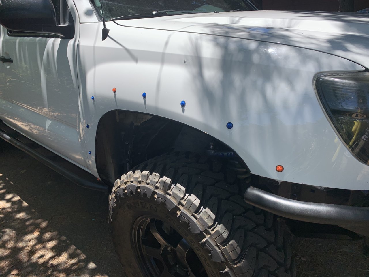

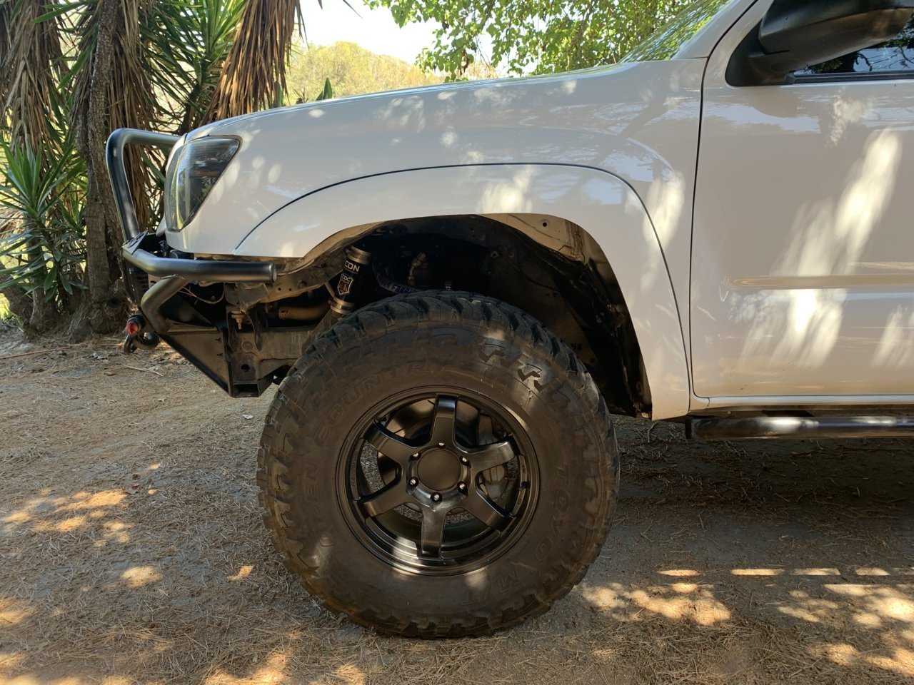

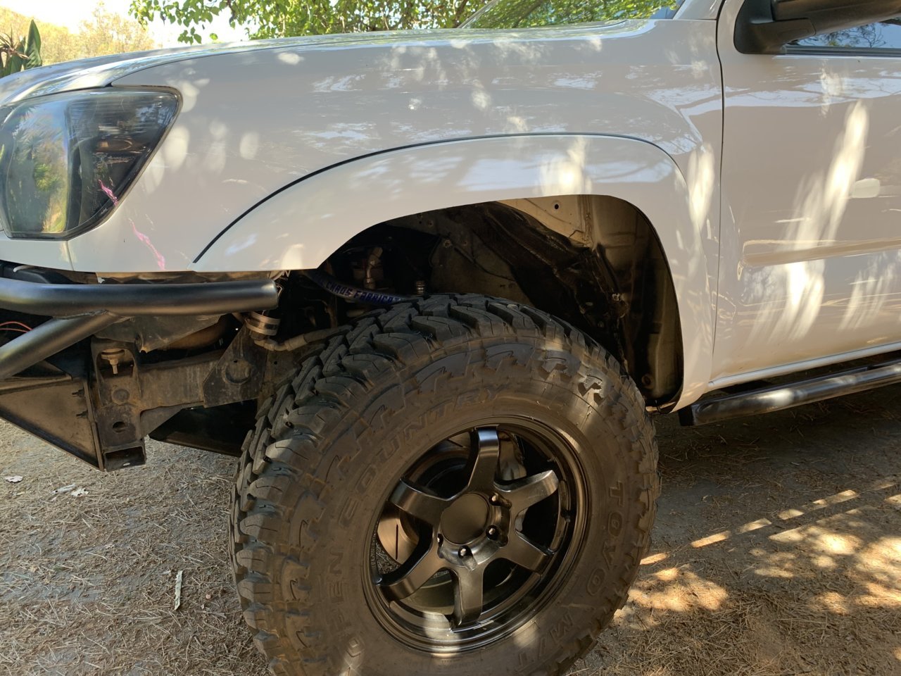

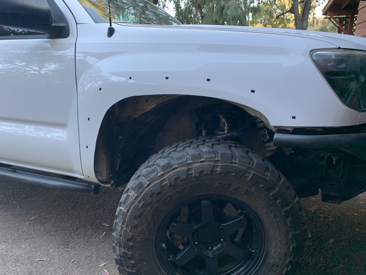

    Flares are back on and cut!
    I read someone using zip ties, so I yanked all the plastic clips out (hindsight, a mistake). Zip ties did not work to attach the flares.
    Forgot the clip color orientation, but found a video that had the clips on. They go front to back. Orange blue blue blue orange blue blue blue orange. Scored a bag of clips off Amazon with next day shipping for 7 bucks. Got the clips today, slapped the flares on, marked out a 2” cut and went to town.
    3DCA92CF-5B7F-4799-A6B8-622ABE434611.jpg 712F36BC-4339-4FA3-9F07-D7CC73B96915.jpg BCDED2CF-001F-40A6-8F6A-43B4C21AB861.jpg 6FD77A40-76B5-4FE1-9B0D-D9B34A50B93A.jpg A3BA5EFB-4049-40C4-93C6-78EDBFC41D40.jpg 88E36D18-791F-4E9B-9DCD-F704ADFB70AA.jpg 823EA1F4-11DE-43D3-9777-17BA778C44CF.jpg
    Tip from @anthony250f was to use a self tapper at the bottom of the flare near the cab. I cut off where the stock screw went in, so a self tapper worked perfect to secure the bottom of the flares.

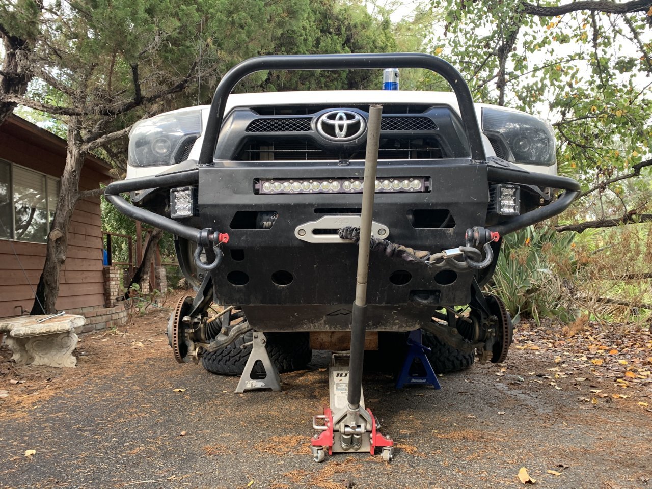

    Passenger side CV was leaking. Got that pulled out and replaced with an OEM spare.
    Pry bar method was not happening for me. Ended up running to Home Depot for several feet of 1/8” stainless steel cable, and some cable clamps. Made a slip loop on one end to loop around the CV, then a loop on the other end for a hammer.
    After some heavy swings it popped out.
    Replacement went in easy, got everything buttoned up, and will top off the diff oil tomorrow. Man I hope I can get to the fill plug without pulling the skid off again :rofl:
    Next step is to get a couple boot kits and reboot both the spares.

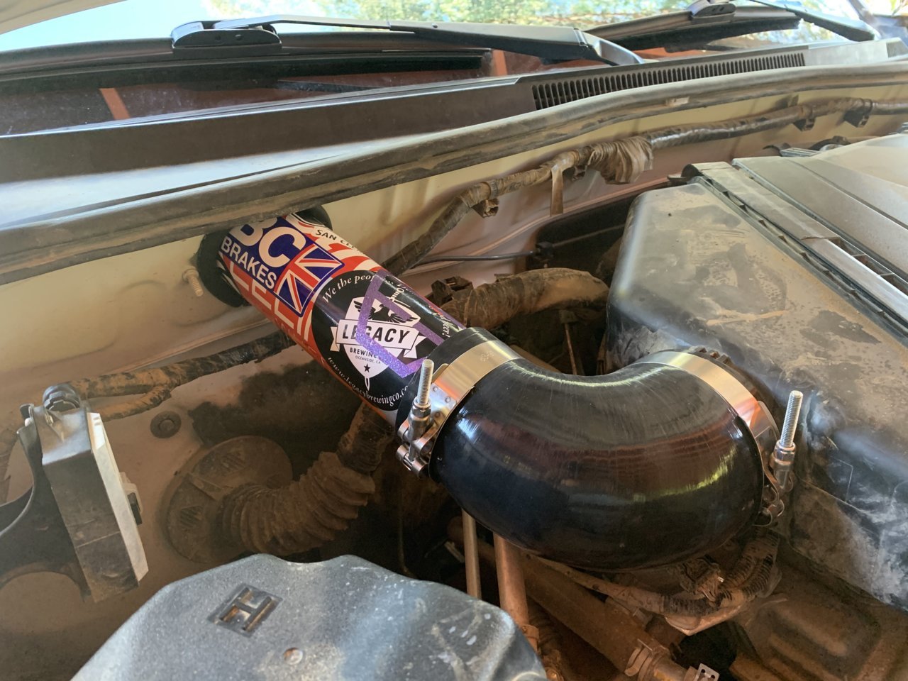

    How does smog check view that, or do you switch back to stock for a day?

    So the air box is all stock, the only thing that’s changed is where the air is sourced from.
    I’ve read some people have had issues, some haven’t.
    I figure my best bet is to bring the stock air tube with me, show them and hope I’ve got a reasonable tech. If not, I’ll swap it. It’s not hard and the stock tube doesn’t need to be bolted down or anything.

    Hopefully I won’t encounter that same moron. Had to reroute the intake, so if I have to swap the tubes for a smog it is what it is.

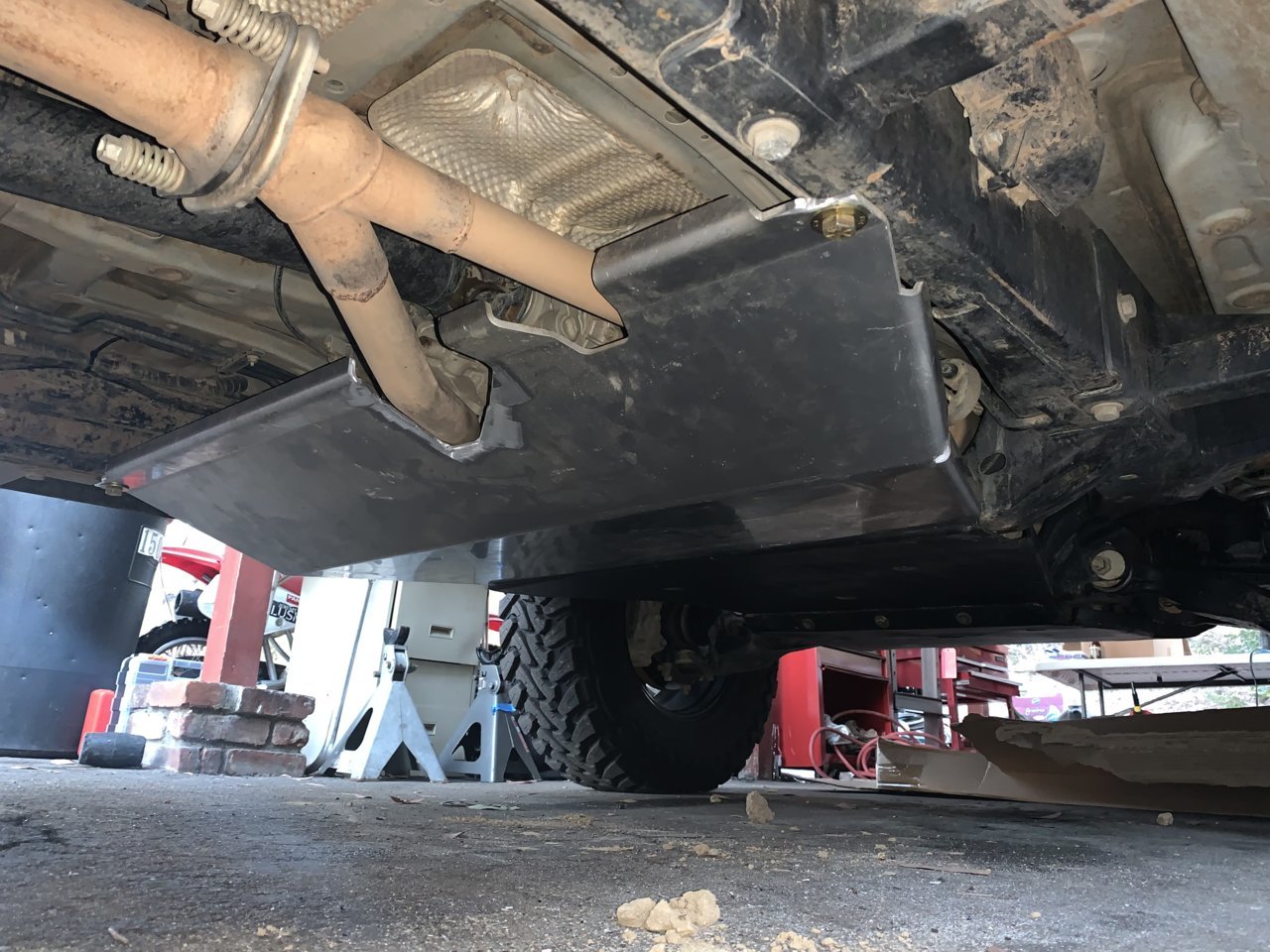

    San Diego, CA
    2016 Tundra 4x4

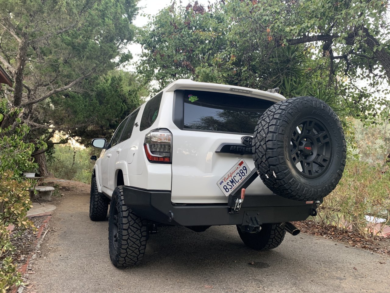

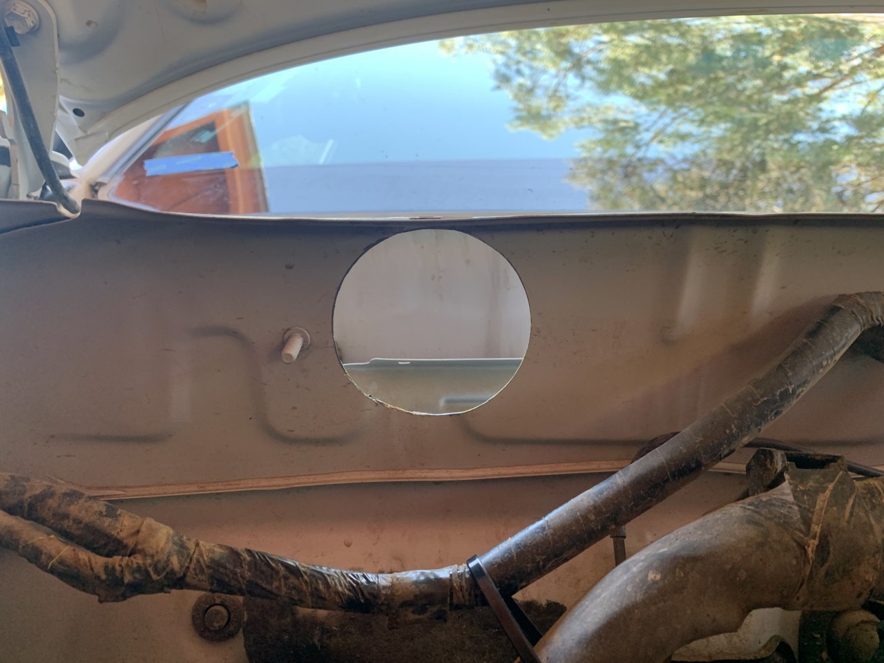

    I added another skid today. It’s been sitting around for like two years but finally cut it to fit (because my reroute wasn’t done right...my fault for not bringing the skid when it was done). But it’s on! Not painted, but fuck it, it’s aluminum.
