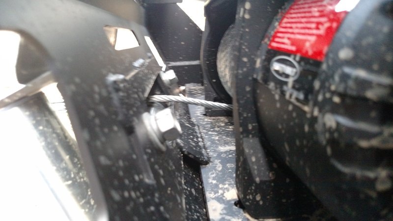

    Opps..Houston, we have a problem. Possible solutions:
    1. Switch to synthetic cable and hope the diameter difference makes up for the problem.
    2. Make the hole in the bumper wider
    3. Shim the winch up with washers
    hmm...

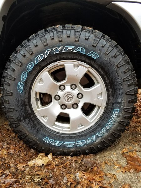

    Actually i have not taken a picture since getting them! tomorrow, when the sun is out

    Think you'll need a combination of all three. The synthetic line will probably be the same diameter, but the weight savings and safety improvement will be a nice bonus.
    You might have to take a dreamil and open up the slot a bit, for a spacer I say mock up with washers for a temp fix and then long term get a full plate that raises it up and has the holes that line up with the winch

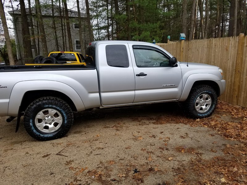

    Ah yeah, man tires.

    Thank you. Also for anybody interested the yellow s10 in the background is for sale as well as the tires that are in the bed. lol

    OK, I am a total idiot! In looking at the situation, I noticed that the smittybilt fairlead had a second set of holes for the bolts. I flipped the fairlead upside down and put the bolts through that hole and now it works like a charm! It pulls the roller up just enough to keep the cable off of the metal bumper. The simplest is usually the right one lmao!
