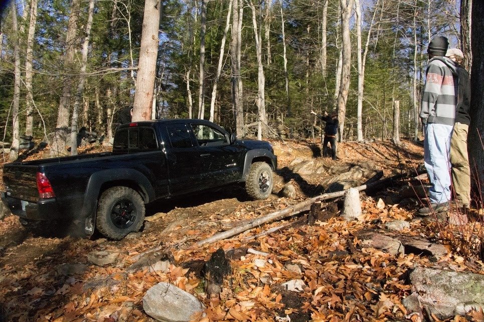

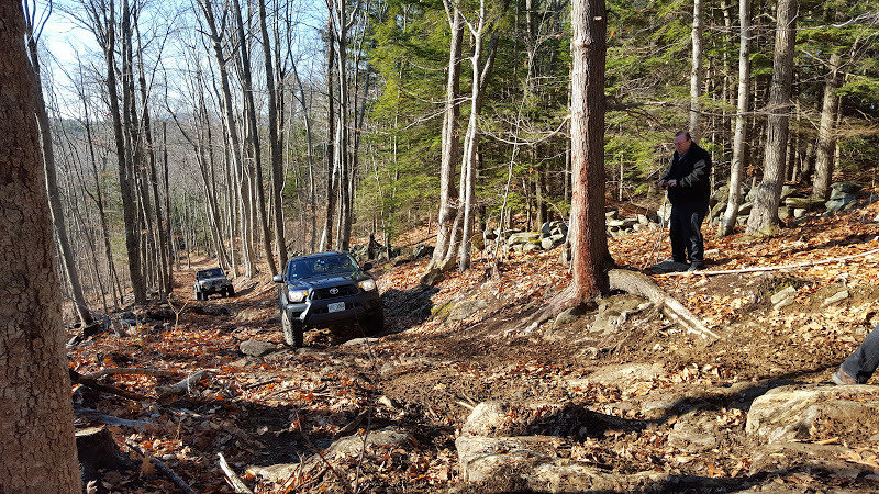

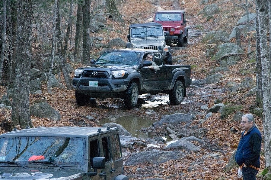

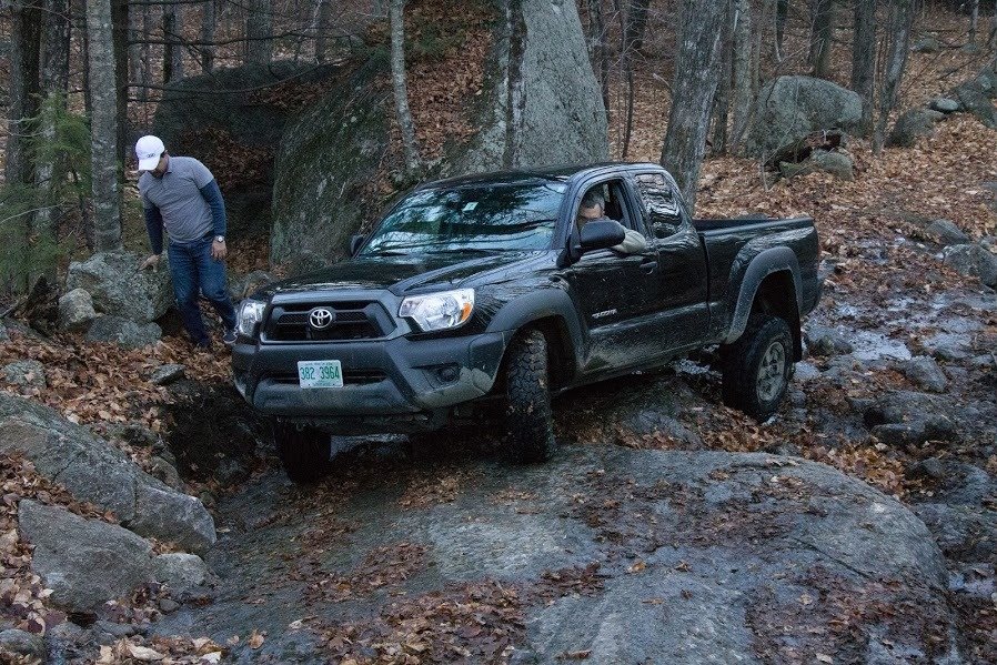

    This last Saturday I went on my first “real” trail ride with a large group of folks. I say my first “real” trail ride, because this was the first time I never turned around on a trail. There are tons of trails where I live, and being an avid outdoorsman, hunter and trapper, I have been on many of them. Usually I am alone, so at some point I usually turn around if the trails get too crazy. This time, however, I was with a group of well-versed off roaders. I really liked the comradery and the safety net of having so many experienced drivers there. It gave me the desire to keep going and attempt obstacles I would never have dreamed of before.
    One of the coolest things I learned about on this trip was the importance of a spotter! I had some great spotters on this run. I quickly learned that if the spotter was really good at their job, then I could focus almost solely on them and slowly move through the obstacle. Another thing I learned was to stay humble and ask for a spotter whenever I felt I was getting in over my head. Poor Paul and nick put up with me all day asking for spotters over relatively easy obstacles…God bless ‘em.
    At one point, after the sun went down, I was at a particularly hairy little boulder field (at least it seemed it to me) and Nick literally spotted me through the obstacle in the dark! I might as well of had my eyes closed. Talk about a trust exercise!
    Also, driving behind various people throughout the day was very instructive. I thought I was a good driver before, but I have tons to learn! Some of my favorite parts of the run where the sections that required the most technical driving. Running behind Tundra was a pleasure, watching him ease over rocks with a detailed precision.
    Here are some other things I learned:
    · I live in NH – THE Granite State -> I need sliders and skids….too much stress worrying about the rockers and the undercarriage.
    · Airing down is friggin’ great.
    · A lift is in order.
    · My 235/85 Cooper STT Pros rock!
    · Back mudflaps must go.
    · I love trail pinstripping!
    A couple more shots:

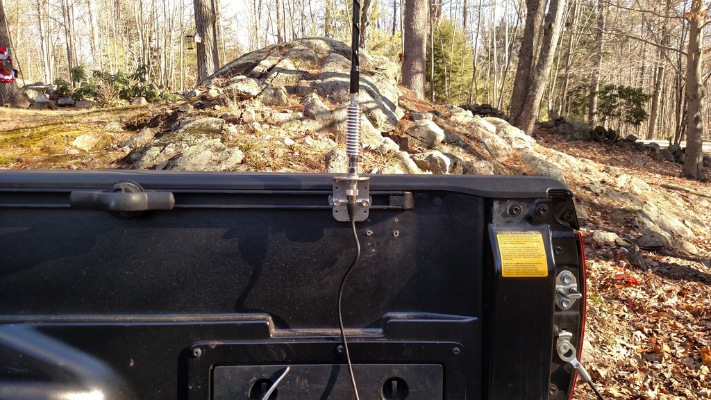

    Well, I finally got my CB installed properly! Here is a pic of the mount inside the cab:
    Trying to get the SWR down gave me fits for a week! I thought it was the ground, but it turned out to be the mount location. I had lag screwed it on to the plastic bed liner and ran a ground from the mount to a known ground. I couldn't get the SWR below 3 on any channel. After trying all sorts of stuff (more grounds, different grounds, testing cables, buying anew antennae), I eventually started moving the antennae around and saw that it indeed was the location. I mounted it on the bed rail slidey thingy and yee haw! I was able to tune the antennae to a little over 1 on channels 1 and 40. Happiness. Now I have a Firestick II and a Wilson Flex. Have to see which one I like better. Now all I have to do is run the coax a little more discreetly. Kind of redneck to have it hanging out the back window.
    Pic of the mount and the carnage from the initial mount attempt:
    Yes, that is a huge bolder in front of my house :cool:!
