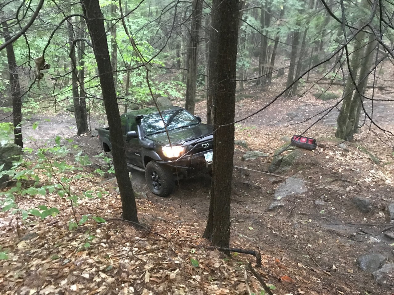

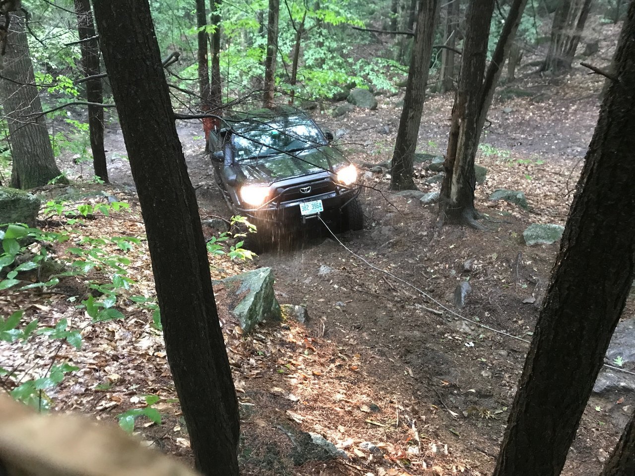

    Been wheeling a lot lately...life is good. Been putting the winch to good use too because of the rain.
    Pictures don't do this hill justice, but it is steep.

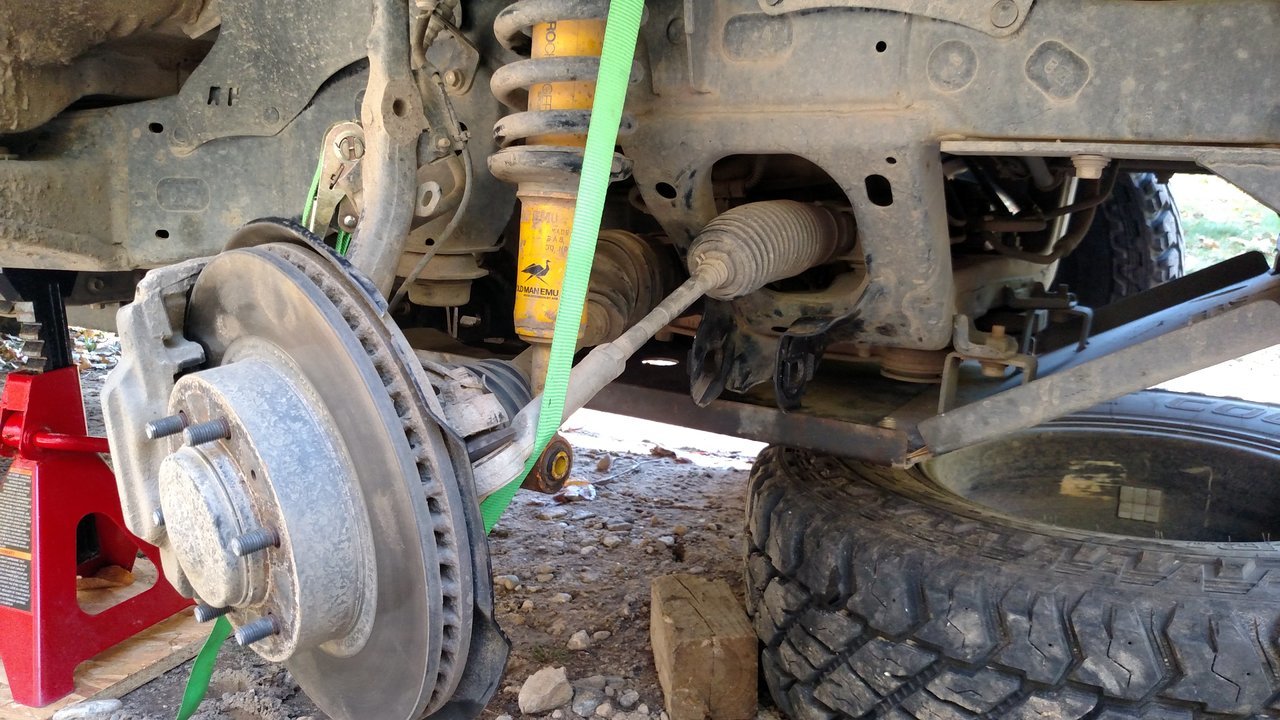

    Started tearing apart the LCA's today. The front cam bolts are frozen up real nice! No lube or anti-seize on the cam bolts...nice job Toyota! Had to sawzall one of them out, that was fun lol.

  14. Oct 19, 2017 at 11:12 AM
    #394
    Sloth
    Sloth Baby Ruth?
    Nov 16, 2012
    #91263
    12,567
    Seth
    Democratic Peoples Republik of Massachusetts
    07 FJ Cruiser, 98 Landcruiser
    Stuff
    Going to make the fall crawl?
    I did that a few years ago, no fun at all. Now they are covered in anti-sieze and I pull them once a year to clean/ regrease.

    Yeah, I am totally adding that to my routine maintenance. Ended up having to drill out the sleeve from the bushing. Hopefully I don't have to replace the bushing too.
