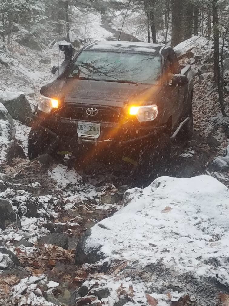

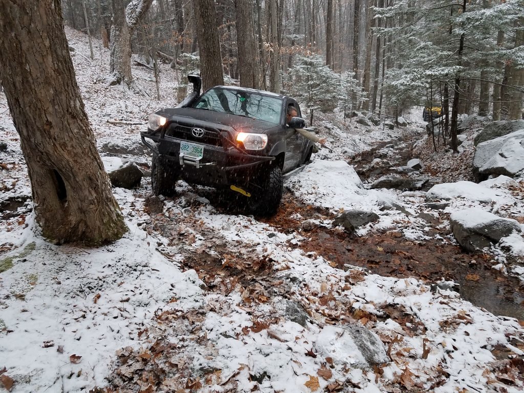

    Wasn't too bad until around 5. Got really slippery after that. No one made it up Rowe this year. Just too slippery. I finally did papa bear.

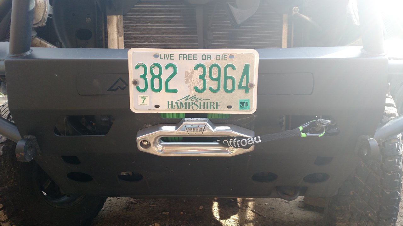

  16. Feb 27, 2018 at 12:00 PM
    #456
    ecgreen
    ecgreen [OP] overeducated redneck
    Sep 1, 2015
    #163187
    1,485
    Sean
    2015 4x4 4-banger Access

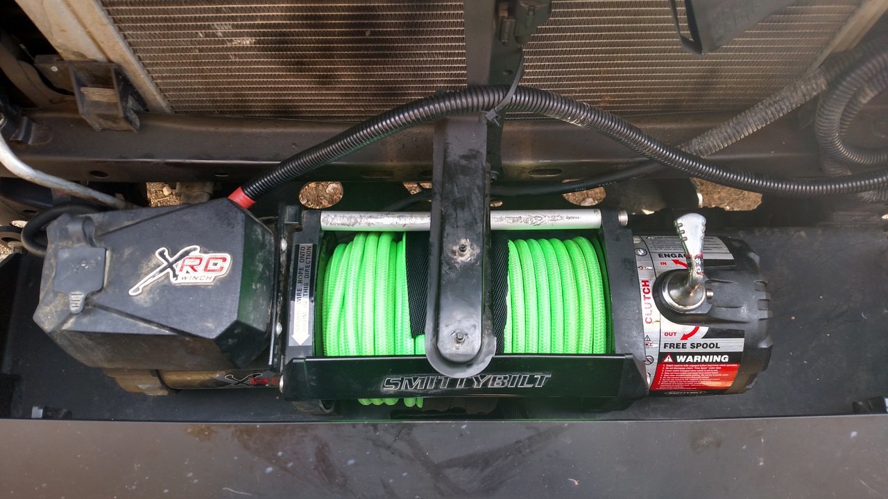

    I finally got around to getting rid of that freekin' winch cable. I went with an Arachni 7/16ths synthetic rope (100ft):
    And of course a new fairlead:

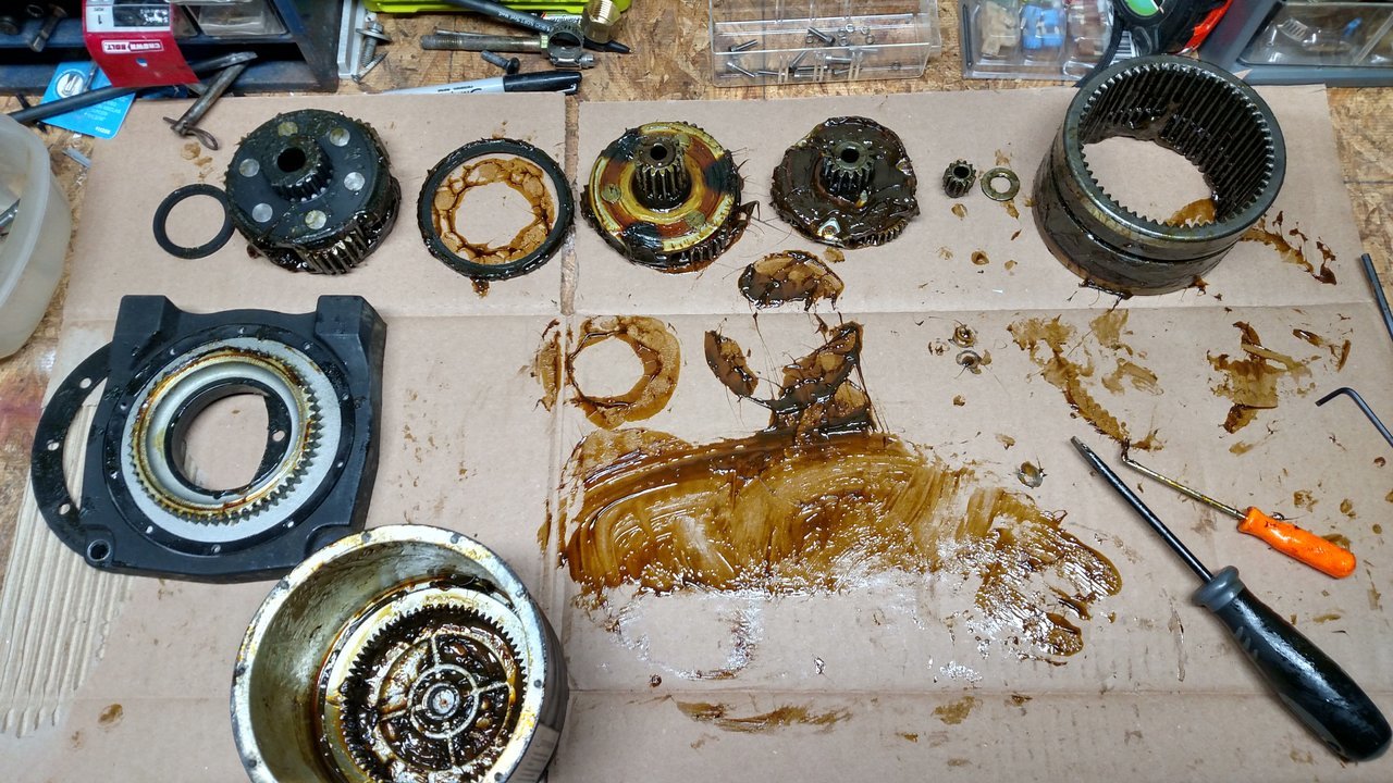

    My Shittybilt XRC 9.5 has never freespooled worth a crap. So I pulled it apart and saw that it was packed with grease to the point where it almost immovable. Given this, I dismantled the son of a bitch:

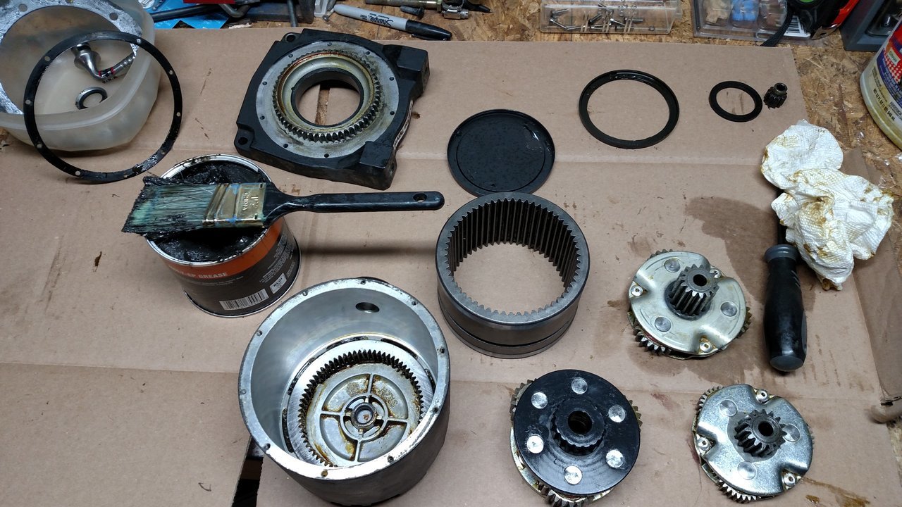

    Then I cleaned the gears as best I could:
    I reassembled with a light coating of molly on the gears. I didn't put ANY lube between the freespool sleeve thing and the main housing. I just took the clutch lever off and filled it with WD-40 while rotating the drum. The grease just provides too much friction and restricts free-spooling. It free-spools like a dream now. I just need to remember to put some WD-40 in there every so often. I got the idea from this video and it works awesome:
