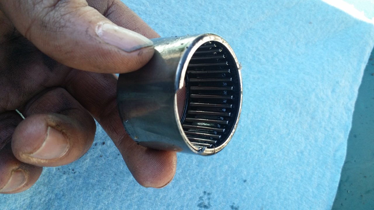

    I just installed the ECGS diff bearing on my 2005 with 2.5" lift. Wow what a difference it makes. Must have been a ton of play in the original bearing. It never rode this smooth even without the lift. A piece cracked off the old bearing when I was removing it and I had to fish it out. Almost didn't see it. If your doing this upgrade you might want to double check the old bearing once you remove it.

    I also cracked a portion off and it was in two pieces.... finally found both with a magnet.

    Yep, sounds like it's pretty common to break off a little piece. I did the same on mine and luckily got it out too. I think it happens when putting the little puller tool in place. I had some plastic stuck down in there so it couldn't go far.

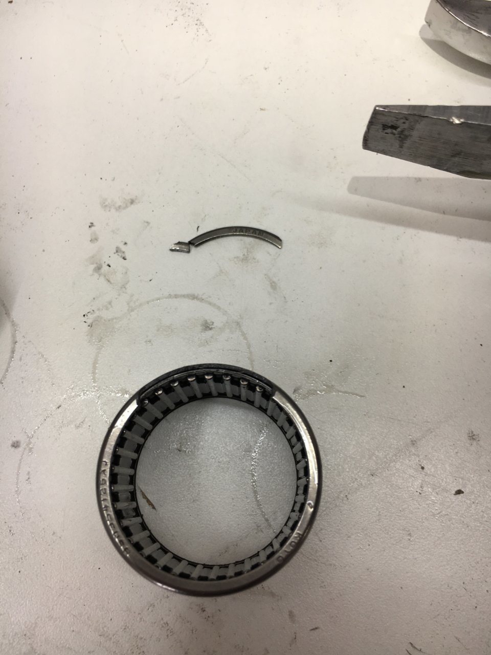

    Here’s mine. Didn’t realize it til I was cleaning up before reassembly and about to throw it on the trash. Whew. 679C3151-3757-42B2-A9A6-894B83E8FA52.jpg
