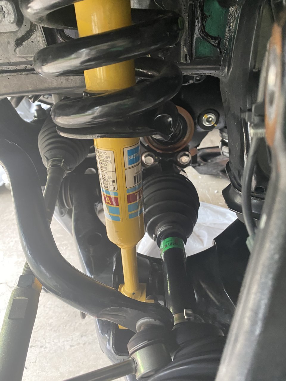

    Like this? Not a great pic since it only shows one little area. It’s been almost 2 years too. I think at that point, the LCA side hub bolts were removed and the hus was supported by a bucket. The sway bar was also disconnected. You can swing the hub out enough for the cv to pop out. Be careful since you can separate the inside part of the cv as well.
