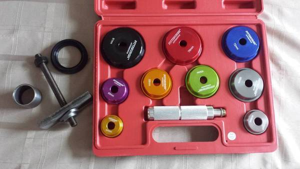

    I got the CV Axle bushing from ECGS along with removal tool, the install tool, and the axle seal. I was trying to find out more information on the install tool(s) (guessing everything in the red toolbox). Has anyone used these?

    I used the install tool pictured. You simply use the right sized collar, bolt up the driver to it, and hammer away until the bushing is in.

    But you don't want to hammer it all the wat in too far. Then it may contact the spider gear or something like that. Follow the video exactly probs

    I used a socket, flipped around so that the part you would put the head of a bolt into was facing you. The nice flat surface on the other side was in contact with the ECGS bushing. Put an extension into the socket and hammered away. Bit stressful as it is in there pretty damned tight and I was freaked about making sure it went in straight.
    Those thing's you've got there look pretty slick though!

    06tacodude do not use the pilot bearing puller. My buddy and I just got finished with this project this weekend. Initially I bought the removal tool from ECGS and the small machined part at the end to pull the bushing out bent and snapped. It most likely was due to having it not set straight. After that we tried a slide hammer with the pilot bearing tool attached and it could not provide enough force to get the bushing out of there. You need steady pressure as provided by the tool. After calling it a day we drove up to ECGS and got a replacement for the part we broke, made sure we had it set in straight that time, and it came out with no problem.
    I will say that it was more of a pain to get the new bushing to go in straight even though we had the had tools provided by ECGS. It seemed no matter how hard we tried, the first couple taps always seemed to go at an angle. After constantly resetting for about an hour we finally got it.
