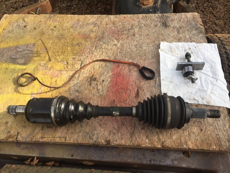

    image.jpg Remove wheel, remove Hub nut, remove caliper/rotor, disconnect spindle from LCA and hang everything out of the way. Get a CV puller like this (the rope in the picture, make the CV removal super easy). Once all that is out of the way, stick your fingers inside to feel where the needle bearing sits (this is important). The ECGS bushing is slightly longer and you don't want to drive it in too far. Stuff a small rag or plastic bag inside the diff. this will prevent anything from falling in there. Getting the removal tool inside is not as hard as you would think it would be. Just be sure it is seated right when you start pulling on it.
    The CV puller can be picked up @SoutheastOverland
    The slide loop goes around the CV. The black loop gets a 5lb hammer. A quick pull with the hammer pops the CV right out. I have used mine several times.

    @holyfield19, thanks! That CV puller is money. I did NOT like the idea of whacking at it with a hammer and pry bar. Maybe on a 15 year old rig that's been designated as trail-only.
    What did you use to tap the bushing in? The ECGS video looks like they put together some combination of nuts and bolt that happen to fit perfectly (mainly that brass nut that was actually contacting the bushing). It looked like the diameter was perfect and it was flanged perfectly, too.
    The only other video I saw of the bushing install, the guy used a socket and socket extension, but he said the socket fit snug INSIDE the bushing. That just doesn't sound like a good idea to me.
