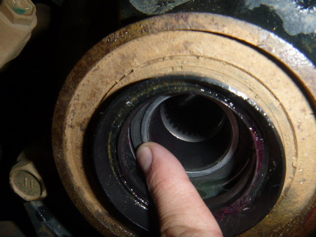

    Has the design changed on the ECGS bushing? watched the install video on thier website, look like they get the bushing in quite a bit further than I am. I'm trying hard just to get it to sit flush. I figure it has to be in the square or it wouldn't have gone as far as it is now. Any help?

    FYI this guy just did his and said the bushing came flush with the carrier. @winkel

    Indeed, and it's working great. We have a small bridge near here that I like to hit pretty fast. It just about puts me airborne at about 55 mph. I've hit it about four times in the last couple of hours and no funny noises, clunks or anything. I'm very pleased with the results. AND the dreaded drone/hum is GONE.

    Mine sits out a smidgen, never had any issues.

    Glad I'm not the only one... I was a little worried, but it seems to clear ok.
    For whatever reason, this was more of a bear than I thought it would be. CV did NOT want to come out, or go back in. Bushing did not want to go easily into the diff, and believe me I checked and checked to make sure it was square. Getting the needle bearing out was cake though.

    I just did mine 3rd gen, and it went in flush. Went in very easily with a Race install tool and a dead blow.
    You'll be so happy to not hear the howl, grind, vibration.
