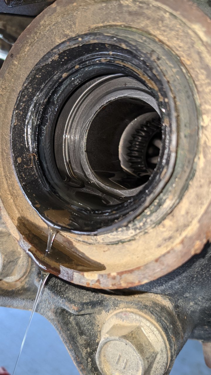

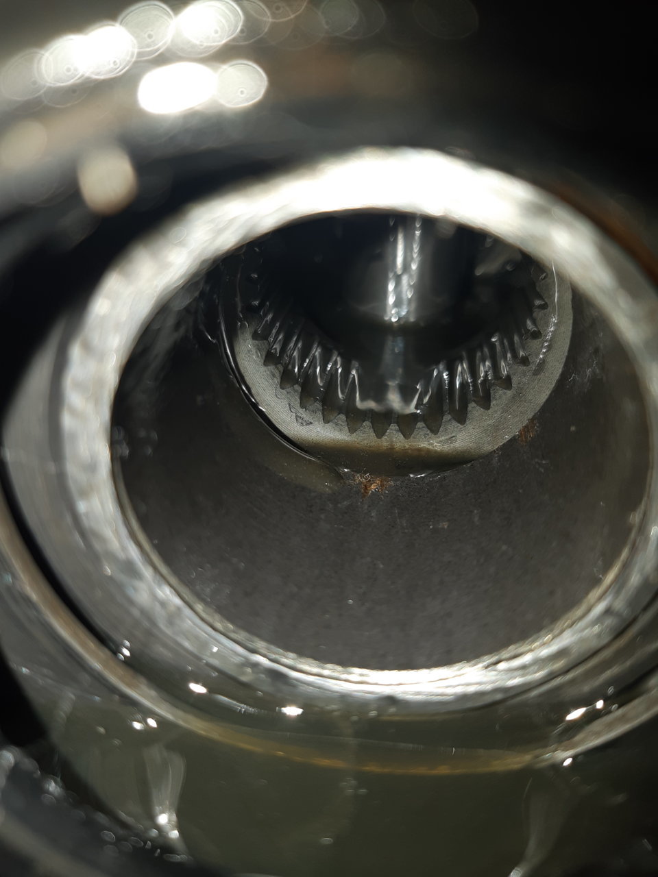

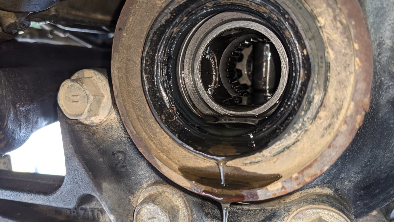

    I realize this thread is a little old, but I thought of share my experience thus far.
    I had some bad luck with the ecgs bushing. Only a few months after installation, I was still experiencing vibes, though it was slight. I took a look while I was changing struts, and too my surprise there was some unusual wear.
    I contacted ECGS, and they sent me another free of charge! ($25 for extra shipping to Canada) I will be attempting to remove the old one this week, so I can keep everyone posted. Here's a pic of the damage...

    I did mine a few weeks ago. I did a TON of searching before I pulled the trigger. I found 1 that went bad and it was due to the diff being ran low on oil. The bushing will burn up if it is not in a constant oil bath.

    There's damage? :confused:
    As for OP my guess is improper install of the bushings or incomplete insertion of the axle, use of aftermarket axles, low fluid, or a bad shock leading to excessive vibration that could have cause accelerated wear.
    I've had two trucks with it and zero issues.
    When I replaced my CV axles I snagged a pic, everything looked dandy absolutely no noticeable wear. Approx 40k miles on it.
