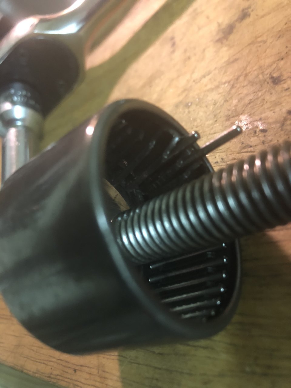

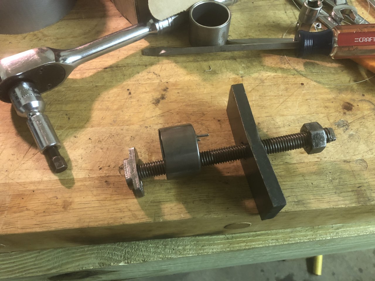

    Here’s what I did, I notched the end of the bolt with my cut off tool and pounded on a socket so I can put a wrachet on the end to hold the bolt so it doesn’t spin.
    Put everything back in, perfectly centered and tighten the nut on the outside of the plate a few turn and it stops completely tight, I’ll cross thread this tool I know it, this bushing is not coming out.

    It will take a bit of torque to get that bearing moving, it's in there pretty tight. The key is to have that back nut part square on the back of the bearing.

    And the more I think about it, I believe that bolt is going to spin more than the nut spinning on the bolt. Just make sure your centered, and the bolt is threaded all the way through the puller nut and just crank on it. It'll come out.

    Finally got it, only took five hours and the bushing is mangled. It was so tight it actually cross threaded one end of the tool and bent the plate
