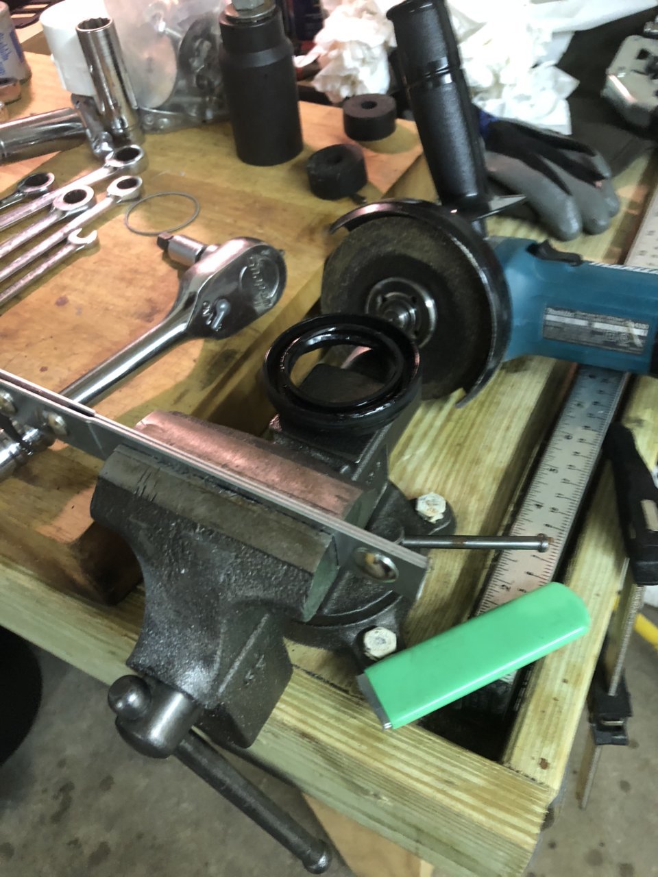

    I would but I don’t have leverage with my seal puller unless I take the lower control arm off which I’m not getting into that. Maybe I’ll cut the handle of the seal puller in half

    I got it thanks, just cut off the handle of my cheap seal puller

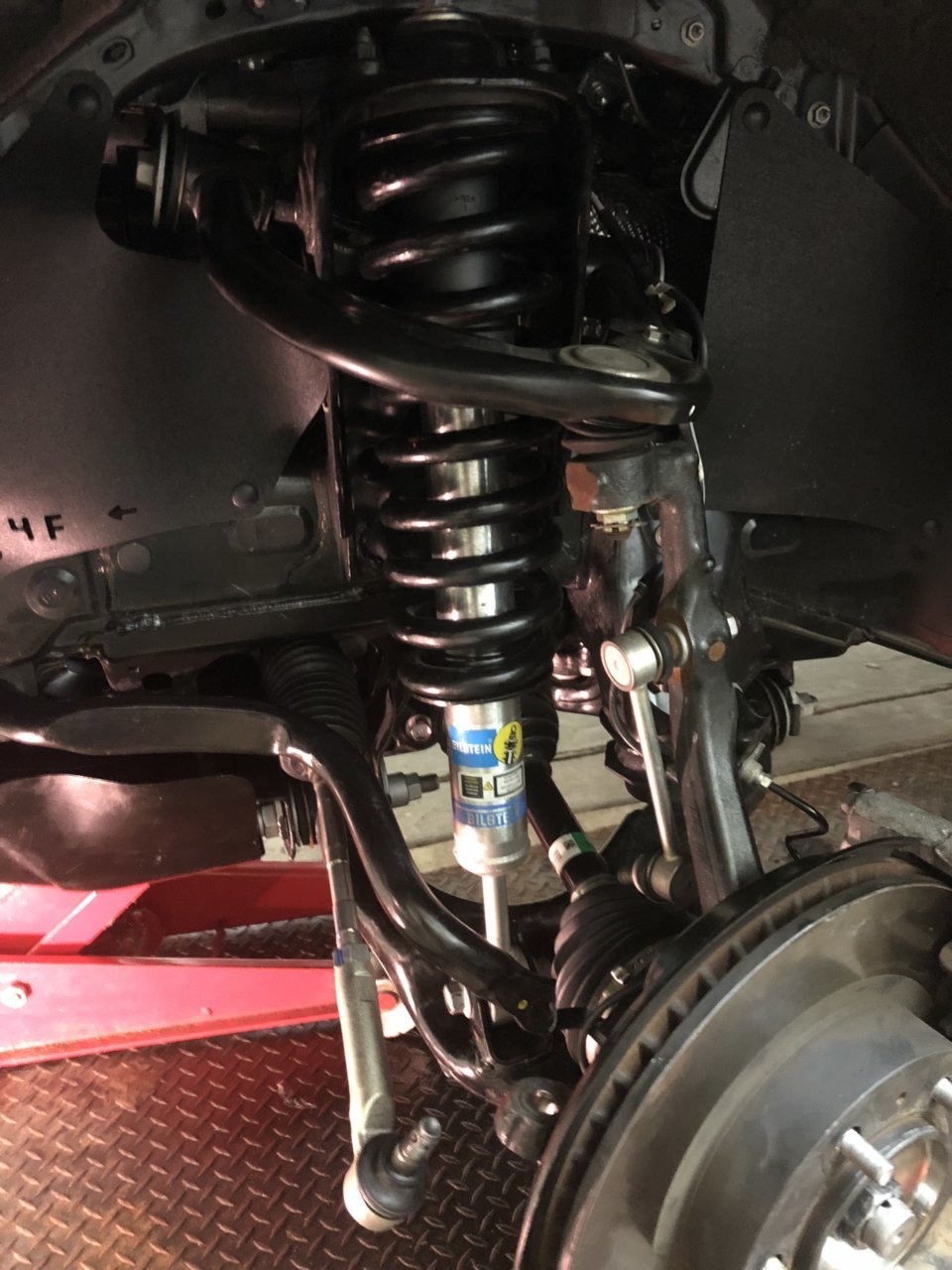

    One side done have to do the other side Bilstein

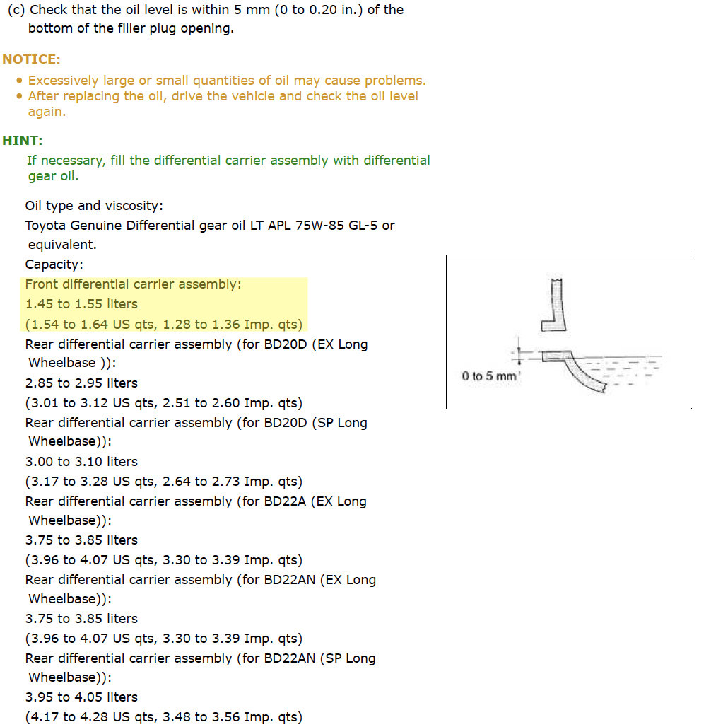

    What’s the axle nut torque spec 178lbs?

    173

    What’s the front diff fill 1.6 Qts?
    Sorry just exhausted and finishing up.

    Not sure the exact number, sorry. I think it’s 1.8. Just full until it starts to flow out of the fill hole.

    That’s what I usually do thanks, I read it’s 1.6 Qts somwhere, I have no idea where my owners manual is

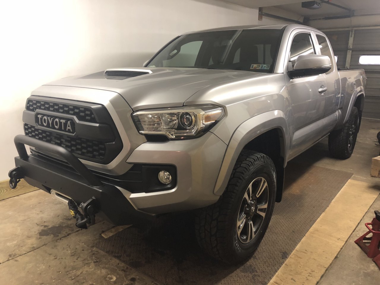

    Finally done after a few days all for 1” lift in the front (settled .5”) and ecgs bushing after AAL 1.5” in the rear. Going for test drive

    It’s not that hard, just put a small plastic bag in their so you don’t lose the end of the tool. Also, you have to tap one side of that piece to get it aligned, the videos don’t show that clearly. Have all the tools ready along with a new seal
