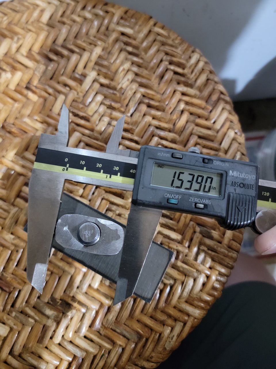

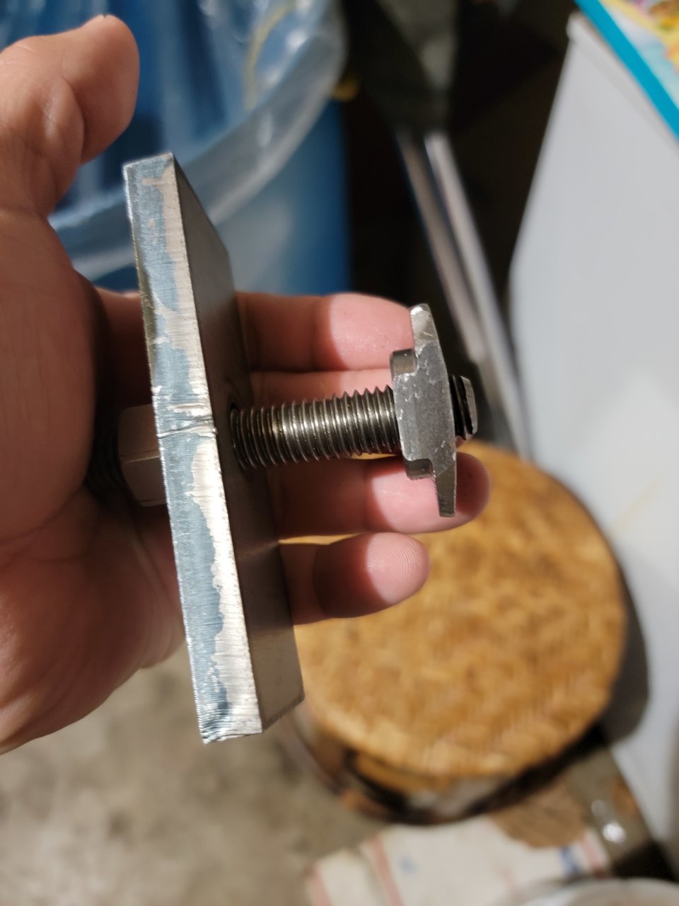

    Saechao503
    Saechao503 Well-Known Member
    Aug 26, 2014
    #137009
    290
    Khae
    troutdale oregon
    2015 tacoma dc trd offroad
    Here some pictures of after I got it to fit.

    #27
    TnShooter
    TnShooter The TacomaWorld Stray
    Sep 2, 2010
    #42625
    21,163
    Deogee
    07' TRD Off-Road, Auto
    STOCK
    That is GREAT information.
    Saves others a lot of time:thumbsup:

  8. Mar 14, 2022 at 9:29 PM
    #28
    Saechao503
    Aug 26, 2014
    #137009
    290
    Khae
    troutdale oregon
    Let me know if you guys need any other measurements of it

  9. Mar 15, 2022 at 4:26 AM
    #29
    Hook78
    Hook78 [OP] Well-Known Member
    Dec 3, 2017
    #237571
    6,879
    Eastern NC
    2015 DCSB TRD OR
    Bilstein 6112/5160 Icon RXT
    It looks like you also tapered the ends so they are not as thick?
    Saechao503[QUOTED] likes this.
  10. Mar 15, 2022 at 5:29 AM
    #30
    Saechao503
    Aug 26, 2014
    #137009
    290
    Khae
    troutdale oregon
    Correct. I felt like it was too thick to get in-between the bushing and the diff inside
  11. Mar 15, 2022 at 5:32 AM
    #31
    Hook78
    Dec 3, 2017
    #237571
    6,879
    Eastern NC
    2015 DCSB TRD OR
    When I was feeling around in there trying to seat the pull bracket, I had that thought too, it just seemed like there wasn’t enough space for the bracket to sit in between the bearing and whatever sits behind it.
