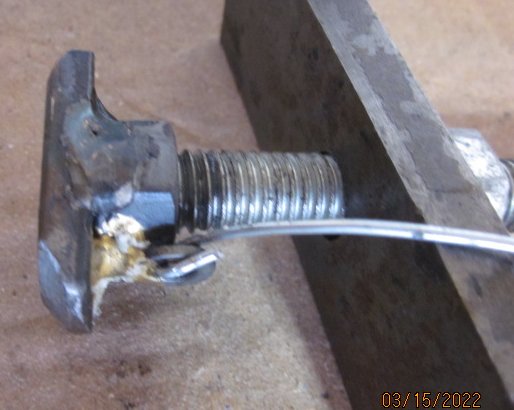

    Here's what I did when I made mine. I brazed a 1/4" lock washer on it and attached a wire just in case. I would have used a fine thread rod but I didn't have it handy.

    So smart. I see you shaved one end down so the edge is thin.

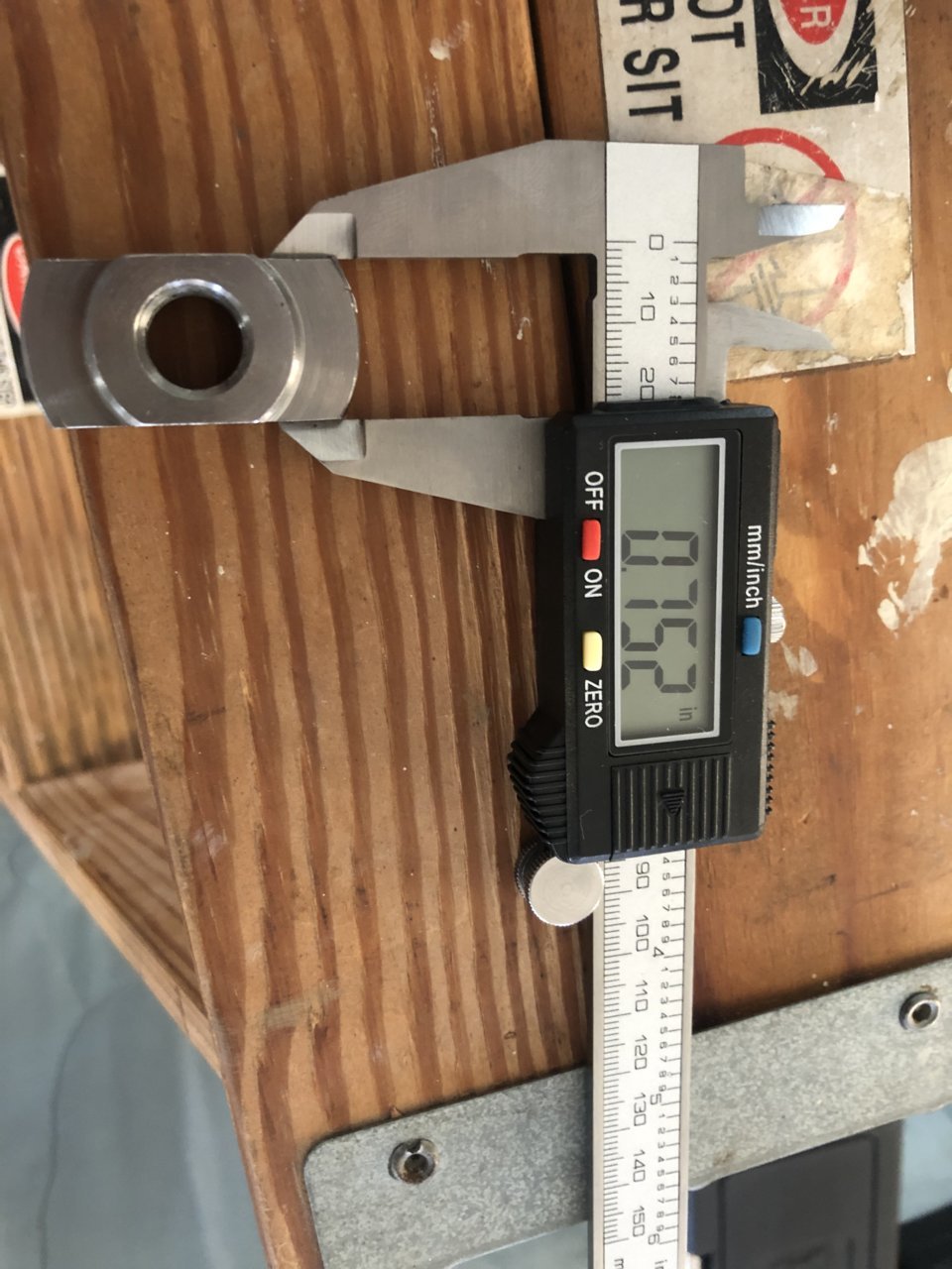

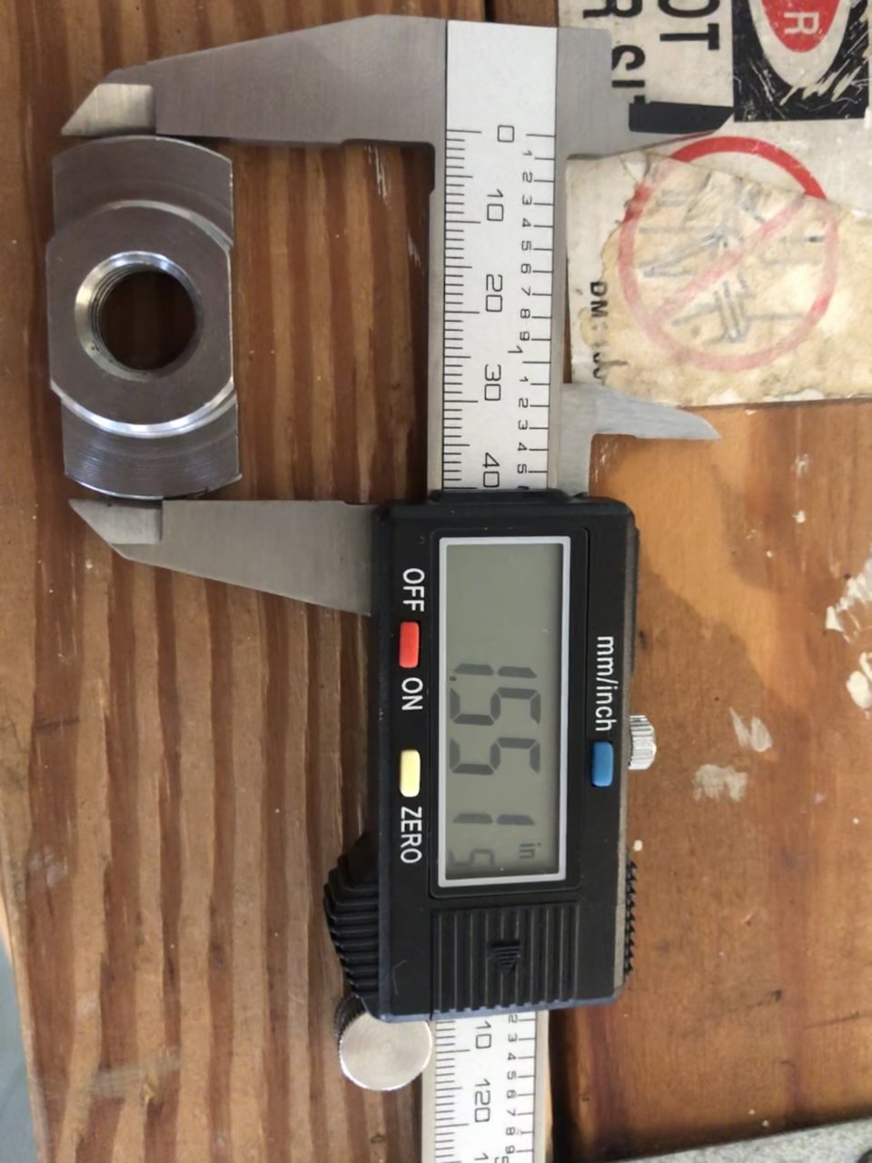

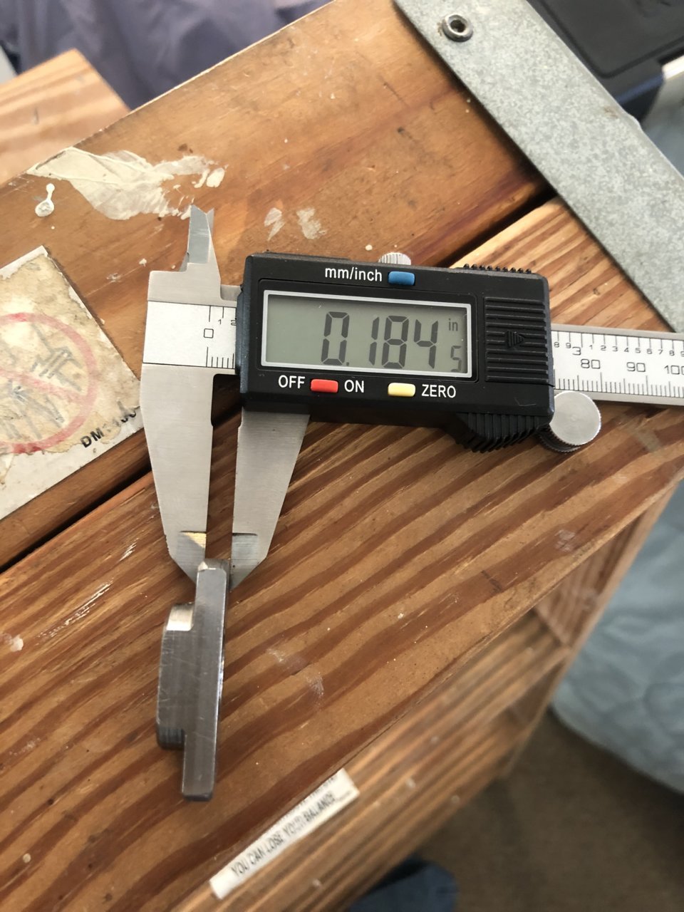

    I measured mine. It’s not been modified in any way.
    FWIW, I still recommend buying the tool.
    It was worth the $30 for me.

    Pretty much same dimensions.
    One possibility is my needle bearing is pushed slightly further into the diff than most, leaving less room for the tool.
    Perhaps that’s the key variable with all these folks who had to grind theirs down.
