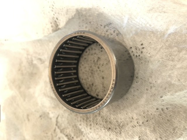

  3. Mar 21, 2022 at 12:47 PM
    #63
    Hook78
    Hook78 [OP] Well-Known Member
    Dec 3, 2017
    #237571
    6,879
    Eastern NC
    2015 DCSB TRD OR
    Bilstein 6112/5160 Icon RXT
    In all her glory. I feel like a guy who had a cyst removed and kept it in a jar.

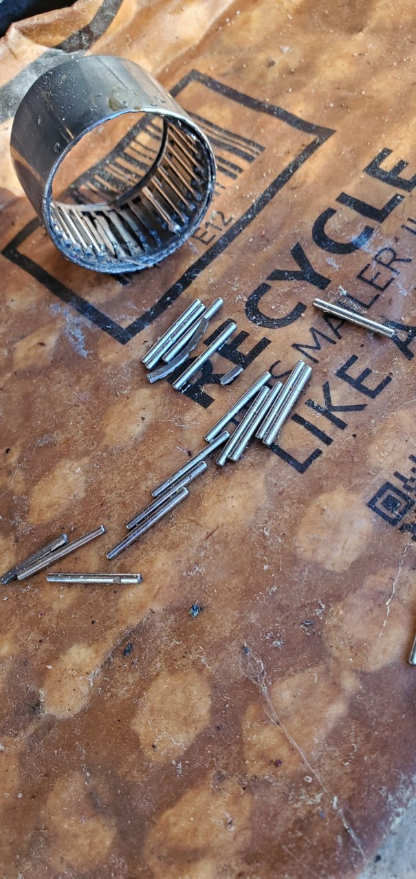

  8. Mar 4, 2023 at 5:13 AM
    #68
    TheGoat

  9. Mar 4, 2023 at 5:23 AM
    #69
    AR15xAR10
    Apr 13, 2013
    #102024
    56,909
    2013 TRD Sport 4x4 V6 ACLBFTMFW
    Mine came apart like that around 45k. Put the ECGS bushing in, and havent had any trouble since. However, my steering wheel has ALWAYS had a shimmy between 55-72mph. No matter what i change. Steering rag joint, tie rods, wheels, tires, wheel bearings, full suspension rebuild with all new arms, the shimmy has never gone away. So hopefully that bushing never fails :eek:

  10. Mar 4, 2023 at 5:25 AM
    #70
    Hook78
    Dec 3, 2017
    #237571
    6,879
    Eastern NC
    2015 DCSB TRD OR
    Holy rollers…so what’s the story? How bad was the vibe and how shredded was the bearing before you removed it? Hope you got all the pieces out…
    TheGoat[QUOTED] likes this.

  12. Mar 4, 2023 at 5:40 AM
    #72
    TheGoat
    TheGoat Well-Known Member
    Jun 26, 2013
    #107094
    1,119
    Justin
    Greenville, SC
    White 07 SR5 4x4 6spd
    OME 885 springs on 90000 shocks, sway bar removed 1.5" AAL on 285/75/16s
    I used a blind hole puller and the legs shifted causing the back of the bearing to break and the puller to get stuck Crooked. Then Used a pipe instead of the pulling legs and it came out easy. Got all the pieces out with a magnet. Install went well. I was replacing the CVs and decided to go for the bushing too, vibes were not bothersome. Bearing appeared ok before removal.
    Niw i just got to figure out why my 4x4 wont work. The ADD actuator was ok so im thinking its the transfer case actuator...
