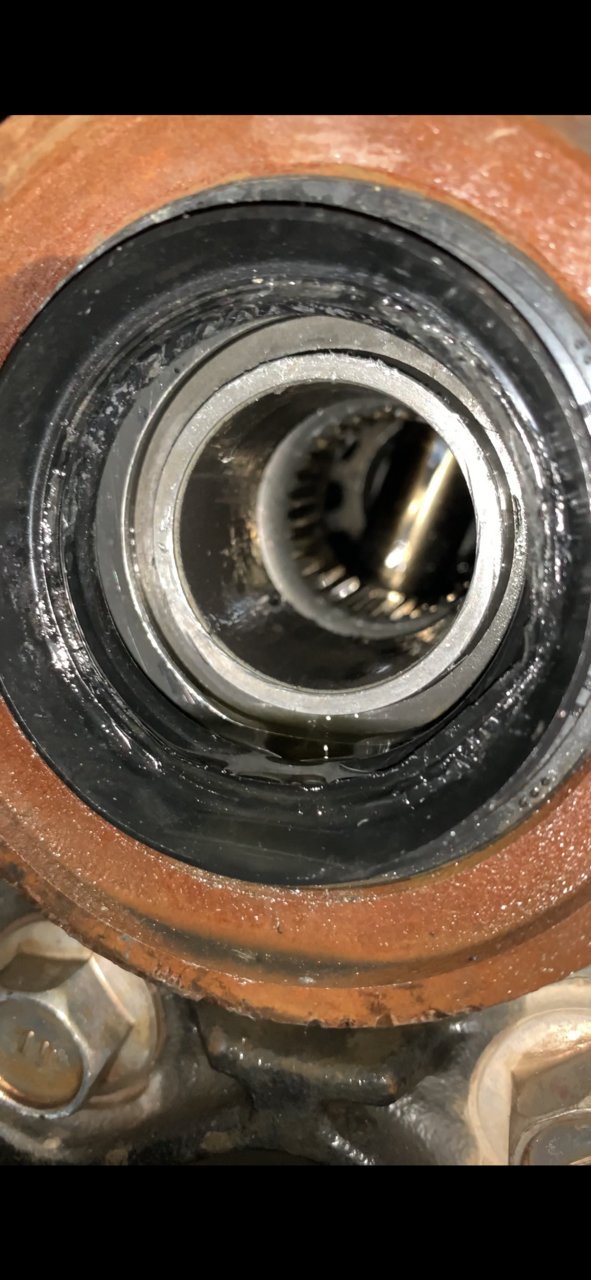

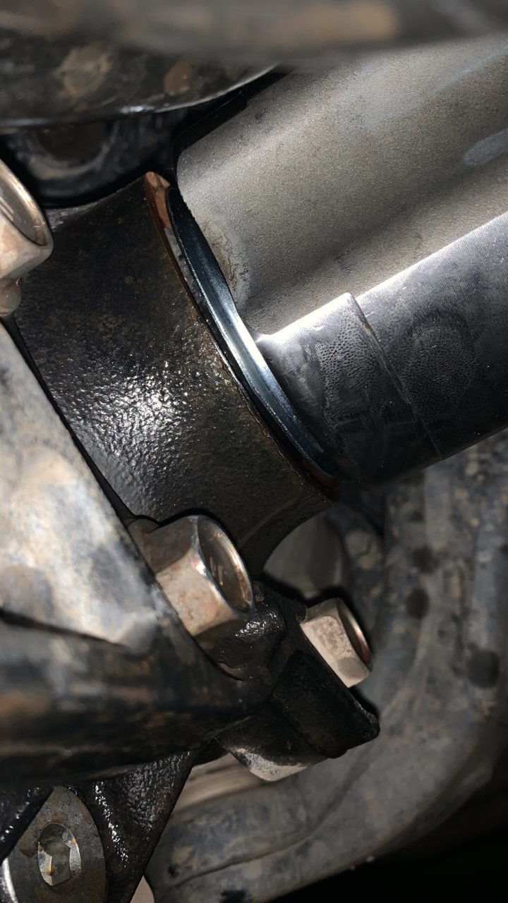

    For those curious, I was able to get it “fully” seated eventually. Sticks out basically the width of the outer lip so that’s within tolerable range IMO. I don’t have any success photos but here’s the before.
    how far it was sticking out this morning:
    this caused the axle seal flange to stick out just a little:

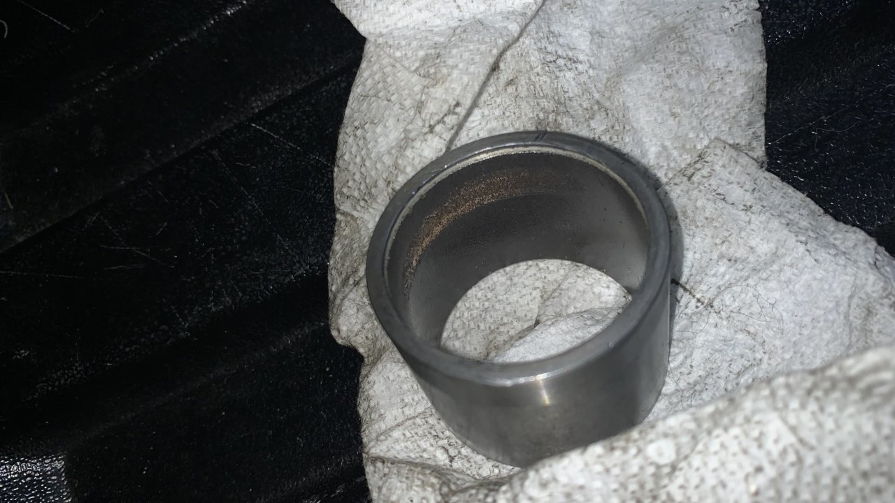

    one final question. Because I had smacked it a bunch with the seal driver, there was a little wear on the inner bushing: 22AE02A0-DC70-4688-8BF7-414785A1705A.jpg
    Is this bad?? Will it affect the life of the bushing? It still felt smooth to the touch. I haven’t driven on it yet, but I’d really rather not go through the process again :bananadead:
