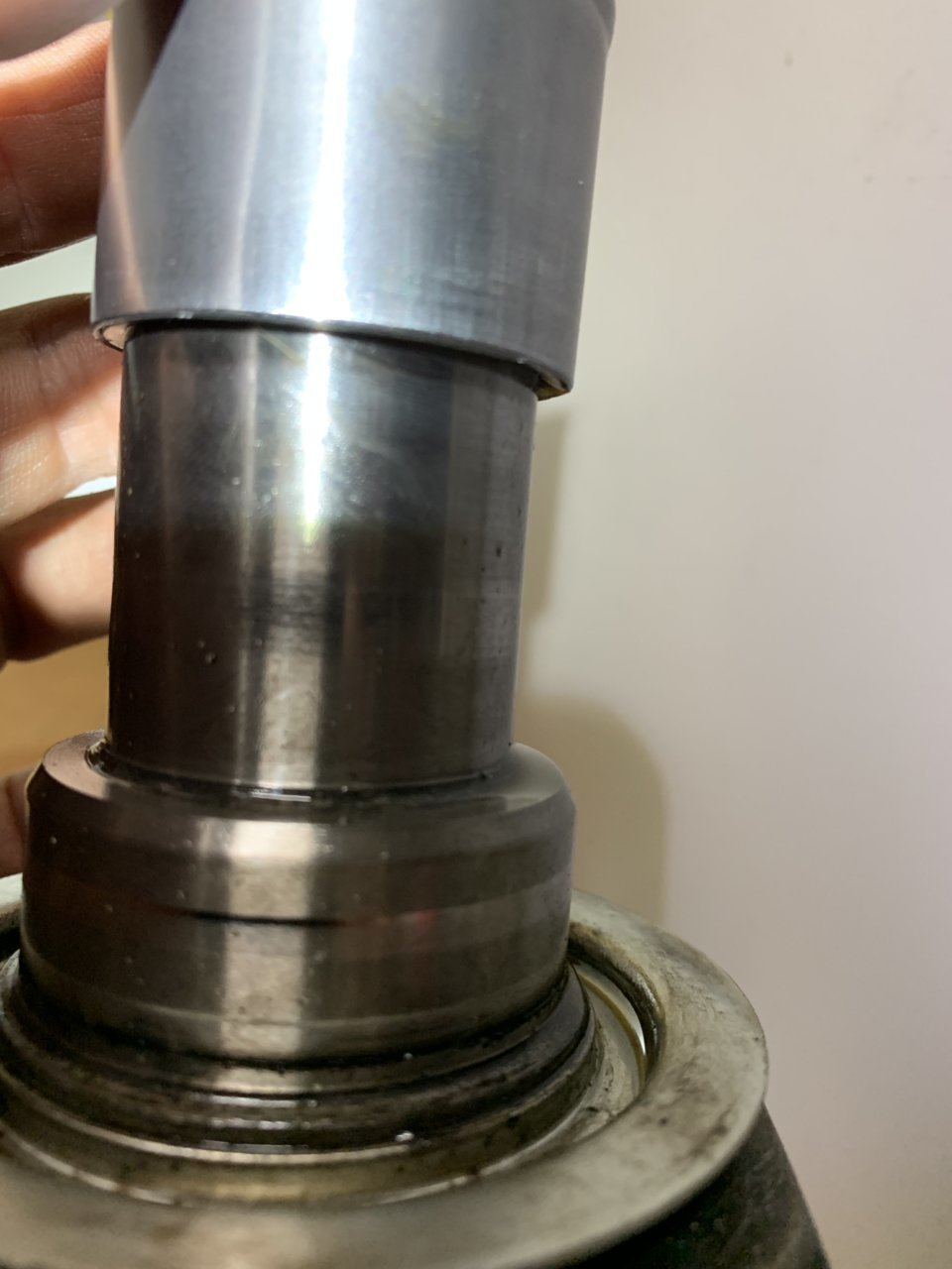

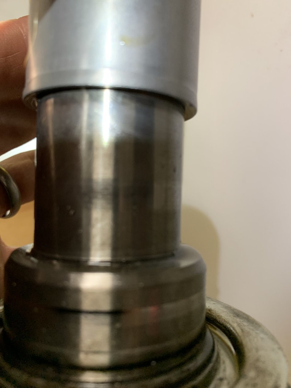

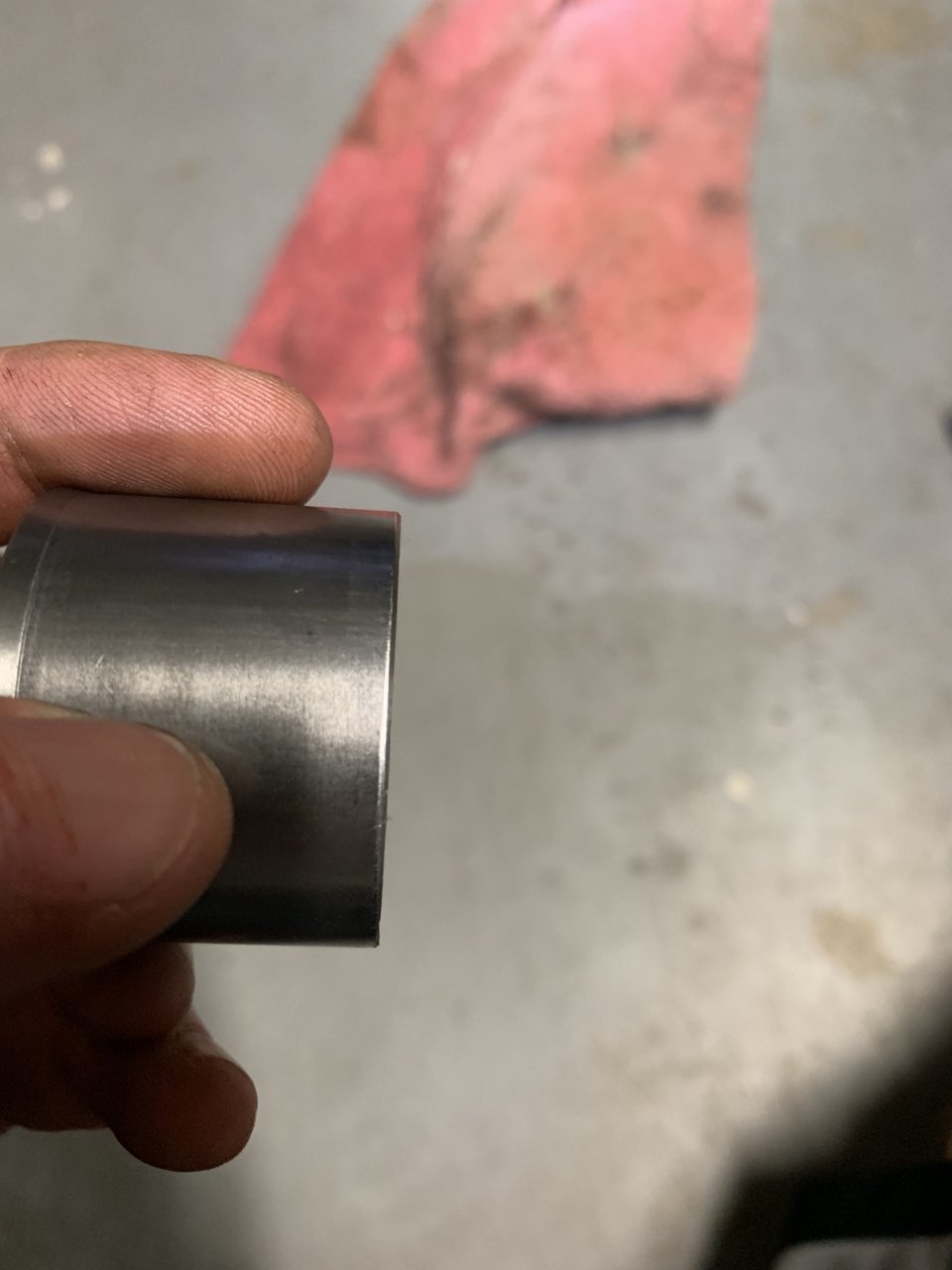

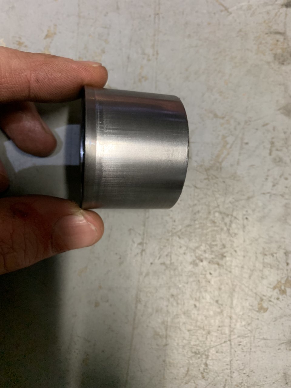

    Alright, an update. I got a collet style inside blind bearing pull and carefully set it up and pulled the bushing out. Here are some pics, I was able to flip the bushing around and start to slide the bushing over the side I used a socket to drive but NOT the other side at all. Looking closely, you can see some kind of line on the inside edge of the bushing. Its possible I caused this with stress attempting to remove the bushing but I doubt it. There seems to be a clear “impact line” on the side from whee Id guess the half shaft was stopping inside the bushing
    Simplier terms: if I could start to slide my half shaft in from the outside edge and get further than the inside did, I dont see how I beat it out. I didnt push it down hard so it might have stopped still, but it certainly sat deeper than the other side did.
    I ordered a new bushing from ECGS, but I will be honest I am not happy with their customer service. I have called several times and never got anyone to pick up, and I left them a voicemail on Saturday and didnt hear back.
    Im a reasonable guy, maybe I did it? But I have a sneaking suspicion it wasnt in spec
    Edit to clarify pics
    Inside edge on left, visible “line”
    Outsidge edge on right

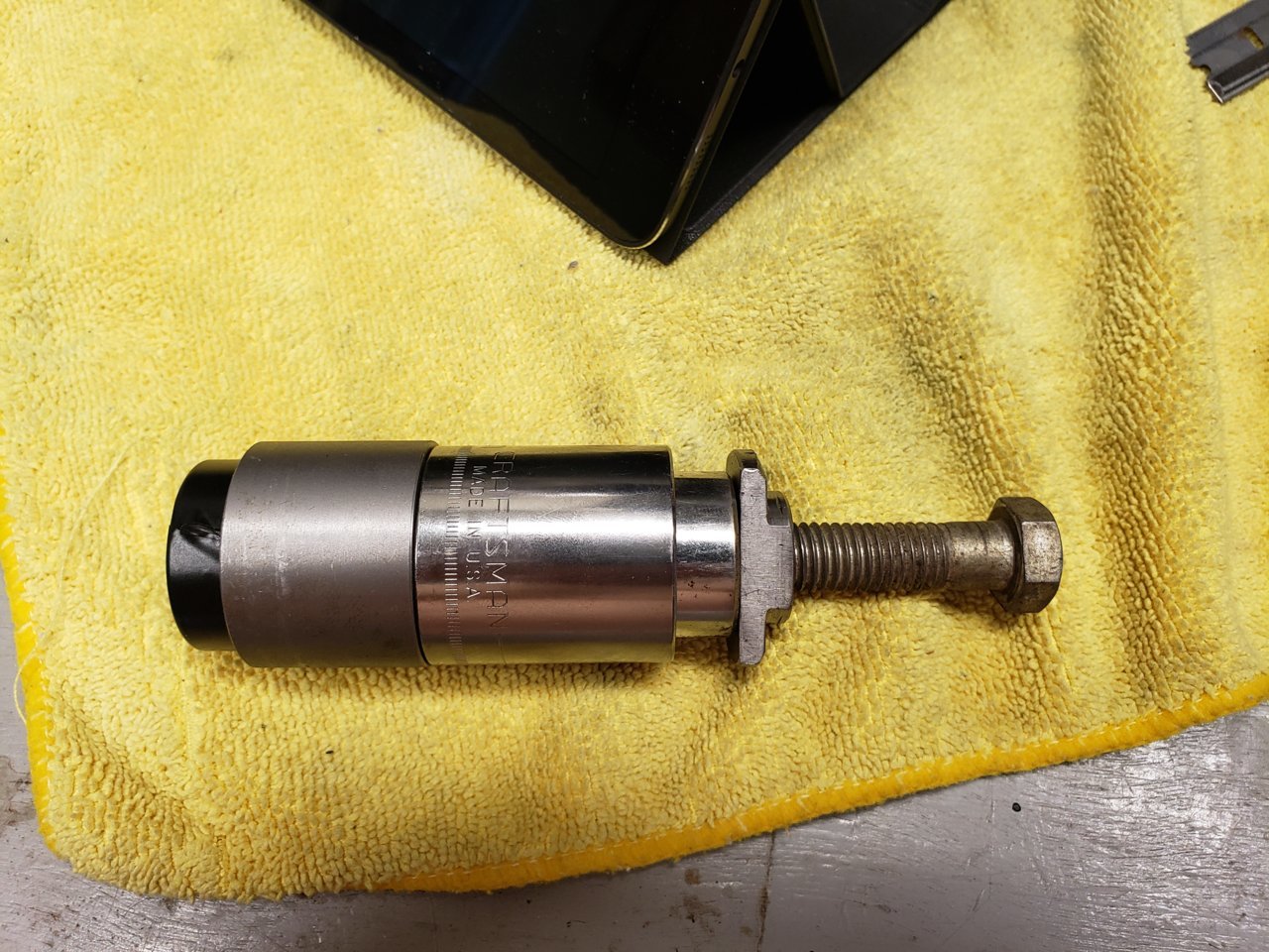

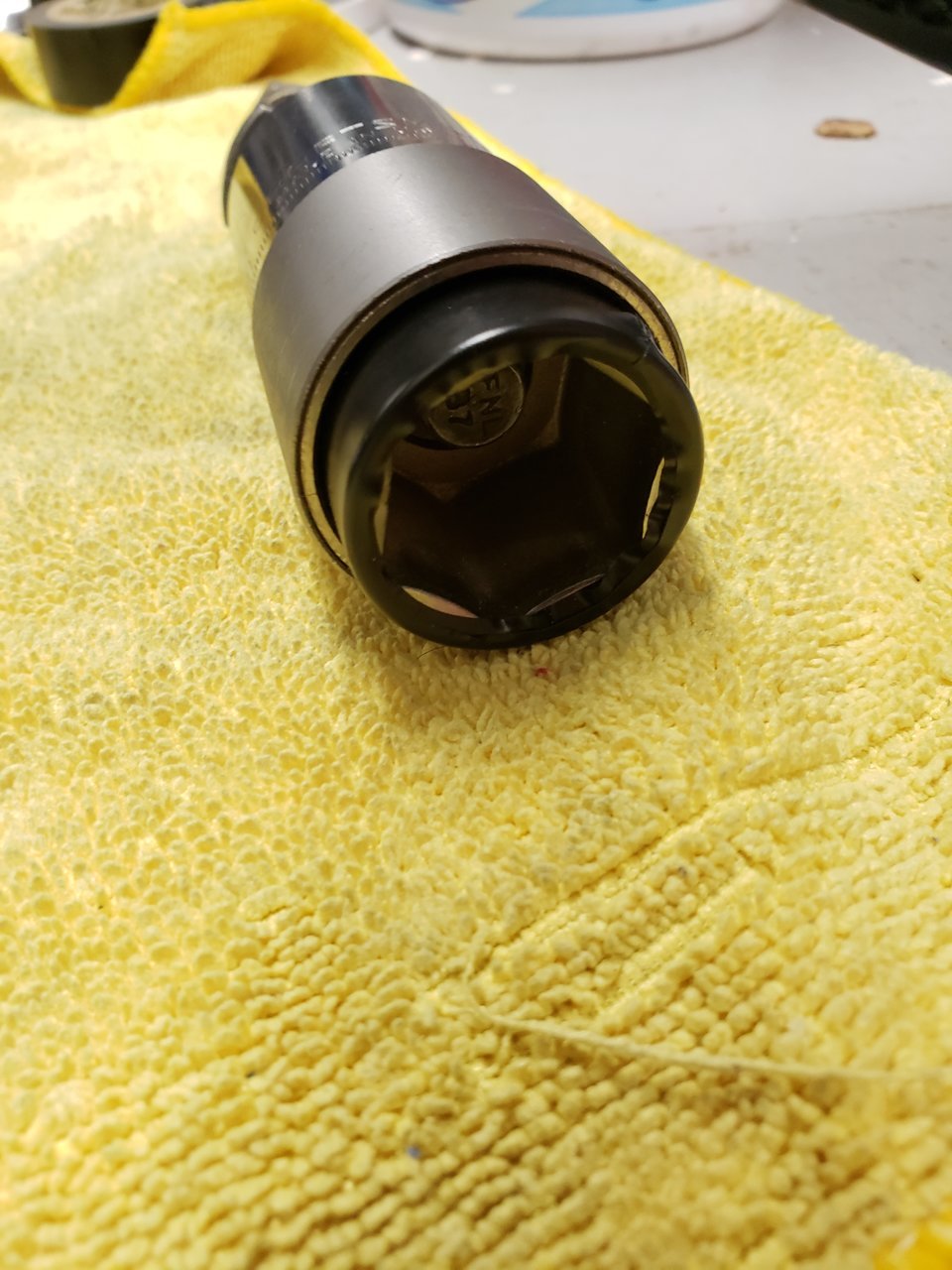

    I used sockets and electrical tape on the removal tool to drive my bushing in. No issues, I did have to downsize the inner socket and use a little more tape wrap than pictured but you get the idea:
    Might add the bushing is designed directional, it's to be driven from one side only, the lipped end goes inward
    lo2hi and CaptainBart45 like this.
