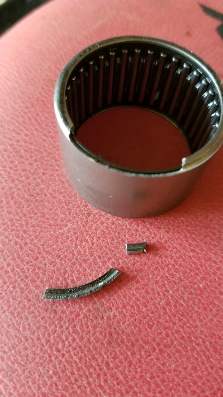

    If you are putting a ECGS bushing in, be careful installing the removal tool. Picture shows where I followed the instructions and just gave it a little tap tap when the little tool piece was being put into place to pull the old needle bearing out. I only tapped it lightly but I guess that was too hard. I pulled the needle bearing out to find I had broken off a small piece of the bearing. Oh shit! I took a small magnet and retrieved 3 small pieces that fit together to show that I luckily had got it all. Then I removed the plastic bag I had stuffed inside. Whew! Close one.
    I post this for anyone doing this to give a heads up. I should have just continued to wiggle the part around until I managed to get it in position. 20190705_124201.jpg

  8. Jul 5, 2019 at 12:27 PM
    #28
    b_r_o
    b_r_o Gnar doggy
    Nov 17, 2016
    #202672
    14,273
    Alex
    WA
    2015 DCLB
    Yea thats sketchy, dont want to leave broken pieces in there by accident.
    I had to modify the tool that i used to fit fully behind the needle bearing, its definately a tight fit

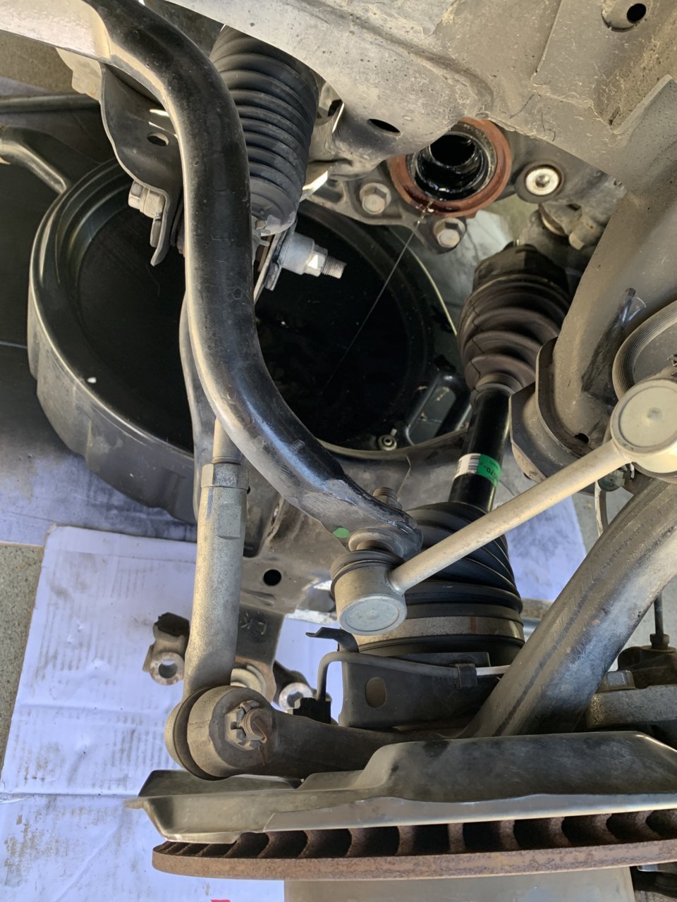

    I've actually just been told that I can do it without removing the entire CV. This is a pic that someone else sent

    Well I never knew... First I have heard of that. Is it difficult to swing the steering knuckle out far enough to do it?
    I replaced my CV shafts at the time so I had it all broke down anyway.
  13. Jul 23, 2019 at 3:41 PM
    #33
    Minimag95
    Minimag95 Well-Known Member
    Nov 8, 2017
    #235456
    1,655
    Niles
    Annapolis, MD
    2009 Pyrite Mica V6 SR5 4x4
    OME's w/ 887 Coils, SPC UCA's, 285 ST Maxx. Mobtown sliders & skid
    I'm not sure, someone else sent me that. I'm gonna try it though
  14. Jul 23, 2019 at 4:06 PM
    #34
    Dalegribble02
    Dalegribble02 Well-Known Member
    Apr 27, 2019
    #291535
    1,368
    Savona British Columbia
    2014 SR5 4x4 meg grey sold
    Dobinson mrrs Deaver leafs archive garage hammer hangers.
    I did my ecgs bushing without removing my CV from.the knuckle ezpz
    Minimag95[QUOTED] likes this.
  15. Aug 1, 2019 at 11:14 AM
    #35
    503TRD_22
    503TRD_22 Well-Known Member
    Jul 30, 2019
    #300701
    110
    2017 DCLB-OR
    Every mod imaginable.
    How hard was it to swing the knuckle out of the way, @Dalegribble02 ? I bet that saved a decent amount of time..
  16. Aug 1, 2019 at 11:38 AM
    #36
    Steve_P
    Steve_P Well-Known Member
    Sep 16, 2009
    #22854
    751
    TN
    09 Tacoma SR5 4WD 4cyl
    I'm not Dale, but I assume he turned the steering wheel all the way to remove the LH axle without breaking the steering knuckle free. I've done this on other vehicles if just doing CV boots or a transmission output seal.
    edit- on some vehicles you need to at least break the ball joint
    I was also changing wheel bearings so I broke my Tacoma pretty far down.

  19. Aug 1, 2019 at 12:46 PM
    #39
    Dalegribble02
    Apr 27, 2019
    #291535
    1,368
    It wasn't bad used a bunjee cord to keap it out of the way
