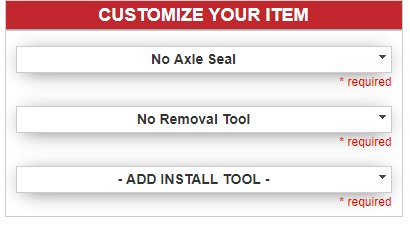

    Does anyone know what the 'axle seal' option is for when ordering? Is this needed?

    It can be , Many don't need one unless you cut it when removing the bushing. Better to have one on hand just in case. get the size right.

    It is a garlock type seal, rubber with an inner lip using a spring to keep the inner seal lip in contact with the CV bearing surface.

    Understood. Thanks bub!
