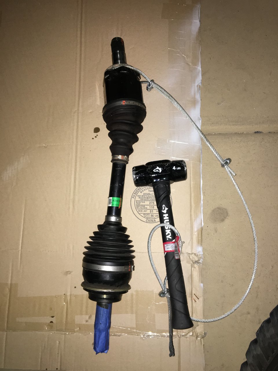

    I had to smack it with a hammer to get it back in.
    This is what I used to get the axl out. Some come out easy, others not so much.

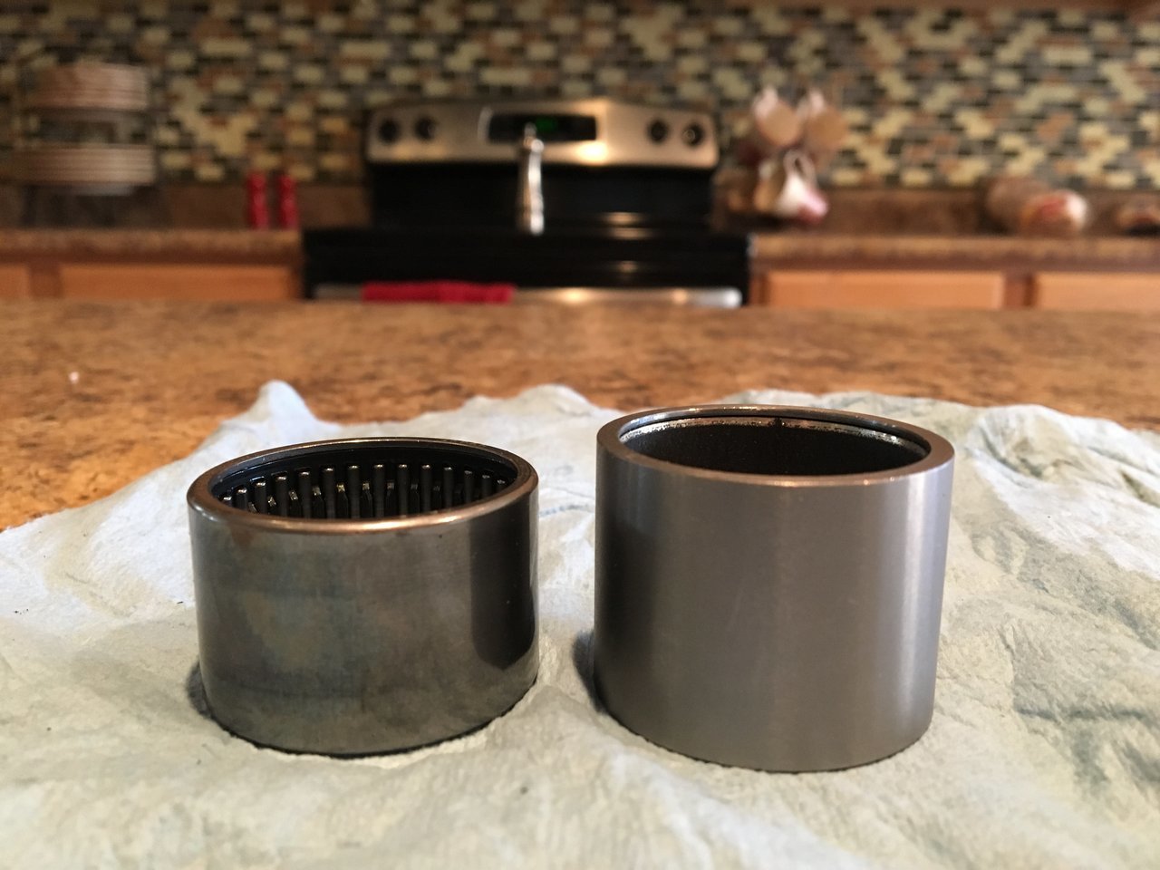

    Here is the difference in the two (ecgs) on right.

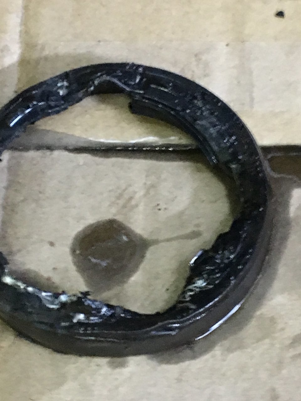

    Make sure you put something in there so the tool doesn't drop in there (paper towel, egs uses plastic).

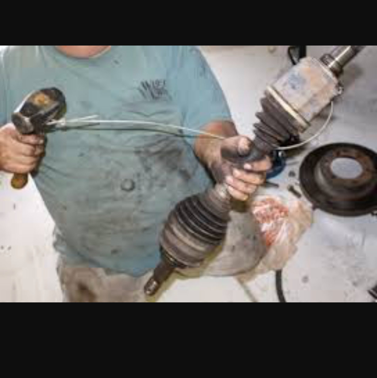

    A slide hammer , which you can rent works similar to this
    https://youtu.be/ZZ5JSWu6mTE

    Vibes are gone and no leaking. I used a new seal. Buggered the old one getting it out.
    I don't think people realize how much play is in there until you see the 2 side by side.

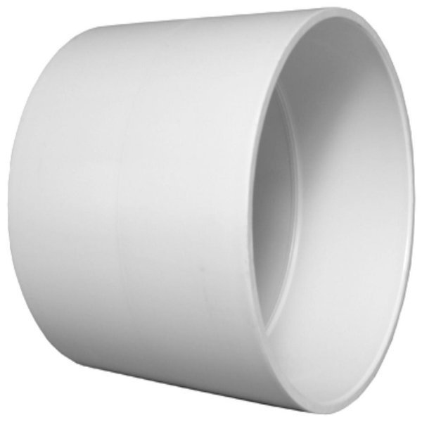

    This worked really well to get the new seal to seat correctly.
    I think it's 2" coupler/pvc

    The pvc is a better option in my opinion to install the seal
