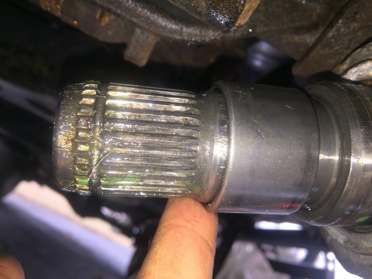

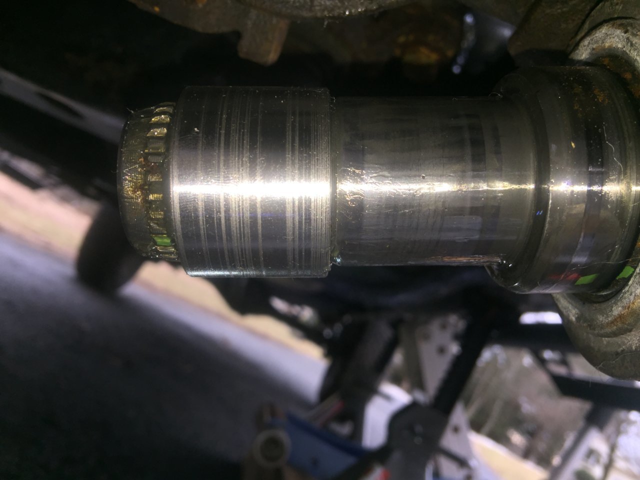

    The weather finally let up this weekend for this install. I was all pumped to get this over with. And then this.

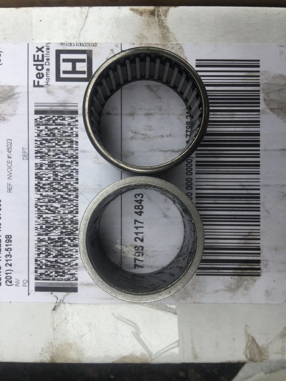

    The bushing is clearly smaller than the needle bearing. The needle bearing slide further back into the shoulder. The bushing got stuck at the spline.
    bushing too small
    needle bearning
    Can anyone tell me what I am doing wrong? @ECGS

    Did you check inner diameter of the bearing and the bushing? That'll be a quick tell if they are the same size

    I’d say they sent the wrong part possibly.

    The ID def seems to be the issue, ugh man sorry to see this, unless you have another car might be a repeat.

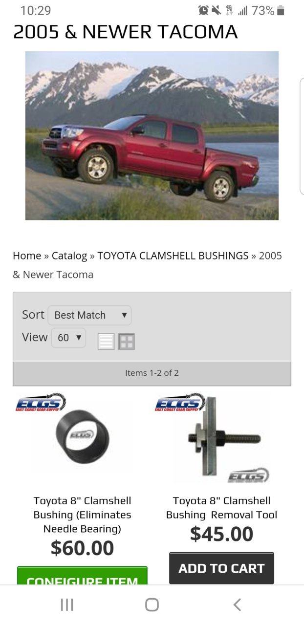

    That sucks. Call ecgs first thing in the morning. They can and will overnight you the correct part.
    I'm amazed they sent you the wrong part. On their website under 05+ tacoma the only option for bushing is the 8".

    As others have said it's the wrong bushing. Just replaced mine a couple weeks ago on my 2017 and had no fitment issues. Heres the part I ordered for the 8"
    Item: Toyota 8" Clamshell Bushing (Eliminates Needle Bearing)
