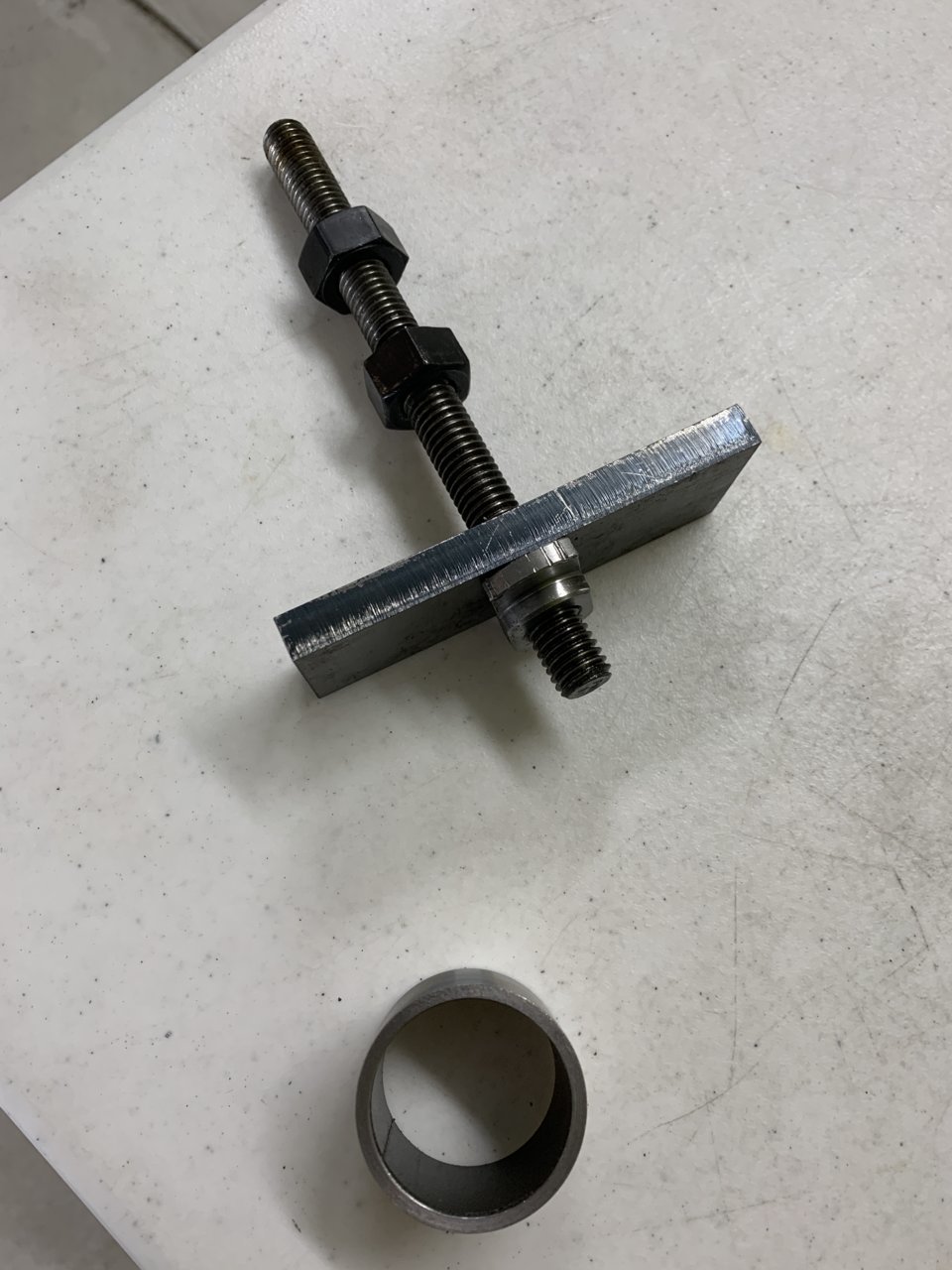

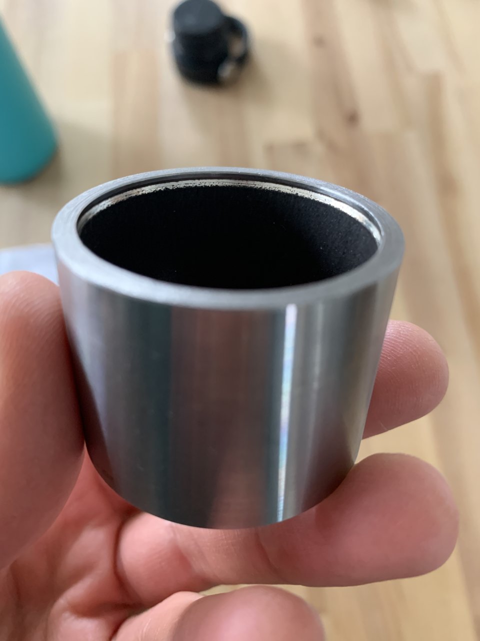

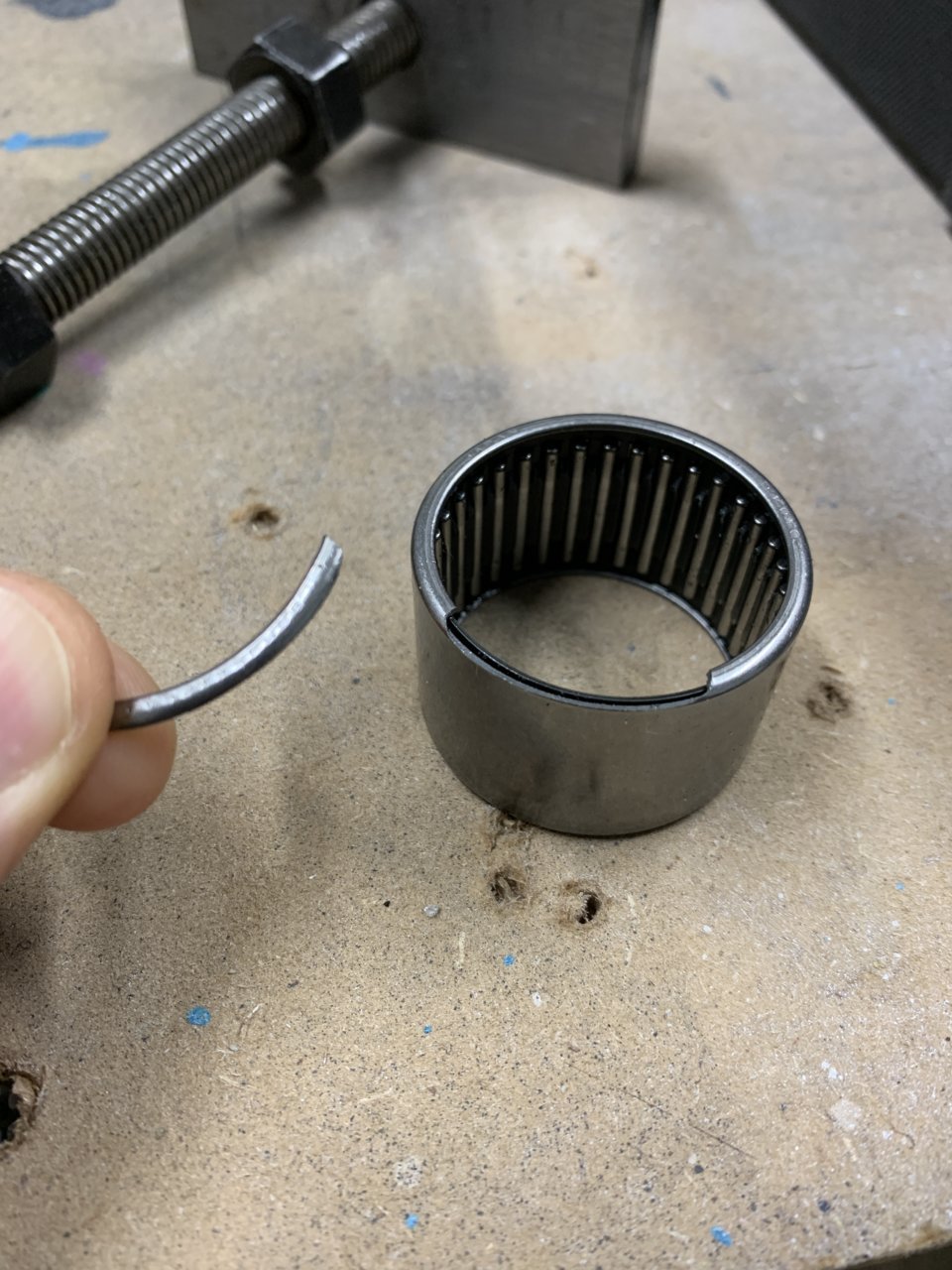

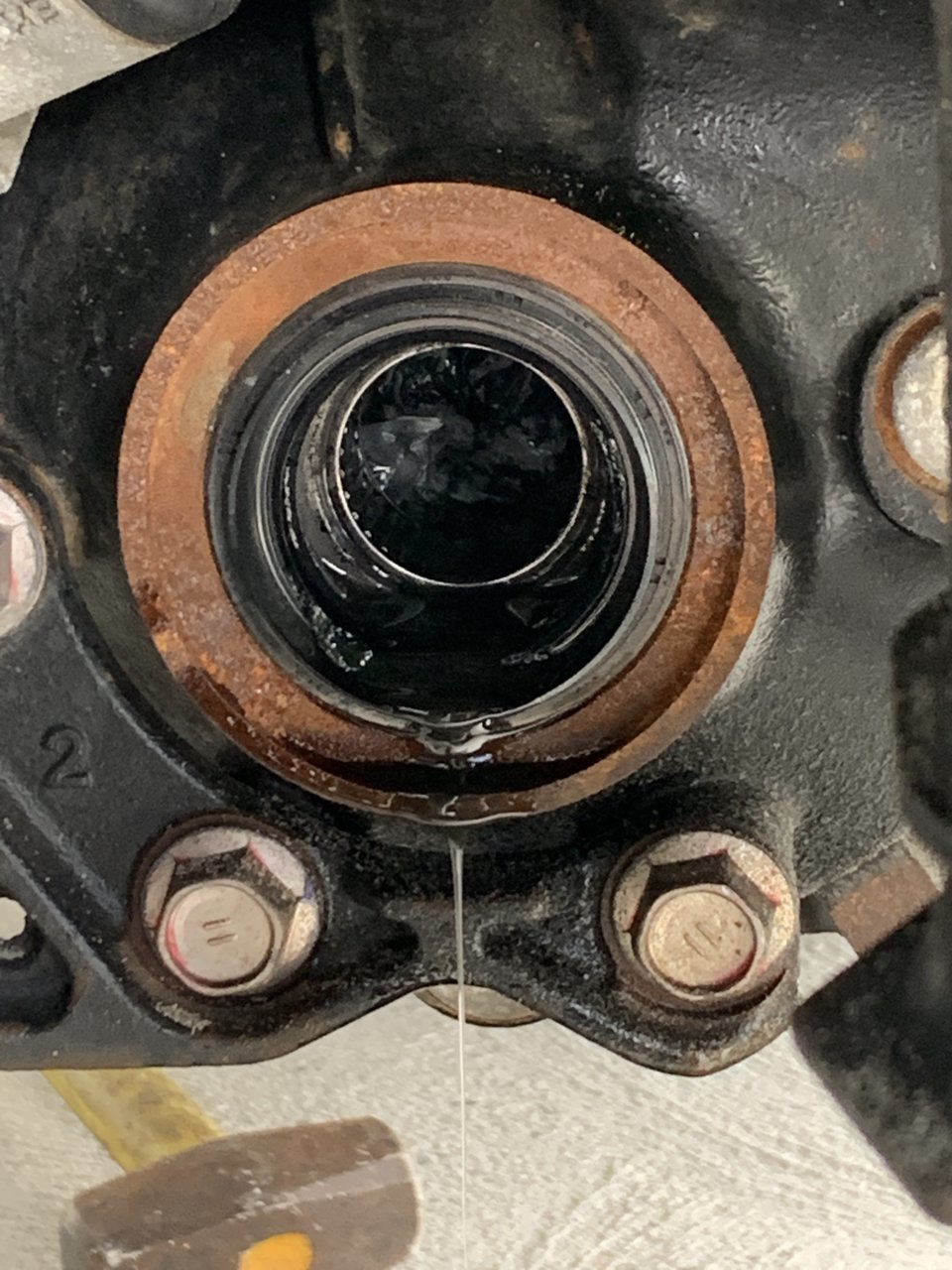

    Update, did the install, pretty good video tutorials out there which takes the guess work out of this DYI. 100% fixed the vibration. Not that more chatter or images are needed, but just wanted to confirm another success of this part fixing the issue. NOTE: When tapping in the tool it broke off a piece of the needle bearing rim, had to fish out with a magnet. I'd say keep an eye on the removed bearing and make sure its fully intact before continuing. Found this video the most helpful: https://www.youtube.com/watch?v=m9W31KGy6k0

    I lifted it using the 6112 front on 6/5 clips and the 1.5 AAL with 5160 rears the other day and first test drive it instantly was vibrating. Overall I only got about 1.5"ish lift from stock and it vibrated first drive and first week. I ordered the ECGS bushing immediately when it was vibrating and took a few days to get here. I would highly suggest for anyone doing a full suspension lift themselves to just order the bushing in advance and do it while you have the front opened up. Its a simple install if you are doing a lift yourself you can easily do it as well. $60 bucks for the bushing, borrowed a buddies tool that he had bought when he did this as well. Only thing I had issue with was tapping the new bushing back in, def recommend borrowing the bushing driver tool or making sure you have a socket that is the same size to make tapping it in easy.
