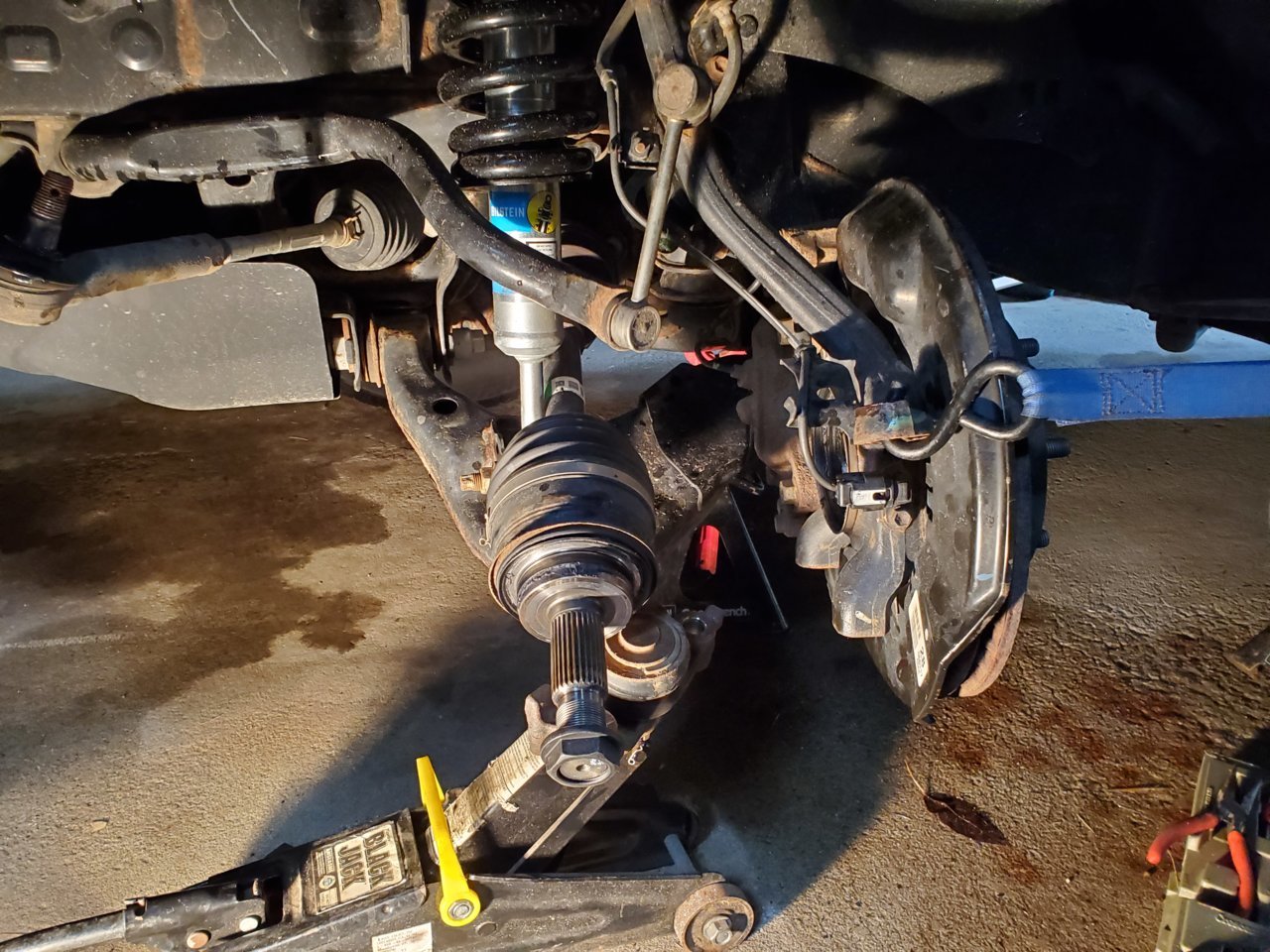

    I dunno, this before/after looks pretty effective to me:
    Diff drops kits are pretty cheap, and yeah you're trading some clearance but even with it dropped I imagine your front diff sits higher than the rear pumpkin does, no?

    Those aren't even the same coilovers in the two pictures, so ride height changed from one picture to the next.

    Looks like 2 totally different trucks to me.

    You're right, I didn't read the thread closely enough :)
