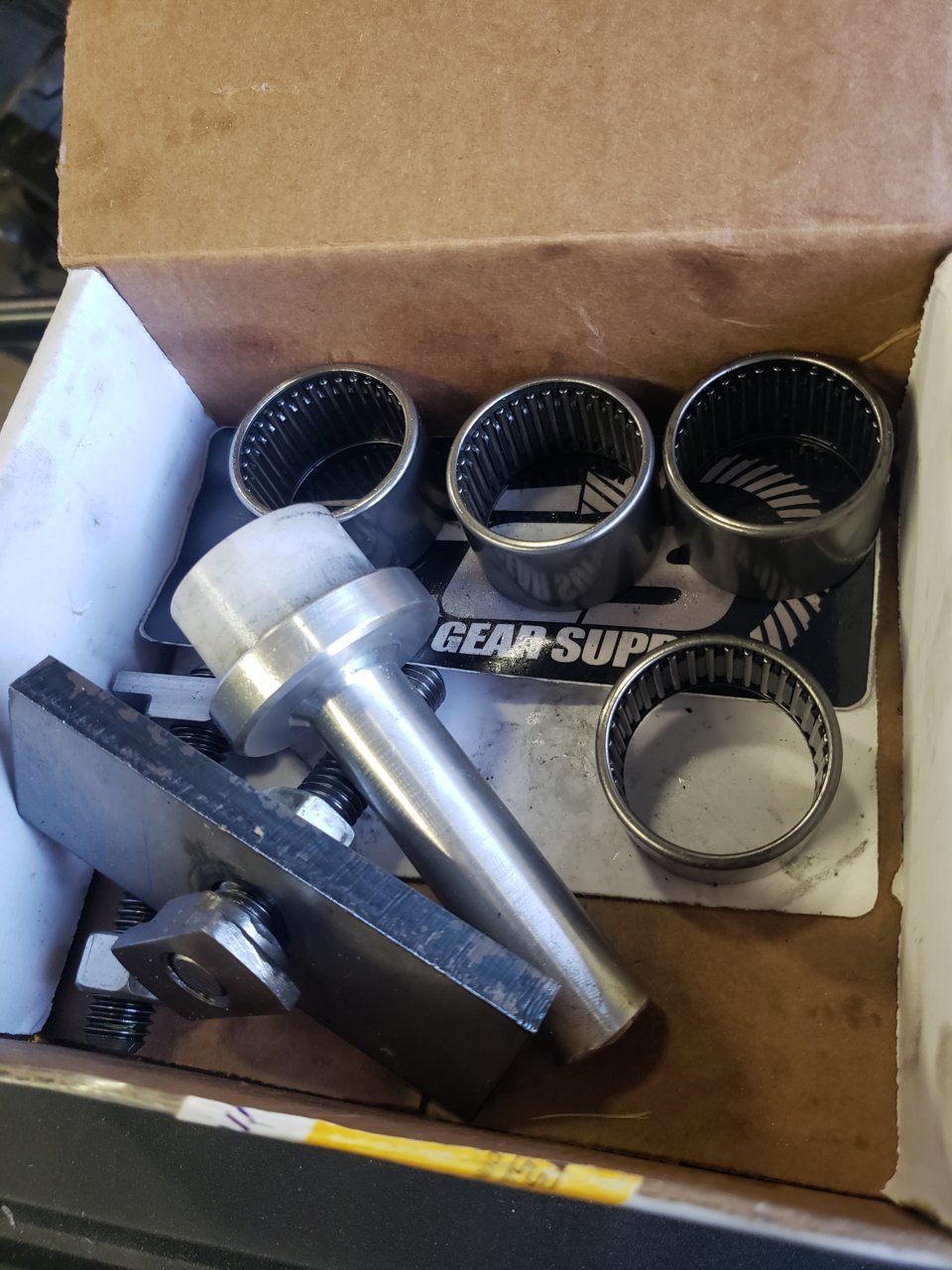

    Hey Superdave1.0 sounds like you are pretty familiar with this install, what advice do you have for a first timer doing the needle bearing removal and bushing install?

    Not an easy task. If you have pulled a cv axle out before, then it won't be too bad.
    Buy the removal tool from ecgs
    Buy the install tool from ecgs
    Buy an axle seal just in case
    Need 2 quarts of 75w-90 gear oil
    At your own risk. Use jack stands
    Remove LF wheel (place under truck)
    Remove axle nut
    Remove 2 lower spindle bolts
    Remove sway bar link from spindle
    Drain front diff
    Remove axle
    Place plastic into diff opening (large ziplock)
    Remove needle bearing with ecgs tool
    Install ecgs bushing straight with proper orientation
    Reassemble. Torque everything to spec
    Refill diff. Torque drain and fill plugs to spec

    I have an adapted one with a larger bolt. I reckon’ that lil stubby one east coast gives is enough, but just barely. I’m not with it atm, will be a couple months most likely.
    Also, @Superdave1.0 .. great write up. Seems simple enough. Just got through with mine and boy oh boy that CV axle is a fun go. Centering the C-clip for install helps, and rotating to find its position when removing I guess is the key.
    Also, why buy the installer? Any the auto stores that rent tools have a race bearing installer for free.

    Thanks, but trying to get it done in the next week when the bushing arrives.
    Race installer? you mean a properly sized impact socket and a dead blow hammer?

    Pretty much. I searched through the junk pile of PVC an couldn’t find one to fit (2” I think?), nor had a socket that size. Plus I was grabbing a bunch of other things, but yah. You got it jackson.
