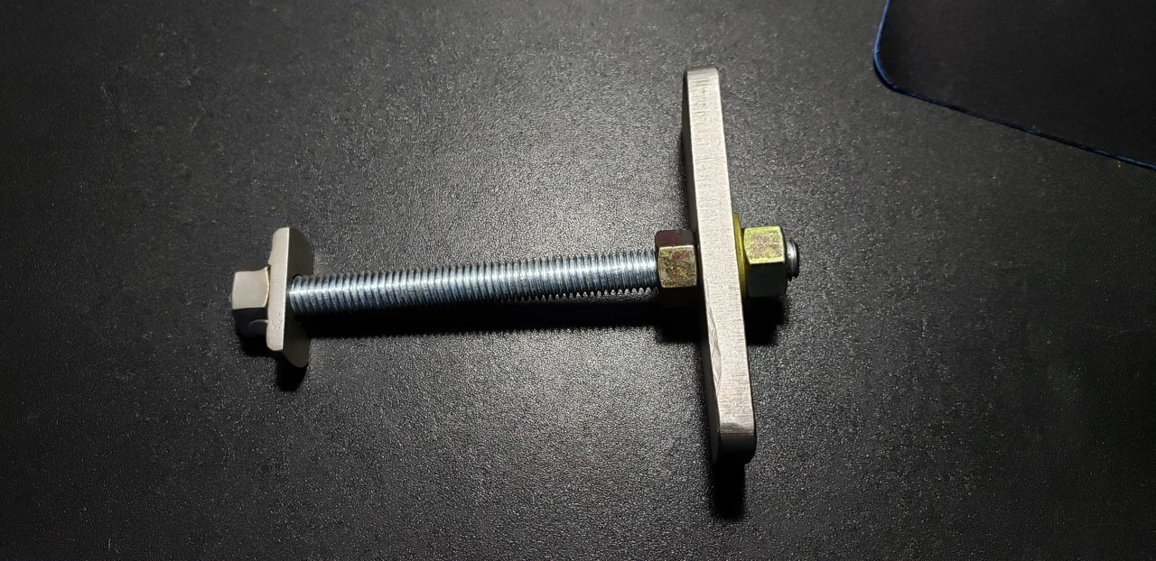

    Speedfreak
    Speedfreak Member in poor standing
    Sep 22, 2017
    #230756
    4,918
    Dave
    Canada Eh!
    2017 Tacoma TRD Sport DCSB 6MT, Blazing Blue Pearl
    Manual Mall Crawler
    I just made one. It is untested. I will be doing my lift and bearing on the 8th 9th of March. After that I won't need it, so I was gonna make it available to TW members. 20220220_190045.jpg
    Montana_Actual and CygnusX191 like this.
