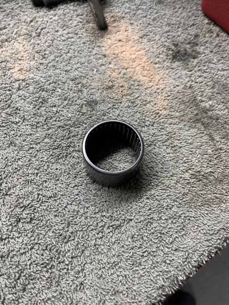

    Just replaced mine over the weekend. I lifted with some Toytec Coilovers around 2". Immediately got vibes. Here is the bearing I pulled out. Completely intact. Had tons of play. I ordered the Yukon bushing (instead of ECGS, although I think they are the same supplier).

    Did your vibes go away?

    100%

    The hardest part for me was getting the axle out. The tool I bought, worked perfect. Instead of dealing with dripping gear oil, I opted to change all of it. New bushing went in pretty easy after a few hours in the freezer.

    Pretty much, once you see it move a little that's probably the sweet spot. I watched about every video on youtube prior to taking this on. I ended up not being able to locate a 35mm socket for the axle into the hub. One guy on youtube did it without pulling the axle out completely. I just followed his guide loosely. Basically popping the axle out of the diff, letting it swing down gaining access to the needle bearing. I was super worried about breaking the bearing, but mine came out in 1 piece.
