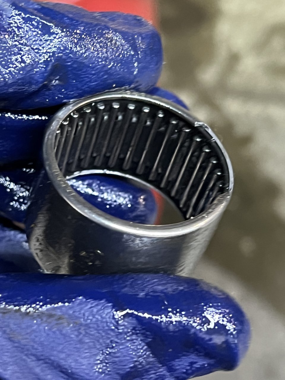

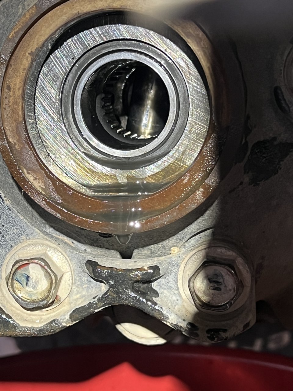

    2 weeks ago I was driving to work and after taking the truck out of four wheel I noticed a rumbling feeling on decel. Felt like I was running over some weak rumble strips but it was still very obvious vibration wise and audibly.
    Did some reading that night and found the forum about the ECGS 8” Clamshell Bushing. Figured that was the issue I was having.
    I’m a Ford technician and the dealership I work at has a Toyota we share a shop with so after talking to a couple guys we all figured that it was the needle bearings taking a dump. My parts dept actually stocks the ECGS solid bushings and the other guys in the shop had the removal tool.
    Was a smooth process overall. You can see the needle bearing sleeve broke off from tapping the removal arm in to place so I had a small single piece I had to fish out but I also ripped about 1/3 of a shop rag and stuffed it inside as well from the start. Drove the new bushing in with a seal driver from my set from harbor freight..fits perfect. Drove it in til it was flush with the carrier.
    Re-Installed everything and no more rumble.
    Forgot to mention I’ve had the truck lifted about 2.5-3 inches for the last year before the issue ever arose. From what I hear if you never lift the truck it rarely goes bad.
