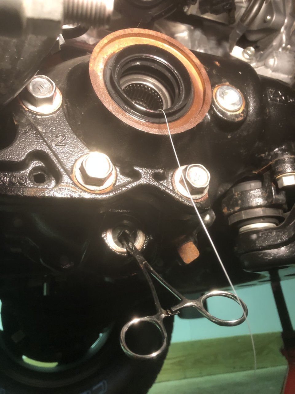

    It’s easy if you follow the YouTube directions, get all the tools and put a plastic bag in the diff so the tool doesn’t fall in. Or you’ll have to fish it out like I did.
    It “should” be a 1-2hr job at most and no more difficult than changing suspension.

    I had a member help me with my 2G and we didn't do the plastic bag trick and I was on pins and needles (ha!) setting the tool. I don't have nearly the calm enough hands to make it work. On my 3G I saw the plastic bag trick and it made all the difference in the world.
    I'd say it took my friend and I maybe an hour to an hour and a half in our first time doing it together. We are reasonably mechanically inclined and had all the necessary tools. With my 2G we did the full lift and I had the vibration and it was a kick in the teeth to need to tear it apart again. With my 3G I just did it with the lift so I didn't have to worry about it.
    That being said, I didn't set the oil seal correctly on my 2G which meant it leaked everywhere and I had the dealer rip it apart and repair it. With my 3G having 15,000 miles on it I took a gamble and didn't touch the seal and had zero issues.
