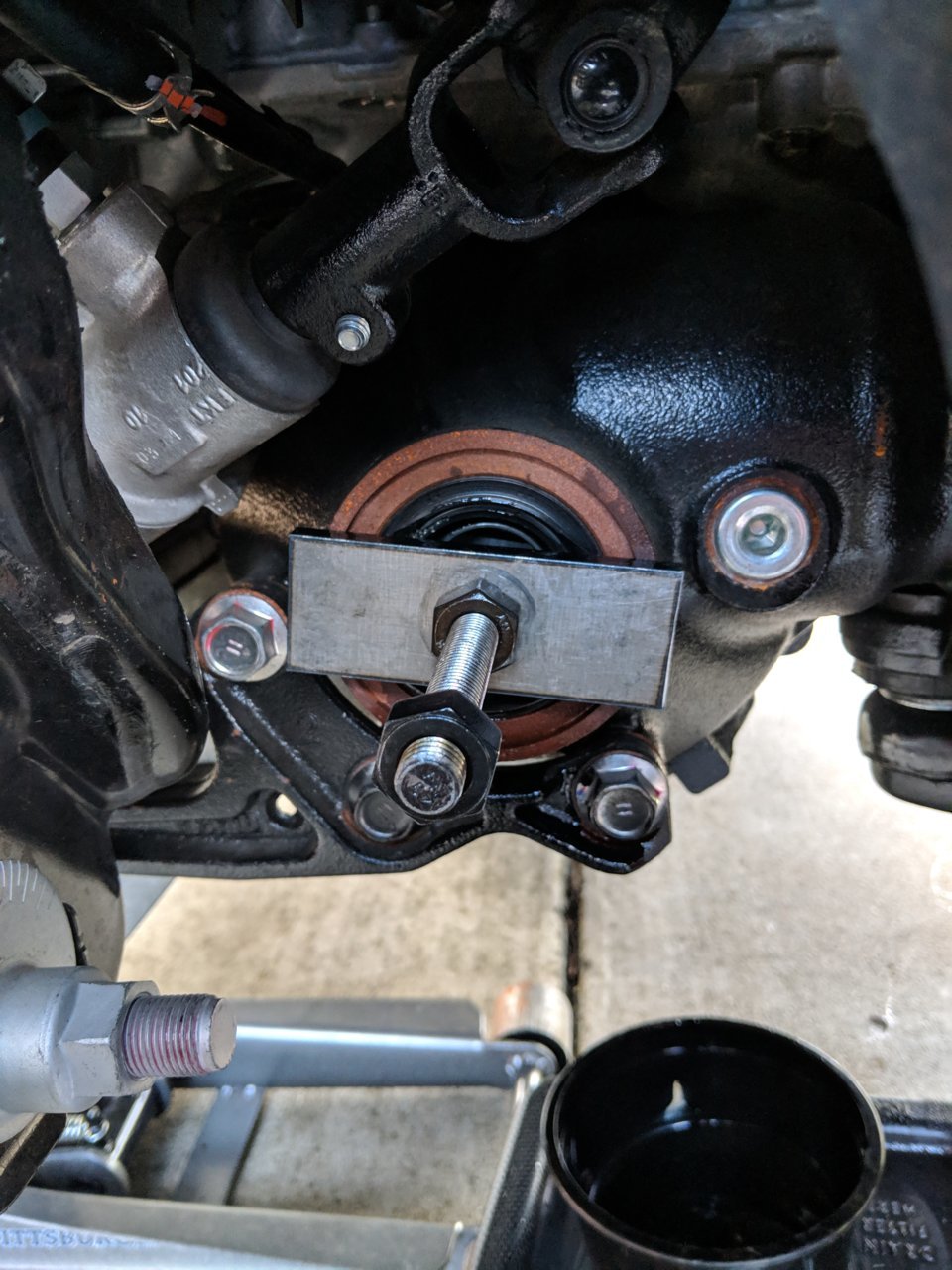

    Getting the old bearing out was fairly straightforward once I got the tool to fit and I found that a pair of vise grips worked well for holding the headless bolt while I turned the nuts with my newly acquired wrench. Pounding the new bearing in took longer than I thought because there wasn't much clearance to swing a hammer and it was tough to keep the bearing straight. Once I got the new bearing all the way in I thought I was home free until I went to pound in the new oil seal and damaged it on the crusty lip of the diff housing even after I smoothed it out with some emery cloth. Realizing it was a Sunday afternoon and any local place that carried a replacement oil seal wouldn't be open until the next morning, I threw in the towel on day one and cracked open some beers.

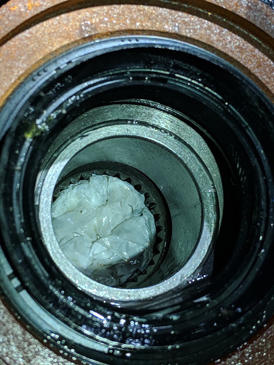

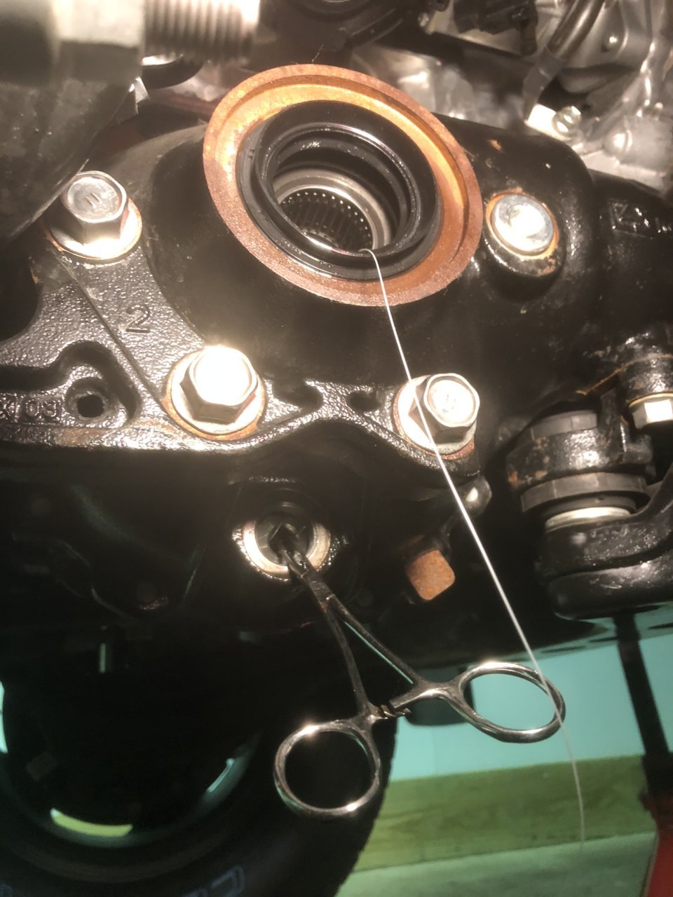

    The biggest mistake I did was not use the plastic bags in the diff and I dropped the end of the removal tool inside the diff. Not good, I had to use my fishing and fly tying skills to get it out. Dropped the line in and tied it to the end of the tool through the drain hole then pulled it back through the fill hole.
    Another thing, the tool really snaps in place between the old bearing and cv sleeve and uuu have to line it up perfectly vertical to thread the tool bolt into it.
