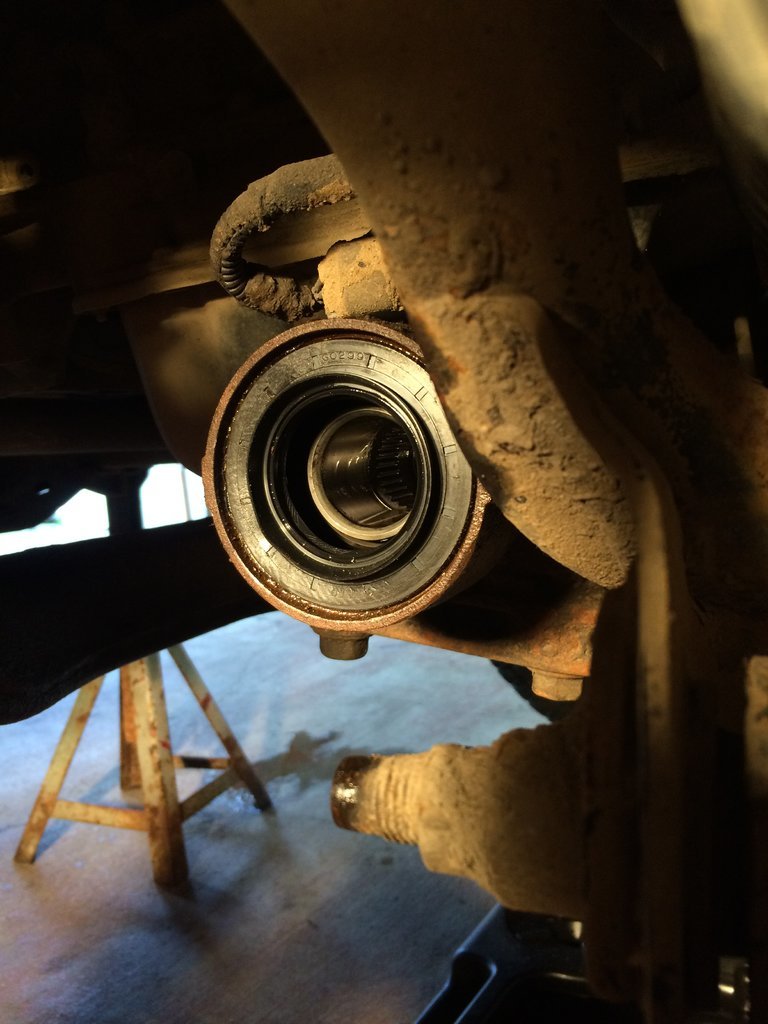

    It's driven in similar to this one, where the outside edge of the seal isn't flush

    Hard to see, but it looks like the outside rigid flange is flush with the housing, that lip does protrude outside. Don't know why yours is still leaking. I used a 2" PVC pipe adapter that I got at Sears for about $1.50 and drove it in slowly.

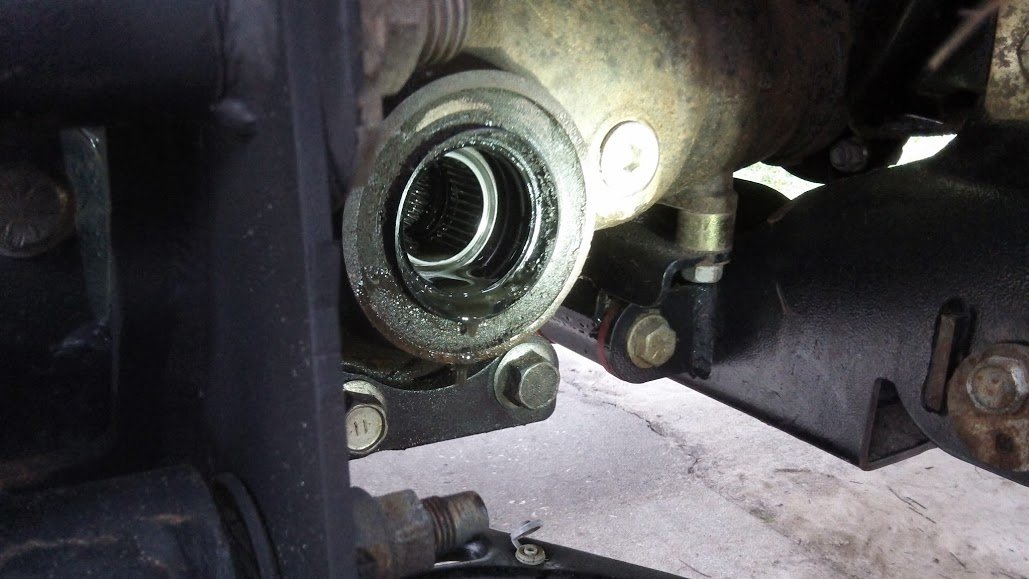

    I am doing mine tomorrow, this is what the leaking one looks like right now. I noticed the one I got (Timken brand) has a little smaller lip than the oem. Now I ordered an oem and I'll get it later today. I got a 2" pvc pipe too but I'll get a seal driver kit this evening because it is always better to work with the right tools. hope everything will be fine!

    Thanks that is encouraging! unfortunately the tool set I want is only available online so I won't have it for tomorrow, forget it... I'll use the 2" pipe, but this morning I had my old seal at work and took a look at the 2" pipes we have and the edge of the pipe sits right on the inside of the lip... wich is weird... So now I am wondering if I am talking about the same seal as you... My seal is the one on the passenger side axle, at the diff, obviously... are yours the one that goes to the front drive shaft?
    I've also took a look at our 2.5" pipes we have but those pieces are thick and does sit on the lip too.... At home I have a 3" pipe but this one sits too much on the edge of the seal... :annoyed: I honestly don't know what to do right now to avoid damage to my new seal.... I don't want to do it again lol

    Driver side
    Welp, mine's still leaking. Im hoping I just need to drive the seal in a little further. I fuckin wish ECGS provided some info on seal replacement. Im gettin really goddamn frustrated with this truck. Ive swapped motors in my Volkswagen with less headache than this fuckin seal is causing.
    The old, leaking seal -
    Driven in flush with the diff housing, leaked everywhere.
    Replacement seal, not driven as far -
    Still leaking. I drove it in to this point based on all the picture of the seal installed I could find online. The green is grease to keep the spring from popping off.
    Here's the axle -
    I wonder if the axle is the problem? There is 100k miles of wear on the axle. It isnt scored, and I cant catch a finger nail on any of it. From what Im reading, this is pretty normal wear on these axle. I also slid the seal over the axle and it fits tight.

    Looks like you installed the new seal in backwards.....

    anthony250f

    So does the little round spring face the outside (towards the hub) or the inside (towards the diff)?

    The spring is on the inside facing the diff
