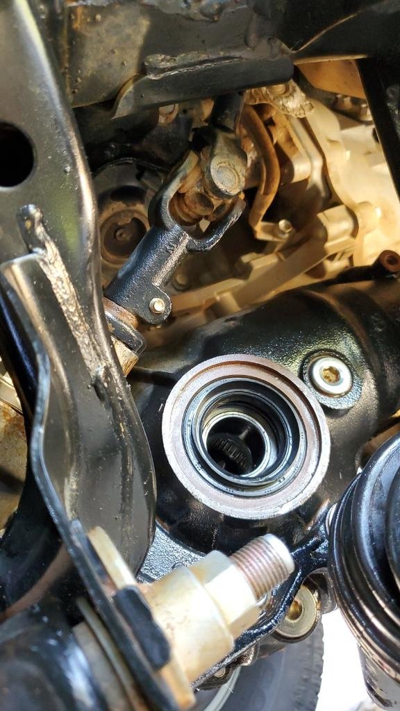

    7556FDEC-86E9-41C3-A532-0F4879868738.jpg Is this correct?

    The seal looks like it's in too far. The outer edge should be flush with the surface.
