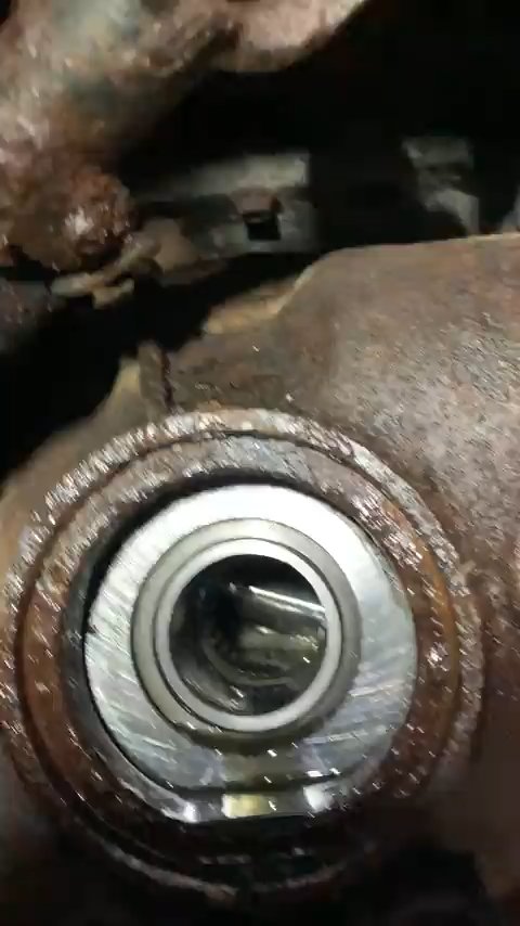

    Hmm . . . none as yet, that's why i'm here . . .
    First, I don't know how to load a video clip.
    Hope this is not too big.
    2008 Access cab V6 automatic 4WD.
    In the image you can see that the oil is seeping out between the outer part of the ECGS bushing and the housing, is this normal.
    My problem is with new bushing and new oil seal, oil is leaking out to the seal and being thrown around with the rotation of the axle. Causing the diff and surrounding area to be covered in oil, not to mention I'm losing oil and thats my problem.
    Is it normal for oil to seep between the outer of the busing and the housing?
    Thanks for looking.

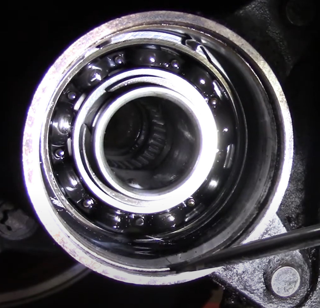

    then you’ve broken the seal in half
    this is what it looks like when the seal is removed
    jeminyned likes this.

    545 - you're showing the passenger side I'm working the drivers side. but thanks.
    And thinking over night my original question is still out there.
    Oil is seeping under the new ECGS bushing.
    Waiting to talk with ECGS guys.

    I fully understand that the seal keeps the oil in the diff.
    As observed when pulling the axle out of the diff some oil will run out but comes OVER the bearing (needle or ECGS) so when the axle is pushed back into the diff there is very little room for oil to run out and any that does is kept in by the oil seal.
    My problem and question is - oil is seeping out between the outer part of the ECGS bushing and the diff casting it sits in. So oil has more chance to come out.
