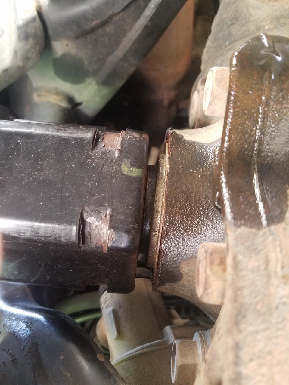

    Can't seem to get the axle in any further than this. Seems like it should go further but I've been beating on it for over an hour.

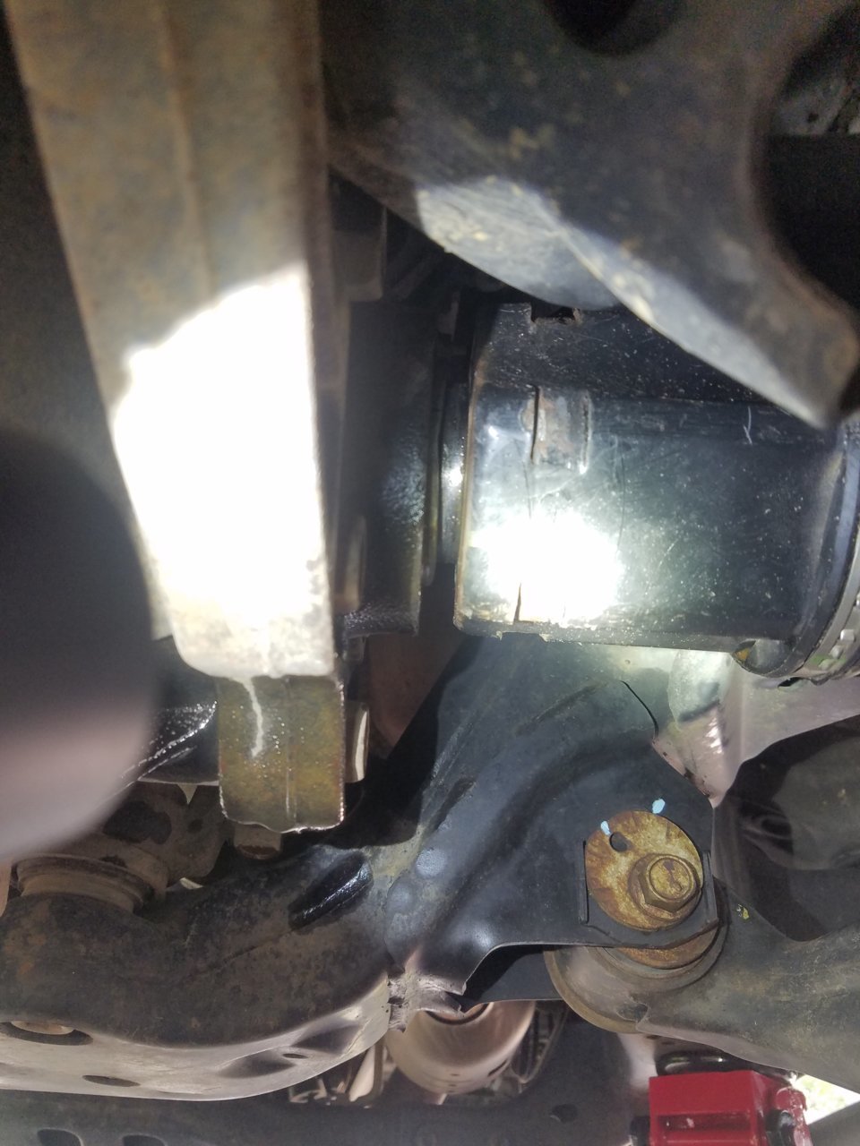

    Looks better now. Praying for no leaks.

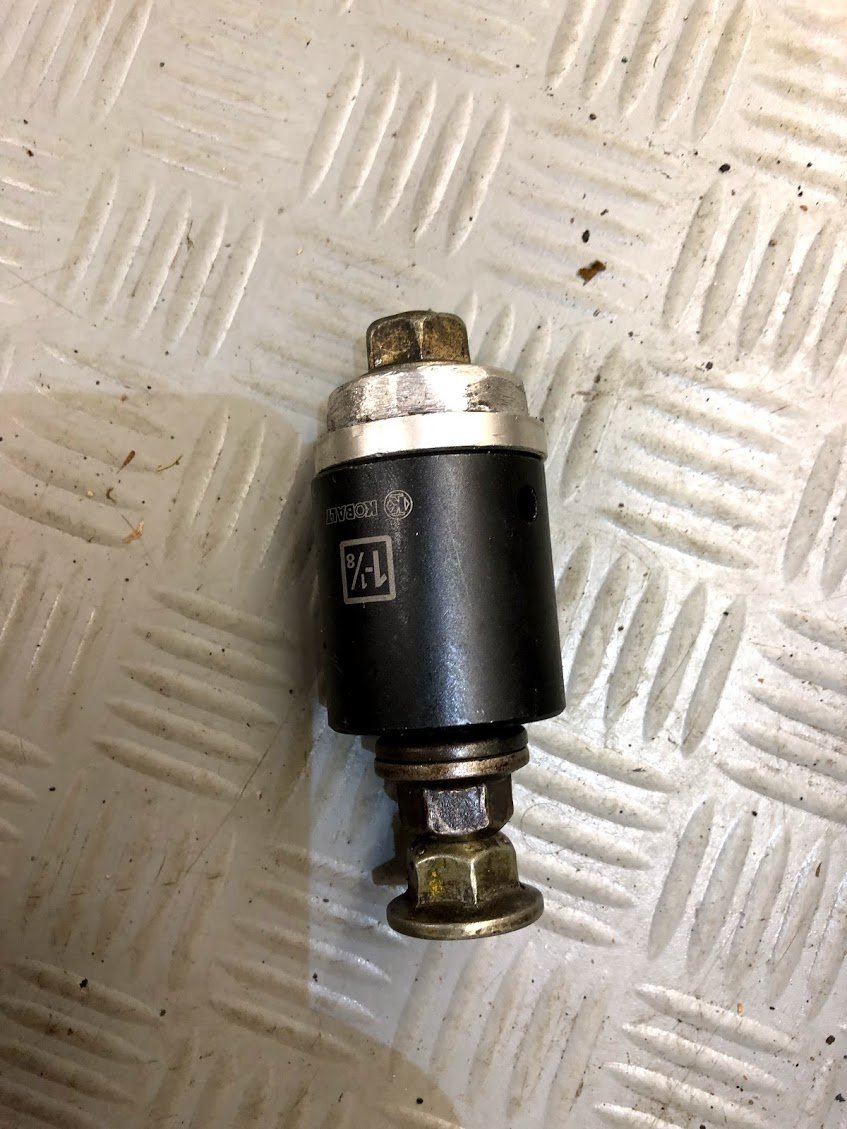

    Tackled this yesterday. What a bitch of a project. I had some trouble removing the axle, but with long enough pry bar and finding the sweet spot it came out rather easily.
    Now driving the bushing in, what a fucking pain the ass. The install tool they sell is garbage. It's too long and also the disc does not sit nice on the bushing potentially nicking the bushing surface. Should have not bought it.
    Ended up using an impact socket to drive the bushing in. I am half way in, looks square, but it was not going in easy. Gave up for the night and will go back to it tonight. Maybe will rent a different tool from Autozone that would sit on the lip of the bushing better.

    I had the same problem with the install tool. I had to file and sand the
    smallest disk to get it to fit correctly on the bushing. I don't disagree on your assessment on their install tool.​
    I also put the bushing in the freezer and coated it with diff oil before installing and it went in without any problem.
    Best of luck! Sometime it takes walking away then trying again to succeed. You can do this!

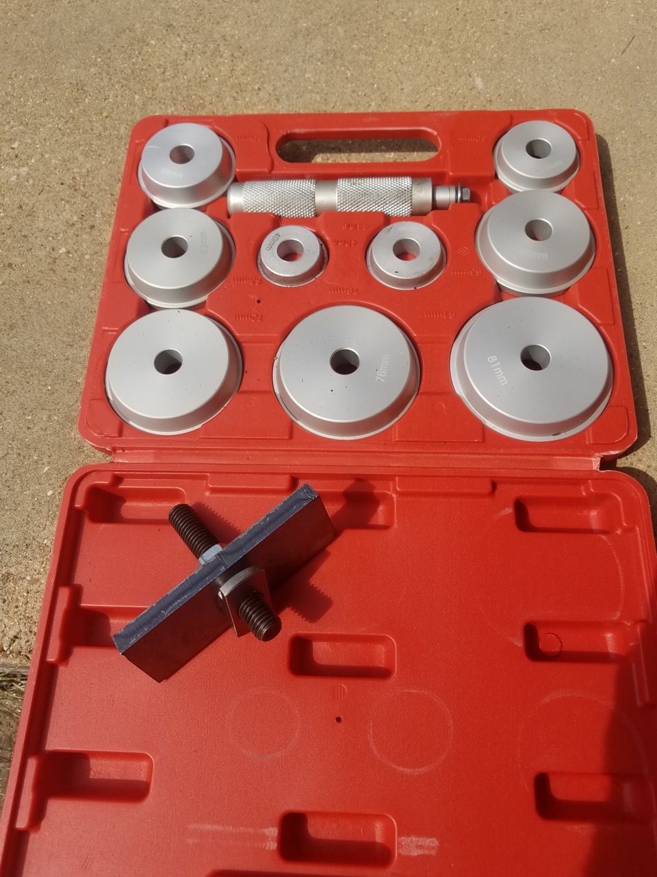

    Just did this job. Fwiw, I didn't need the ECGS tool, the bearing came easy with an AutoZone bearing puller. P/n 648611T. Hardest part was getting the axle seal in without screwing it up. I also destroyed my dust cap, but those are cheap to replace.
