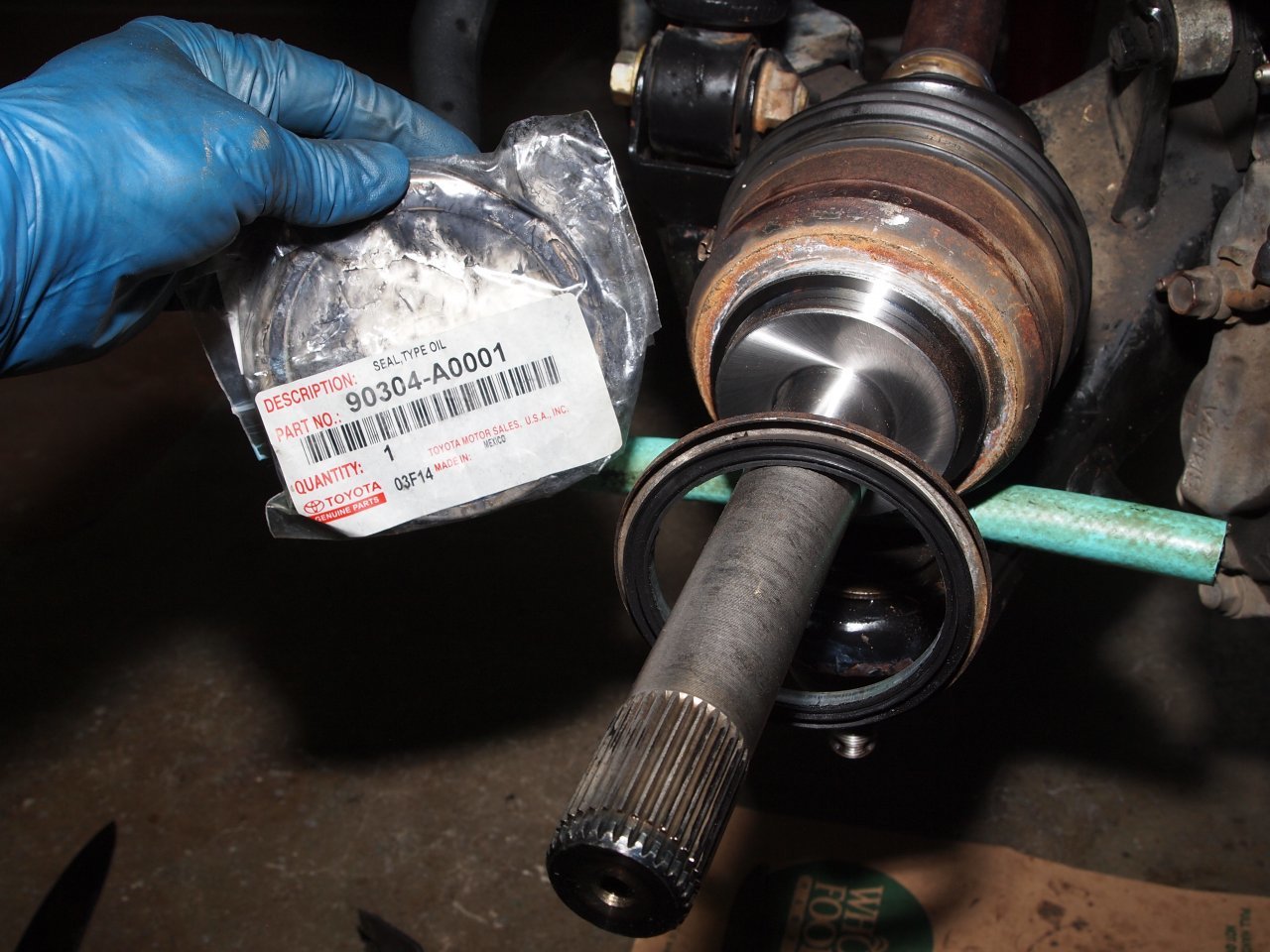

    Why don't people replace the outer CV seal?
    Seems like it sits on the outer CV joint or on the spindle, where the axle connects to it
    to protect from brake dust

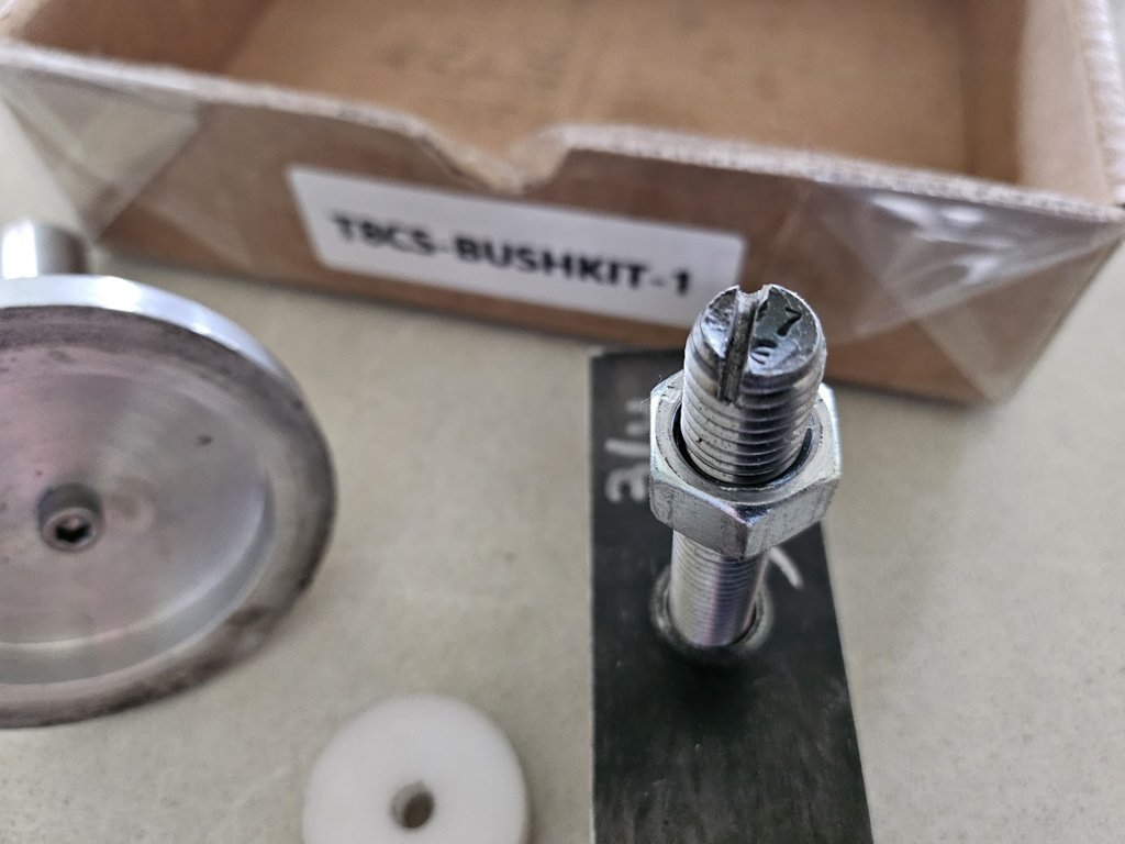

    Completed my needle bearing installation. Thanks to this thread for all the great info. I did modify the bushing removal tool by grinding a small slot in the top of the bolt. This allowed me to use a flathead screwdriver to rotate the bolt while I held the special nut inside the axle housing.
