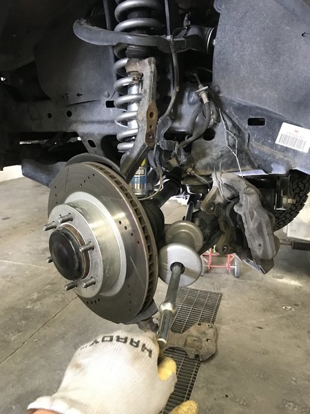

    Feels and sounds like a completely different truck. The blind hole puller from Auto Zone was more than adequate to remove the bearing. I did undo the drivers side of the sway bar to give me room to use the slide hammer for the puller. I also removed the bumpstop to give me room to hammer the bushing.

    Did you use the slide hammer from AutoZone and the CV removal tool as well? I loaned that tool from AutoZone but it's not wide enough to fit around the shaft.

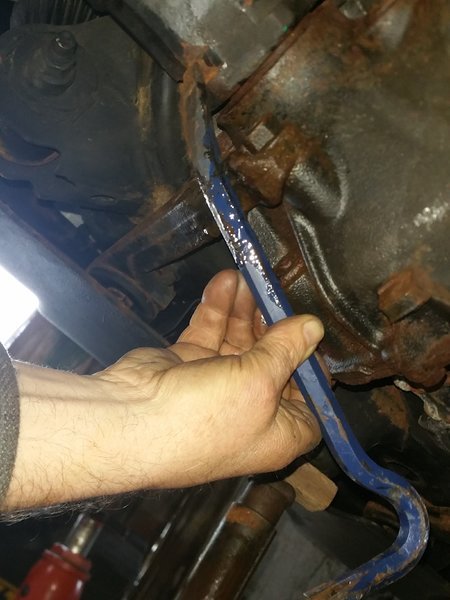

    I used a prybar and a hammer to remove the axle. It was frustrating as I kept rotating and trying to find the sweet spot. I saw a post somewhere which mentioned let off the tension on the axle, tap the metal cup IOT let the clip settle a bit in place, and then try with pry bar and hammer again. Came right out after that. My pawnshop acquired Craftsman 6578 17"ish prybar and a 2 pound mallet worked perfect.

    Just to follow up on this . I did the bushing replacement yesterday. I ended up using a 2' pry bar. Getting a good fulcrum point was critical as was grinding down the pry bar end so that it fit well onto the axle end. I rotated the axle and pried and found a point where the axle seem to move out one step before stopping so I worked that area and got it to come out. Thanks for people's help in this thread.

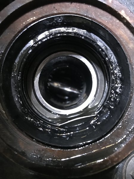

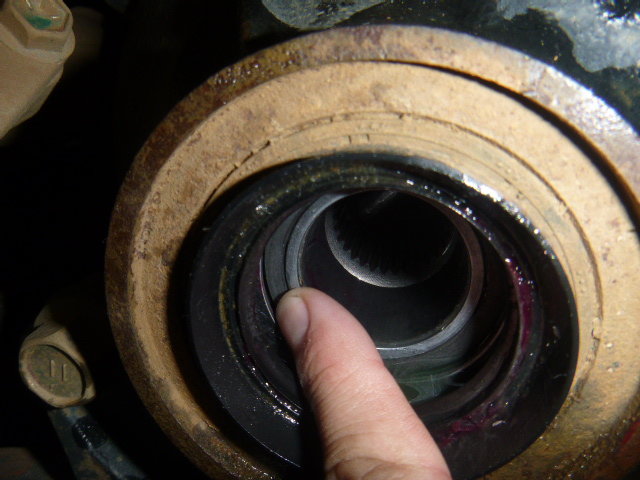

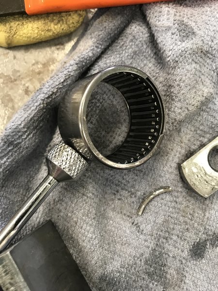

    Use this method today (aka didn't remove the axle from the wheel hub assembly like so many seem to) and all went well. I wasn't able to get the axle out of the diff by just prying it, but a rented slide hammer and some hose clamps did the trick well.
    A few notes: when getting my ECGS puller tool installed, I broke off a sliver from the edge of the needle bearing, so be sure to be attentive to this if you do it.
    Installing the new axle seal was a little tricky, as I wasn't sure how deep to seat it. For confirmation it gets driven in to where the seal face is flush with the surface if the bore it's sliding into.
    Pics for visual help to whomever might want it.

    If you weren't able to recover it, that chunk of the needle bearing would likely be stuck to the drain plug on your next change. I bet I'll find the mysterious missing piece of bearing from mine on there eventually.

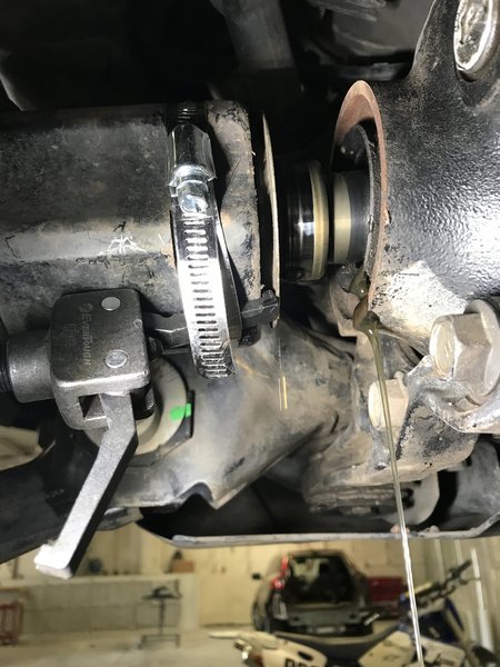

    having a hell of a time getting the ECGS bushing in the last 1/16"-1/8" any tips?

    This is what mine looked like today....it wouldn't go in any further so I said Fu*k it and re-installed the CV. I haven't taken it for a drive yet but everything seems to be back together as it was before the ECGS bushing.
    I'm worried that mine may be in too far (since I hammered it in pretty good) and will contact the spider gears. It felt good in there before I put things back together....fingers crossed for tomorrow.

    Just for follow up if anyone was watching this....
    ECGS got back to me and said that the bearing should sit flush but having it stick out slightly it will still be on the bearing surface of the shaft and if the CV clipped in, all should be ok.
