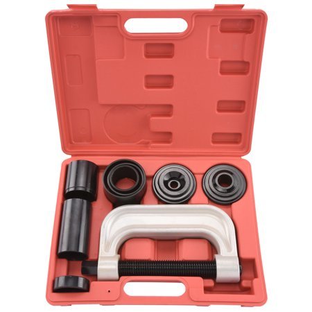

    probably a dumb question, but i’m going to install the bushing tomorrow, what did you guys use to tap it in? i figured a socket that fit around it would work.

    I used different pucks out of a ball joint kit similar to thesea920de46-45e2-4d58-bcf0-27a8680ea018_1.4c67c8e2cee1fb1348b1f0b06c061ca8.jpg
    I then finished it off with a socket once the pucks wouldn't work for me due to their size/depth after driving it further into the differential.
    Whatever you use just make sure you tap it in slowly and keep checking to make sure that it is working properly or not. It took me a while to get it in because I would tap.... then check.... then tap... etc.
    Good luck.

    Oreilly or Autozone rents the drivers

    Finally got mine replaced. The needle bearing was in tact but one of the needles is clearly out of position, and was probably causing the oscillating, cyclical, rhythmic l rumbling vibration I had at 30-40 mph. (intentionally adding words for forum searchers). Thanks for everyone's tips. I used a bearing race driver tool rented from Autozone to install the bushing. I was able to do the swap only disconnecting the two bolts for the ball joint knuckle and I removed the bumpstop with a giant pair of channel-locks for more clearance to tap the bushing in. Beating on the CV axle was not making much progress, but I was able to remove it easily with two prybars placed at about 5 & 9 o'clock. When pulling the old bearing, I did notice the tool was such a tight fit, if I spun the puller nut slowly, the diff would just turn. Quickly spinning the nut would actually make progress pulling it.
