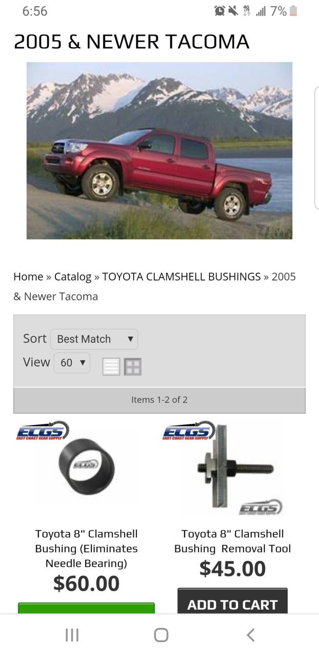

    Sooooo let’s say hypothetically that someone is install camburg uniball upper arms and icon extended travel shocks up front with the over all goal of lifting 1-1.5” . If the truck is all taken apart might as well replace the ecgs bushing yet you didn’t plan ahead and failed to order it online. Any idea where it can be acquired in the sol cal area or if that type of bushing is ubiquitous and can be found at most bearing supply places if the dimensions are known (bronze type bushing with out roller pin bearing correct ?)

    It's pretty niche. Just order it and install later, takes about 1.5 hours, super easy.

    As stated above, just get it from ECGS. If you install it at a later date, the only effort doubled up is the removal of the wheel. You're not really saving anything by installing it at the same time as the suspension.
    It's an easy job. I used the following video.
    https://youtu.be/m9W31KGy6k0

    The company is called ecgs. They ship out very fast. I received mine in 3-4 days.

    If you will talk to ECGS they are very accommodating. Great bunch will probably overnight it for you. Had a small hickup with shipping company, and ECGS got me my bushing the next day so I could make my trip with my new bushing. When I say overnight I mean over night.

    ordered ECGS bushing...
    Although, with 1" of lift there was zero vibration. I suppose you guys are right, not much more extra work to pull it apart again and pop in that new bushing.
