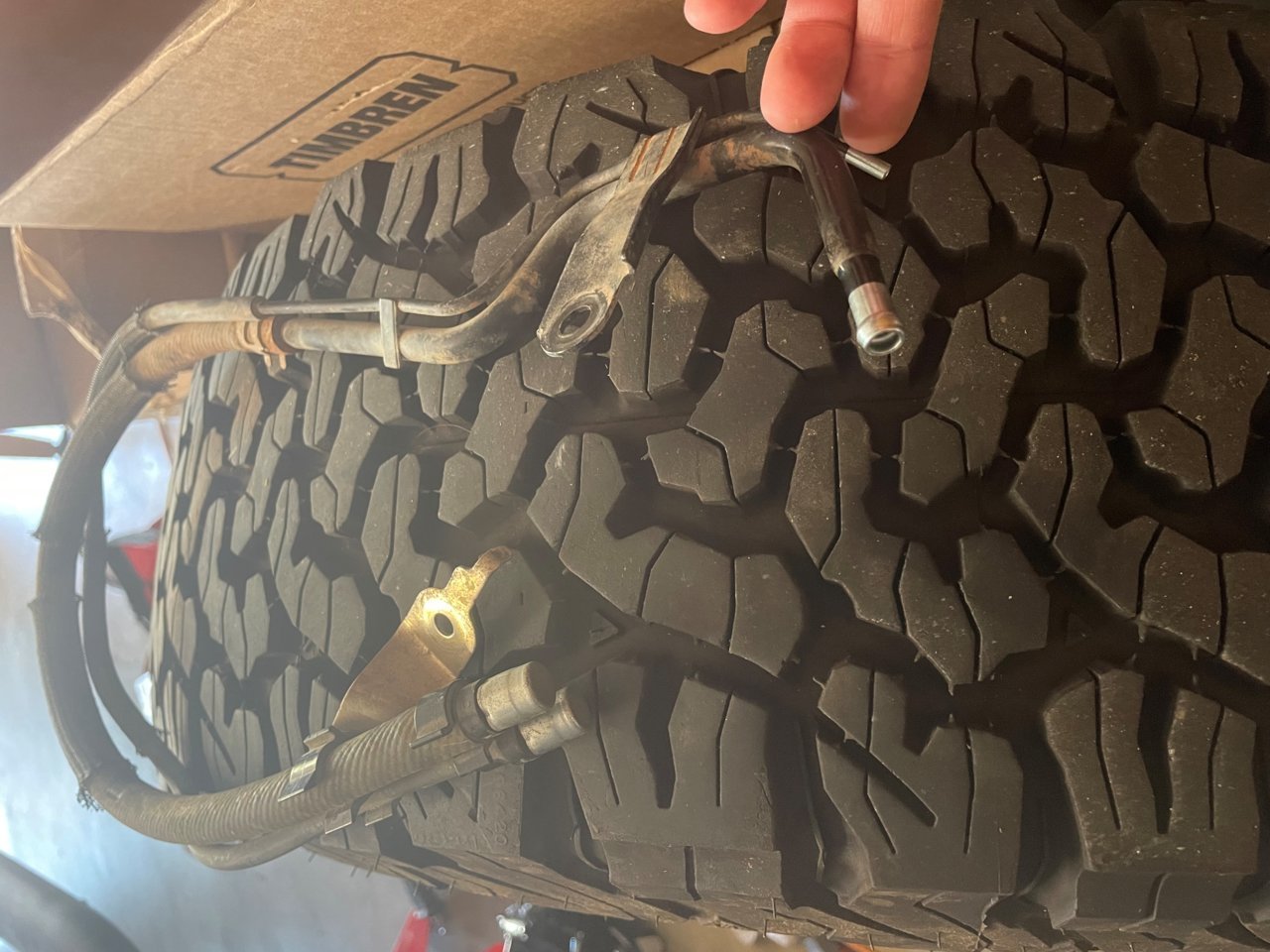

    2.) Q. Where should I disconnect the front diff breather lines?
    A. At removal, I disconnected them at the top of the lines, and threaded them down through the engine bay, leaving them attached to the differential, and being careful not to snag them on anything as the diff lowered. However, when I put the front diff back in, it was impossible to leave the hard breather lines attached to the diff with the bracket while getting the diff back in. The front diff assembly is just too unbalanced and awkward to not bend and damage the hard breather lines when reinstalling the diff. The hard lines were also hitting something and keeping me from being able to rotate the diff and get the rear mounting bracket "hooked" and in place. I unbolted the breather line bracket from the diff and pulled the hard lines out of the flexible lines right at the diff, and basically removed the entire breather line assembly. If I had to do the diff removal over again, I would remove the breather lines again as soon as I could get to them, and reinstall them whenever I had the diff mostly back in place when I could still get to them easily. Photo is of the breather lines, pointing to where it was unhooked.

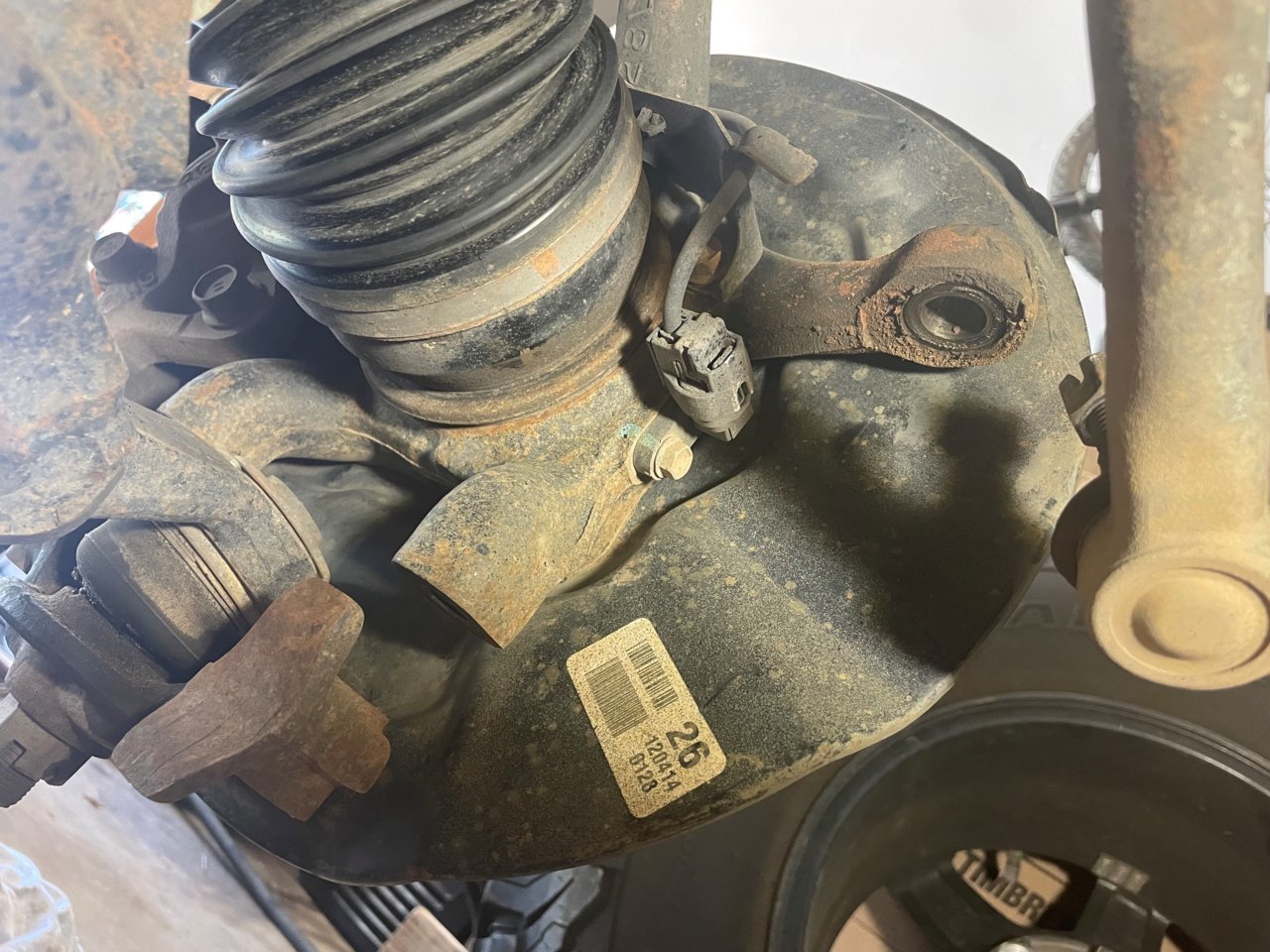

    4.) Q. Do I need to remove the CV's?
    A. Personally I would say No, just unhook the tie rod and the bracket under the lower ball joint so that you have the freedom to pull the wheel hub back. First pop the CV's out of the diff, and then push them away now that the wheel hub assembly can swing out of the way. You can push the CV's out of the way enough to get the diff in and out without removing the CV nut at the wheel hub. They do kind of get in the way while putting the diff back in but it's manageable. *Note: Don't stretch the flexible connection on the CV...I don't know about Tacomas, but you can separate a CV internally. Just grab the ends and push so the whole thing compresses, not the other way around by just yanking on the end of it.
    Photo of the tie rod and ball joint bracket unbolted.
