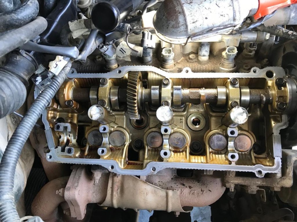

    I have had to do all that MTX and more to my 3.4L Taco myself. How goes it? On the rear main seal, just pull the OEM seal, replace it, and seal in place with something akin to UltraBlack and you should be fine. If you have time, check your valve lash while you have the covers off to assure best breathing.
